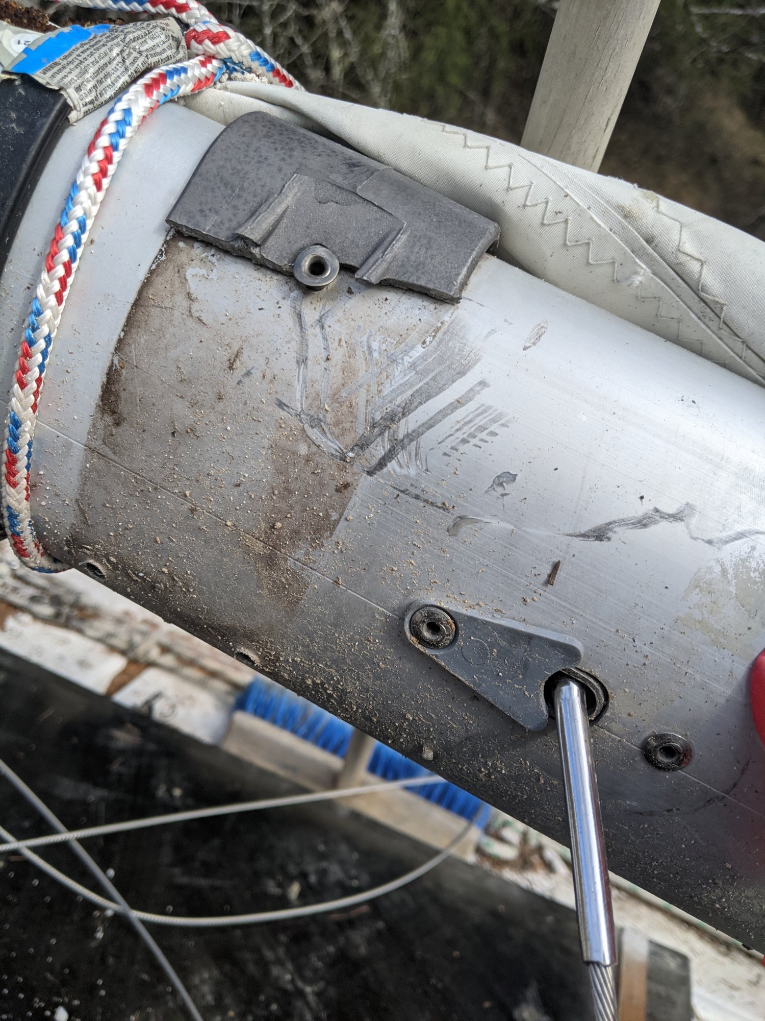

The spreader on my Hunter 260 broke when my garage collapsed on it this winter due to snow. I ordered a new one, but I wonder how I am going to get it on the mast. Do I have to slide it on from the top or bottom and thus remove all the items on the mast that get in the way when I slide it down or can I slip it on (by spreading it carefully) right were it needs to go?
Thanks
Fred
12,771
You can spread it open. Attache the spreaders to the brackets and then use them as levers to widen it just a smidge and snap it on.

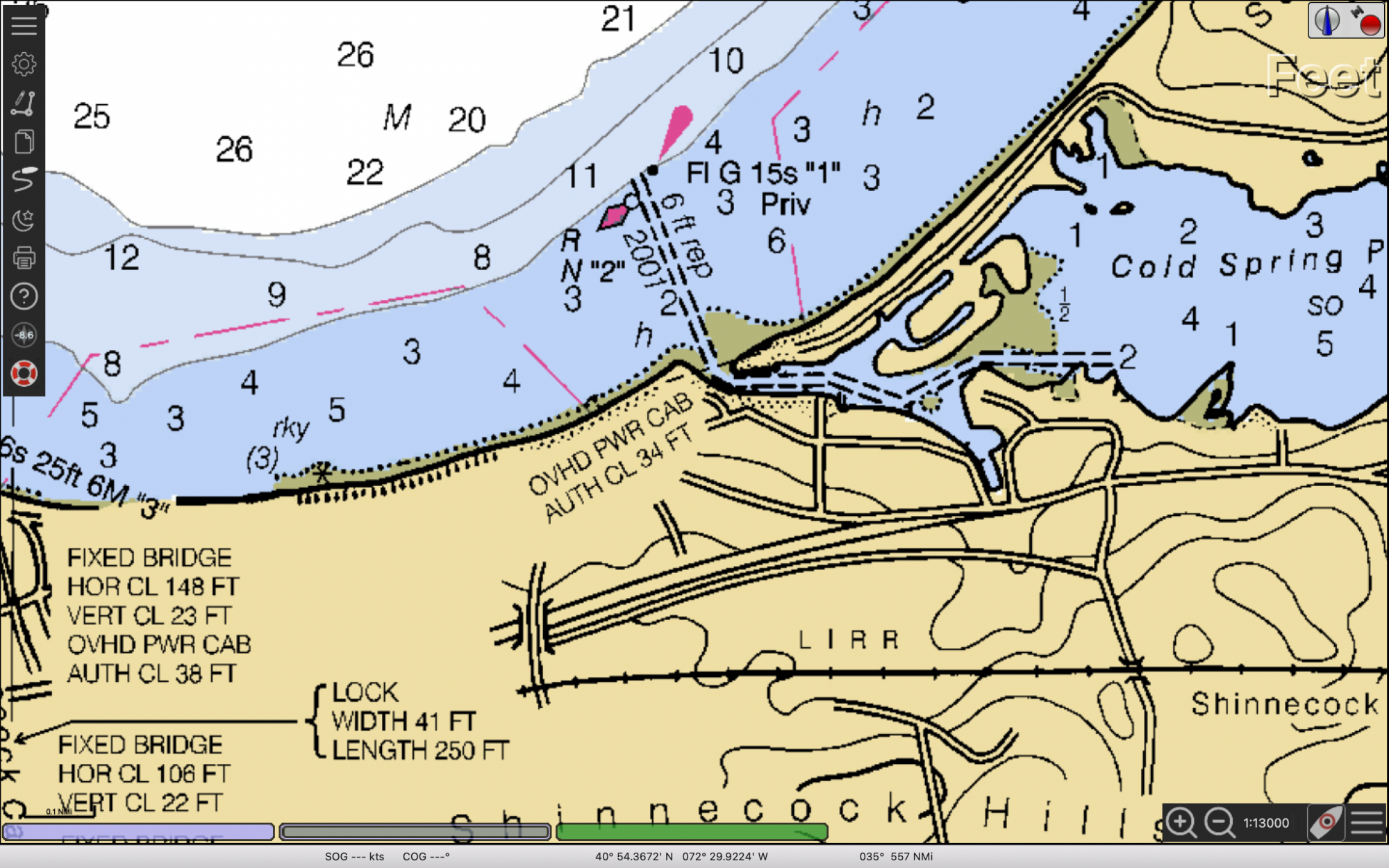

This screen shot from Chart of Peconic Bay. Note the power cable across the Cold Spring Pond Inlet. I've sailed in and out of there in my Bandit 15. Its mast was less than 25'. You can't be too careful about power
cables. They can be in unexpected places.
Thanks for the advice I will give it a try and let you know
12,771
It has been four years but if I remember right, I got it wedged on the mast and then tapped it with a rubber mallet to get it to "pop" on.
