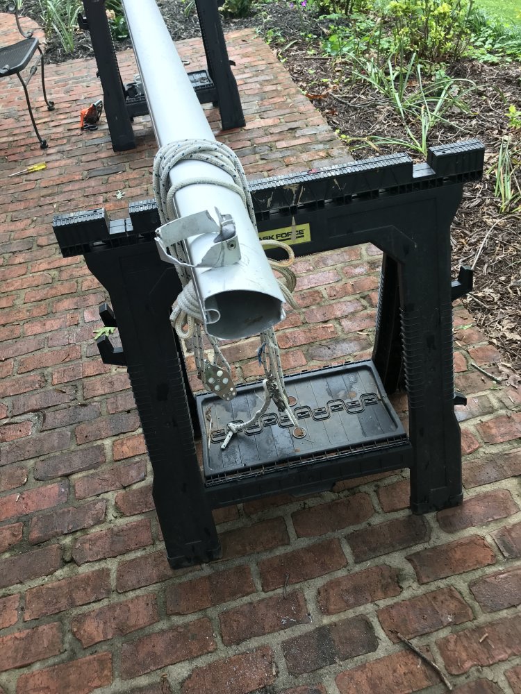

Its very interesting to me that a piece of the rigging failed before the spar did. And that you didn't feel it enough to stop. When you see a mast hit things like bridges the boat pops a wheelie before the mast breaks, normally at the spreaders. Can you post a pic of the failed part??

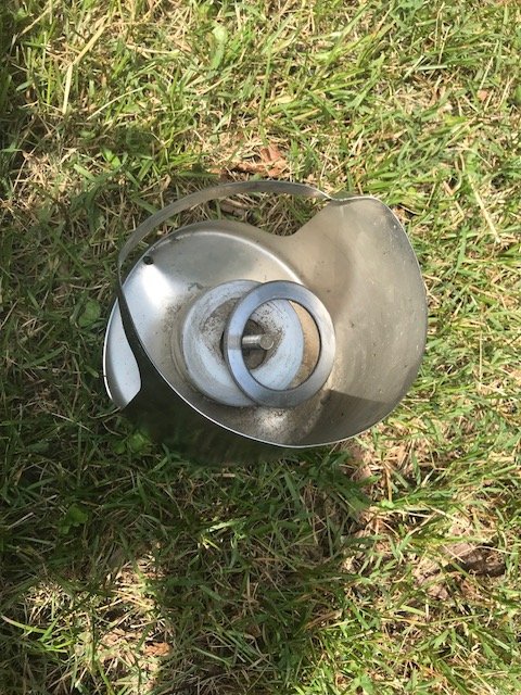

13,019

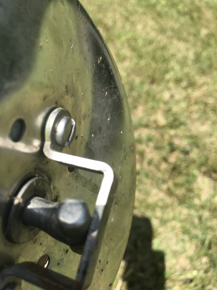

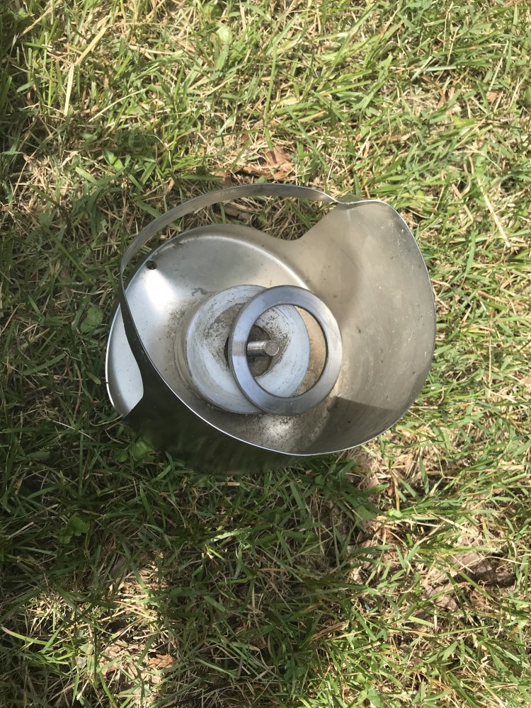

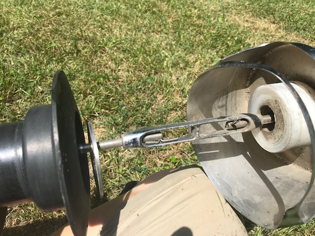

@Jackdaw
Here is a pic
The ears that go around this T and are pintled to the bow chainplate failed . There was an extender that might have contributed. I don’t know the exact name of the extended but you see them all the time on the shrouds of smaller boats instead of turnbuckles.

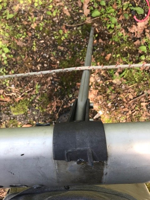

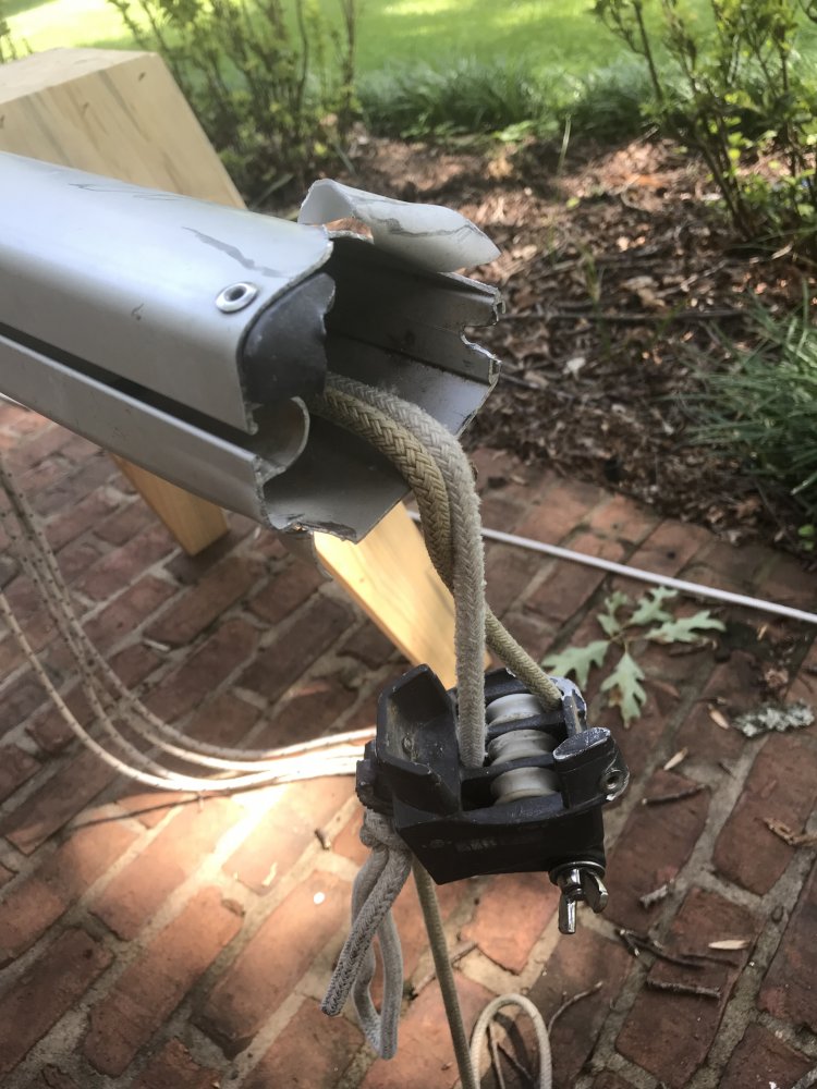

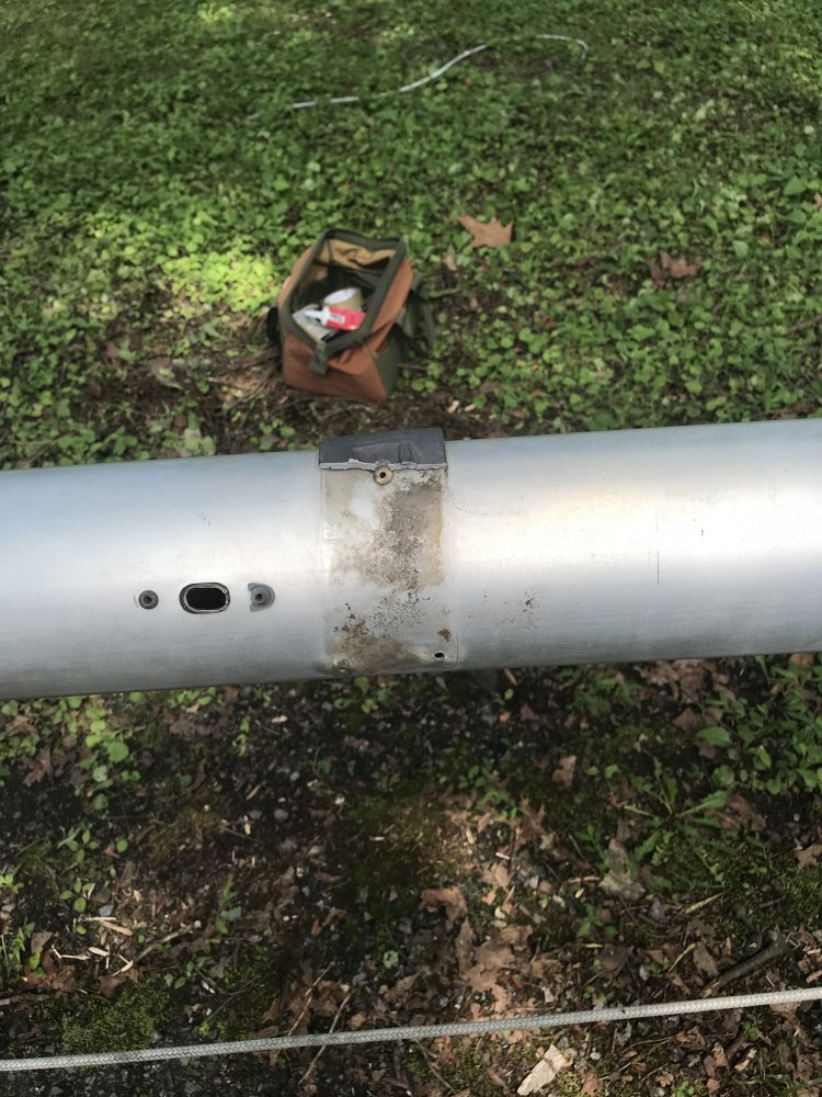

Here are some more pics
FDL S2
Jun 29, 2014
485
S2 7.3 Fond du Lac
Looking at the pictures, I'm guessing that you hit the overhead line with very top of the mast, it landed on the spreader and pulled the furler apart?
Likes: rgranger
13,019
That would make sense. I think the goose neck on the boom took it hard due to the Vang attachment. The line on my Vang is a mess

That would make sense. I think the goose neck on the boom took it hard due to the bang attachment. The line on my Vang is a mess
That sounds right. I'm always amazed at the stress these parts will take under sail, but then odd, non sailing stress will tear them apart.
