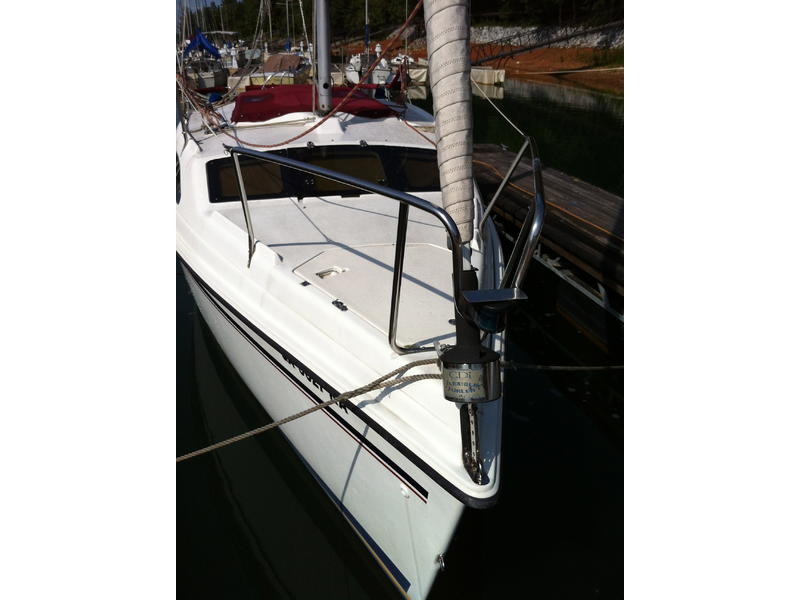

@rgranger most guys in the rail making business can straighten the bimini tubes. But you may find new ones are nearly as cheap.
Be sure to inspect the furler extensions. They can get kinked in this type of accident and stop your sail raising.

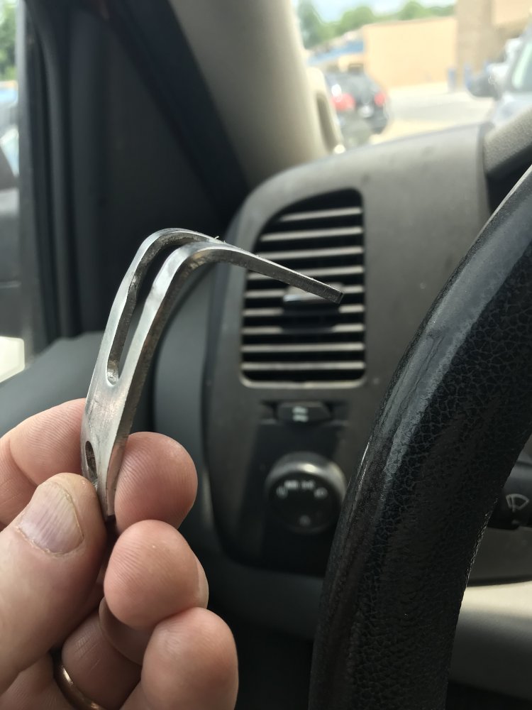

Agreed. That was the weak point. (though it seems likely that it saved the rig from more severe damage)
@Jackdaw initial comment got me wondering, so I went and inspected the toggle on my CDI furler.
Yea that's what I wanted to see a picture of. I'm assuming it was at near-failure condition before this happened.
Likes: rgranger
24,649
Looks bent open not broken.

It looks like it was not pinned correctly, and the force pulled it open. Does the hole on the other side look OK?

Pretty sad to think that such a small mishap can total a boat. Really makes me put even more thought into something as routine as my launch and retrieve procedure. There are so few sailboats that launch and retrieve where I’m at, most of the way down the ramp I look up at the trees not down at the road (and I take out a branch or two every time) and I have to swing my truck off the pavement and into the dirt just to clear the mast head. I’m glad it was a relatively easy fix
With you here Jack. rgranger what type of pin were you using? Maybe a quick release which many people use or a bolt or a clevis that was 1/2" too long. rgranger you've come this far let us know about the pin. I know something had to give but a headstay scares me especially on a fractional rig where the mast should have bent first.

It was a clevis pin. Possibly too long. I can’t check. The pin is probably sitting in the gravel at the launch site.

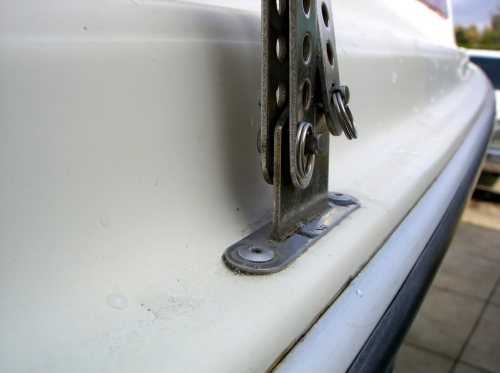

I found some pictures online to show how the mast was pinned to the bow. The mast was pinned to the U-bolt at the bow using one of these adjuster (see pic)
It looked similar to this pic
Nov 8, 2010
11,386
OK. The bent toggle was pinned to the two plates that attached to the bow ring. Gotcha. That toggle will lift your boat out of the water if pinned correctly. Open however, it will straighten up rather quickly as you found out. Strangely, it probably saved your mast!
