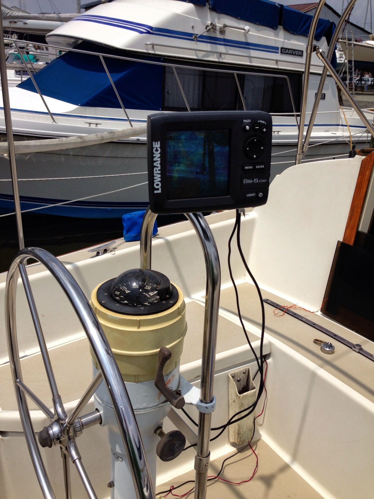

We had an O’Day 28 for many years with just traditional depth and speed instruments. When we moved it to unfamiliar waters we added a low cost Lowrance GPS. That had a transom mount transducer we were able to mount inside the hull as a second depth source.
(forgive the messy wiring; I subsequently cleaned that up).

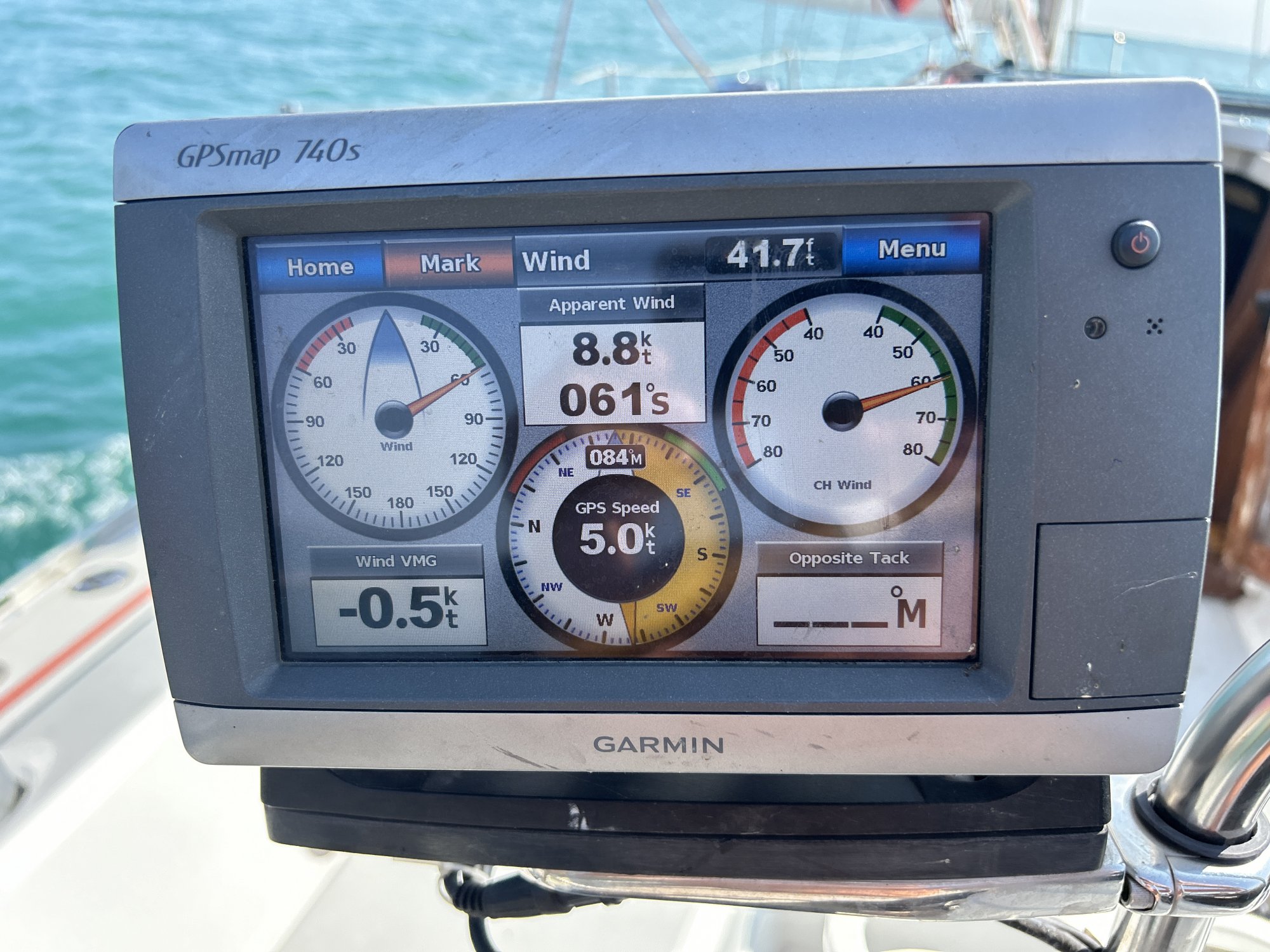

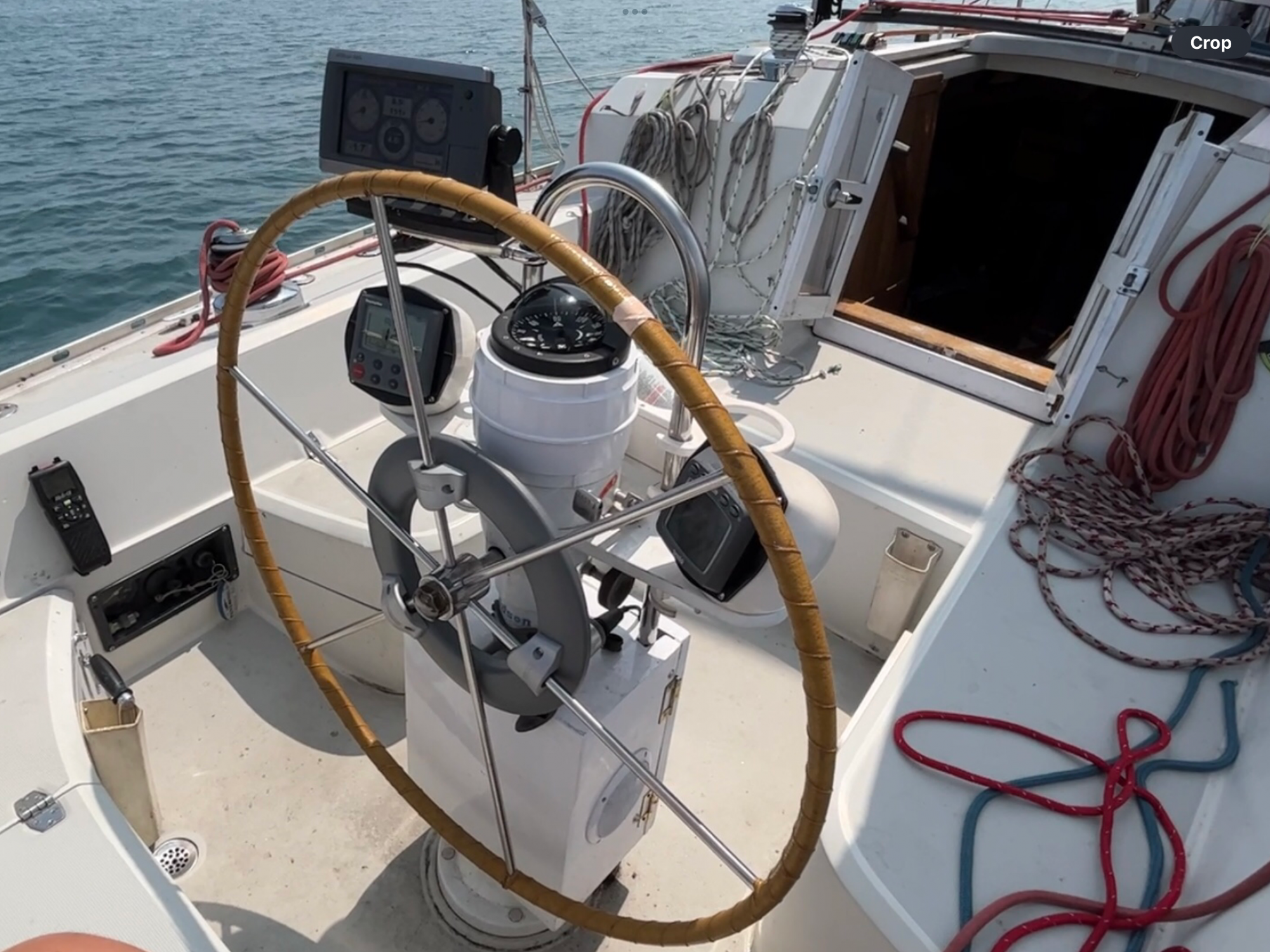

For me, I would want a wind instrument, which can be displayed on a separate display or on a chart plotter. And I would want a chart plotter with depth and speed transducers. Lastly, an auto-pilot.
On my boat, I have a Tack Tic wireless wind transducer on the mast, and it has its own dedicated display at the helm. I was able to network it with my Garmin GPS740 Chartplotter, so I can get wind info on the CP. The CP provides location, speed over ground (via GPS) and depth. In addition, I bought a new VHF radio that has built-in AIS. So by networking it to the CP, I can get AIS targets, alarms, etc.on my CP.
Here is my helm set up…
Overall view, with Chart plotter, auto-pilot control head on left, dedicated wind display on right.

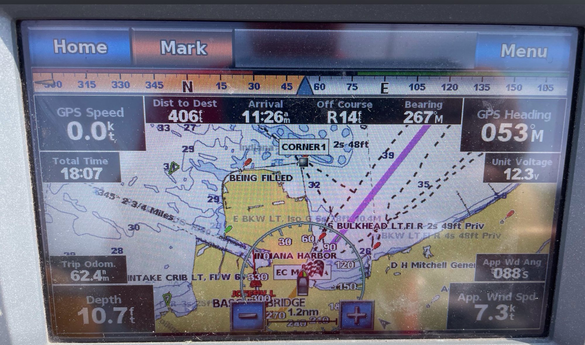

When sailing, this is the screen I use the most…provides a lot of info in a glance.
I set up the customizable nav screen to show the things I wanted to see, like wind angle and speed, battery voltage, depth, boat speed, etc.
