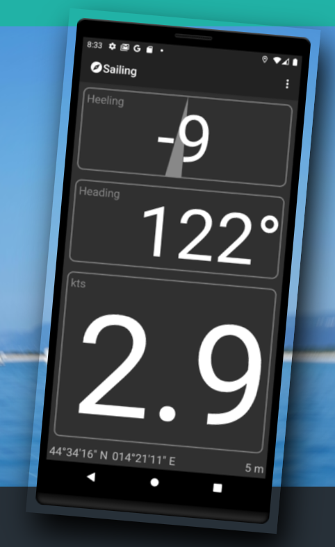

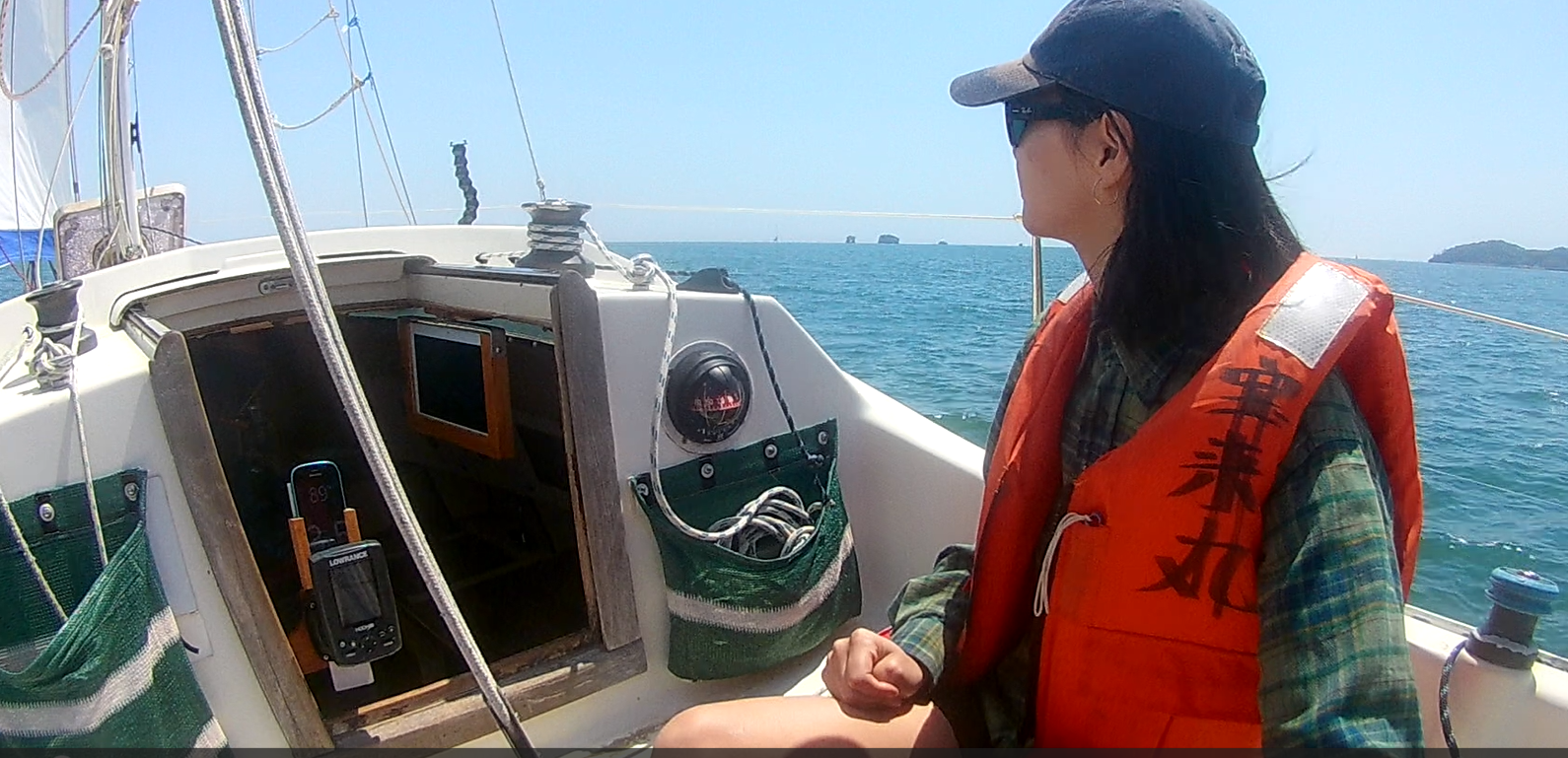

In the photo you can see an ancient phone with Boatspeed app. A fishfinder and a tablet.
Boatspeed gives my speed in Big font along with my heading , position , night lighting. vocal read outs of the speed, maps. vocal countdown to start. planner and a lot more. (free)

Below that is a Hummingbird fishfinder as recommended by JBP-BA (#2) and beside that is a $100 tablet with Navionics that I can swing out or stow away.
