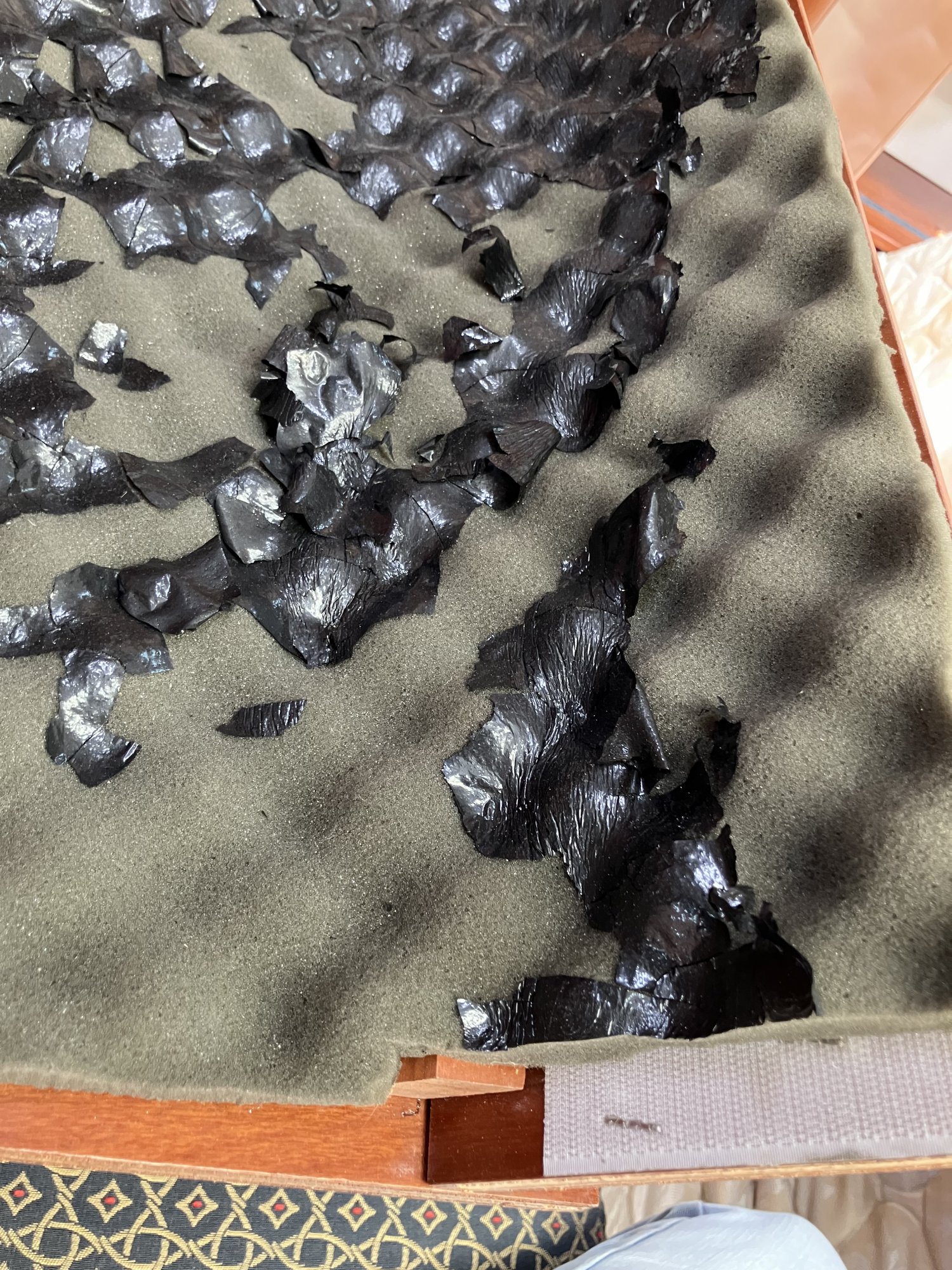

Just bought a roll tonight to use as an undelayemnt for the new vinyl wall covering that's going in tomorrow in the berths. The black foam backed vinyl fell down when the foam turned to powder...fun.
I love the idea of solving the engine room issue as well..I may need more. We will post pics once complete.

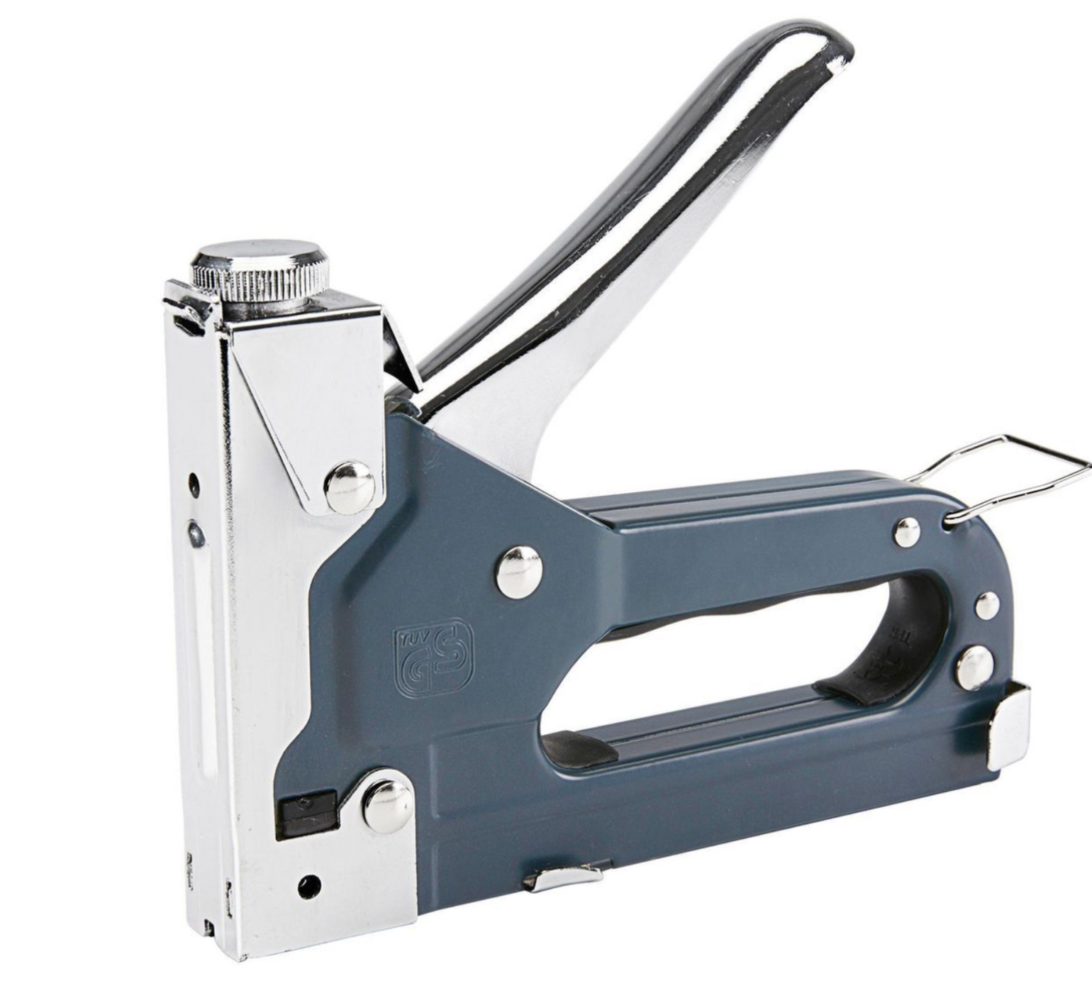

I used a large stapler in most places. I also used an aluminum tape to “seal” edges.
This kind of stapler, not a desk stapler...
I think that the buttons with the nail in the middle would go too deep. Most of the panels are pretty thin.
