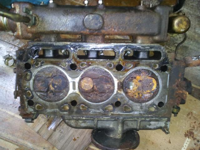

Here is the bottom of the head. I have penetrating oil on it now too![/quote
Bill knows what he is talking about, he has either done a few rebuilds, or he reads a lot. I would go with what he says. Those pistons dont look too bad, the water galleries look ok, but one thing confuses me, from the photo, all three pistons look to be at top dead center at the one time, I looked at the photo several times, and thought, that just cant be right, maybe i cant see it right, but their is no way all three pistons should be top dead, at the same time.
If you decided to rebuild, do as bill says, clean evrything, then oil everthing before you put it back together, put everything back in the place it came from, mark each bolt (its the way rolls royce do it every bolt goes back in the same place) mark each bearing, and never interchange big end bearings, never interchange pistons or con rods, if you put it back toghther, and nothing is broken, and its clean and lubed, it will run.
I have worked on them before when you get the last piston out, and the cylinder and piston is torn up, or where alloy heads are burned throgh, (thats a cast head you wont have that problem) even seen alloy pistons, burned right through, but if you dont have any damage, just clean it, put it back together new piston rings, and big end bearings, its a new engine.
Oct 24, 2011
258
Lancer 28 Grand Lake
what was i saying, the photo wasnt the pistons, it was the valves, they look ok just a little coked up, rotary wire brush, then re grind the valves.

For example - the photos show head gasket failed between cyl 1 and 2. He has no valve spring compresser and even if he got hold of one - no tooling to grind/reface the valves/seats.

I cant understand the photo of your engine, because on a three cylinder, one piston should be at the top of its stroke on combustion, the other two pistons should be at the bottom of their stroke, one about to rise on combustion, and one about to rise on exhaust. A four stroke engine works on four strokes, first stroke, induction, a downward stroke of one piston, then compression, an upward stroke of same piston, then power, a downward stroke of same piston, then exhaust, and upward stroke of same piston, induction compression power exhaust, most three cylinders, cycle with two pistons at the bottom of their stroke, and one at the top, yours has one at the top, one half way, and one at the bottom, that just dosent seem right, one piston should be top on exhaust stroke, one on top on compression stroke, and one at bottom on power stroke, followed by one piston going down on power stroke, one piston going down on induction stroke, and one coming up on compression stroke, position of pistons just dosent look right, but i am no expert on three cylinder engines.
Sep 7, 2011
279
Hunter 1980 37c Illinois
Not sure either... Maybe I will have it pulled soon! I hope it isnt fubar.
