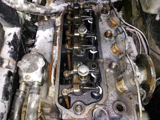

I got up there today and got the valve cover taken off. Rockers were
clean and oily and looked pretty good. Got the head loose but did not have a wrench to get exhaust manifold off. Antifreeze leaked out and it was very clean. Need to get the oil plug off.

not to discourage, but those pushrods look quite rusty. Proceed but be skeptical of what lies out of sight
Jun 6, 2006
6,990
Along with the pushrods the general exterior looks like it has seen a lot of salt water action over the years. May not be anything as salt water on the outside is pretty much a given on marine engines but it is an indicator of previous maintenance schedules.
The inside does look like just oil is getting to the head with no glop emulsified water-oil deposits. The fact that you are getting oil to the valve train but the push rods are rusted may not be an issue though. If memory serves the tappet does not have an oil passage and so the push rod does not get "pressure" oiled, it only get splashes or dripping from the valve rocker journals. Not a crisis but not what you would like to see either. I'm thinking the oil pressure has been low for some time....... which would lead me to suspect a lack of oil in other places as well..... like the rings or (somewhat less likely as they have a dedicated oil passage) the crank and cam journals.
Pretty much have to continue in any case, keep the pics coming so we can help.
