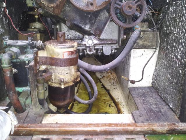

engine is seized up

Before you take the engine out, try turning it in reverse, you can usually put a couple of bolts into the front wheel of the engine, then put a bar in it, and see if the engine goes back the way, you should also undo all the tappets, and see the push rods are free, because with the rust on those push rods, you could find the cam followers are seized, if the engine moves a little bit in reverse, it will tell you its not the pistons, or bearings, then disconect the cam chain, and see if the engine goes, you could do that, before you take the engine out.

The engine will be pulled regardless. It is a matter of how much rebuild will need to be done. I still feel resleeving is cheaper than repowering. I am interested in the condition of the cylinder walls- will find out pretty soon.

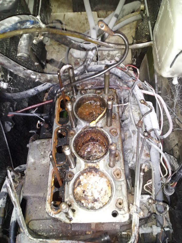

Results are in the cylinders were full of a rusty powdery crap...
OPTIONS?

This may not be as bad as it looks. You have pretty good access to the engine and if there is enough to get the oil pan off without removing the engine you can fix this yourself.
Prerequisites:
Have to get the oil pan off to gain access to the connecting rod bolts.
have to get the pistons out.
have to be able to inspect the crank journals for damage.
Do you think you have that kind of clearance?
The repair is pretty simple BTW
Order a complete set of new rings
Purchase a cylinder hone (your auto supply store will have one)
Remove the pistons being sure to note which cylinder and orientation the connecting rods/pistons so you can get them back in the right journals.
Hone the cylinders to the requires "cross scratch" pattern, you may want to pre-clean them with 600 grit paper by hand but be careful 600 grit scratches are very hard to hone out.
Inspect and clean the pistons and remove the old rings
Don’t forget the oil passageways and be sure they are VERY clean before install
Install the new rings then install the pistons in the cylinders
Lube the pistons with motor oil a light coat does fine
Hand crank the motor to spread the oil around the cylinders
Cleanliness is next to Godliness and is an absolute requirement when working with grit and bearings. EVERYTHING must be free of grit BEFORE you begin the reinstall. Think surgical clean and you will be fine.
BTW, I’ve fixed worse and how do the valves look?

I agree with Bill.. Get as much of the rust/powder out before ya try to move the pistons Small wire brush in the bore and a vacuum to clean it out.. Then some pb Blaster on the gap between piston and cylinder.. let that sit a while (a few days with re-application) then, ya can take a piece of 2X4 and bump the pistons to loosen. Make sure ya have the rust cleaned out pretty well or the pistons can be damaged . Pulling the rod caps is a plus here too .. You may be able to do this with the engine installed, but the work would go much faster with the engine on a bench. Good luck !

Now that I slept on it several hours-
I can rig up the engine and pull the engine into the salon of the boat ( the whole salon is going to be a "gut" job anyway and refurbish it there- and put it back!
I guess if I were in the South Pacific this is how I would do it.
I have some world class penetrating oil as well- from the refinery.
This is provided that I get the pistons to move like recomended!
I am going up there and doing this right now and let it sit overnight or more.
I will take some pics of the head valves up there too.
GREAT IDEAS!
Rick

That's the spirit rblevens!!!!! You can do it!!! I like the way you think. We are going to be keeping our eye on you, you have the potential to be a VERY salty sailor.
I've only seen one engine that could not be rebuilt. It had a several .50 cal bullets through the block
If you are going to pull the engine then give it the full Monty, new rings, hone job, new bearings. Everything else is just a clean up and gasket replacement operation. I'm thinking $500 max to get a "good as new" engine.
this begs the question, what made it seize up in the first place? Water through the exhaust would show up in a single (possibly 2) cylinders but all yours had problems. Sleep on it and let that salty sailor subconscious mind work on the problem. We have time to consider things before we are at the reassemble stage and have to actually be brilliant.
