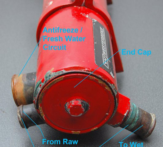

Next remove the end cap from the heat exchanger. How does the easily accessible end look. If it's not good take off the other side and put a light there. If you can't see light get a small metal rod and push it through each hole. I use a 22 rifle cleaning rod with the T handle. Change the zinc and put everything back together.

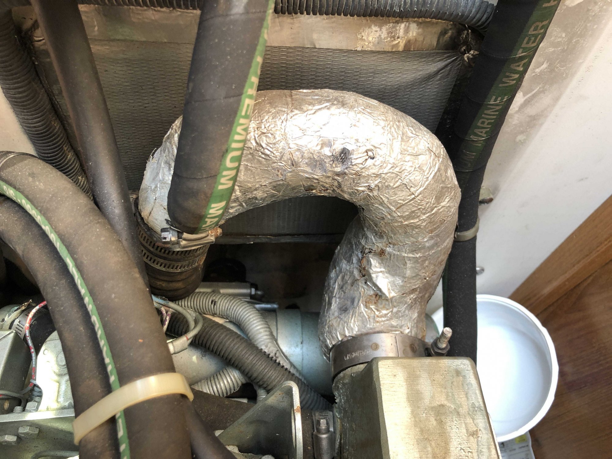

Lastly if nothing has worked yet, remove the exhaust mixing elbow and inspect it. It could be clogged with carbon build up. You might have to clean it out or even get a new one (I make my own from threaded pipe).

I opened up both ends of the heat exchanger. There is no way a .22 cleaning rod is going into those holes. I put on a .22 brush and pushed it in a hole. Turns out the rod diameter is larger than the hole. The brush was not at all interested in coming out. I had to resort to a hammer on the T-handle. Dangerous as the rod, or brush could have broken off. I ran a bent coat hanger through the holes (lots and lots of holes). They appeared clear.
However, where the hose from the water pump entered the heat exchanger there was a whitish hard substance that I first took for an epoxy plug. Possibly is was calcium. It was plugging the hole through the fitting to which the hose was connected. This may be a product of corrosion. It shouldn't as I'm religious about checking the heat exchanger Zink each month, and replace it every 90 days no matter what. It took a while to dig through this stuff. It was hard, but would scrape off into a powder. I was finally able to force the bent coat hangar into the heat exchanger, through the fitting and into the hose about 4 inches. It took many repetitions to clear. I believe there remains a restriction. (The fitting is on the bottom of heat exchanger on the port side of the boat, meaning little/no access).

I looked at the exhaust mixing elbow but didn't disconnect it, again for fear of breaking something. In my experience, the hoses do not like being removed. It will be cleaned when the heat exchanger is replaced.

That white stuff is most likely calcium.
You probably should pull the HX and either have it cleaned or clean it yourself (or get a new one if necessary).
It may be contraversial but I have soaked mine in dilute muratic acid to loosen / remove some of the excess buildup.
I use a wooden dowell to gently ream each tube. A coat hanger could poke through.
