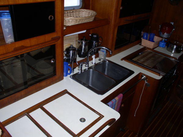

The money goes to the galley cabinetry for the most part see pic.
I believe the boxes require a complete rebuild, not just a few cans of foam; the boxes are so outdated. With 2 sets of plates already in the boxes, space is pretty much reduced as well.
