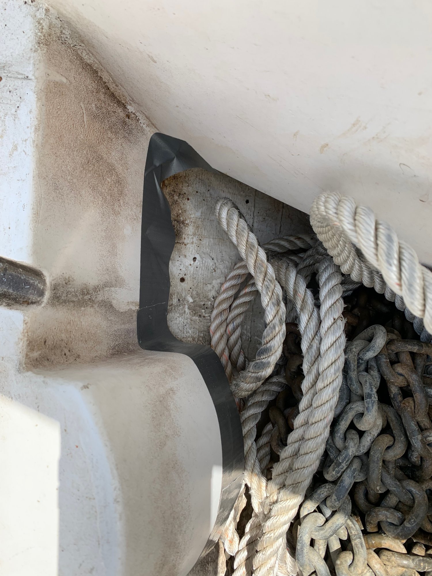

Hey. Just having responded to your response in that other thread (Epoxy questions) :), I'll respond to your response in this one. I actually did something similar: I put some duct tape along the "drip edge" where the edge of the molded deck ends, to keep the rain water away from the leaky area.
Hey: I'm not proud of it, but it has kept things from further deteriorating until I can get to a more permanent fix.
Excellent! Even though I know it's shameful to use duct tape, I'm reminded that it's an essential engineering tool.

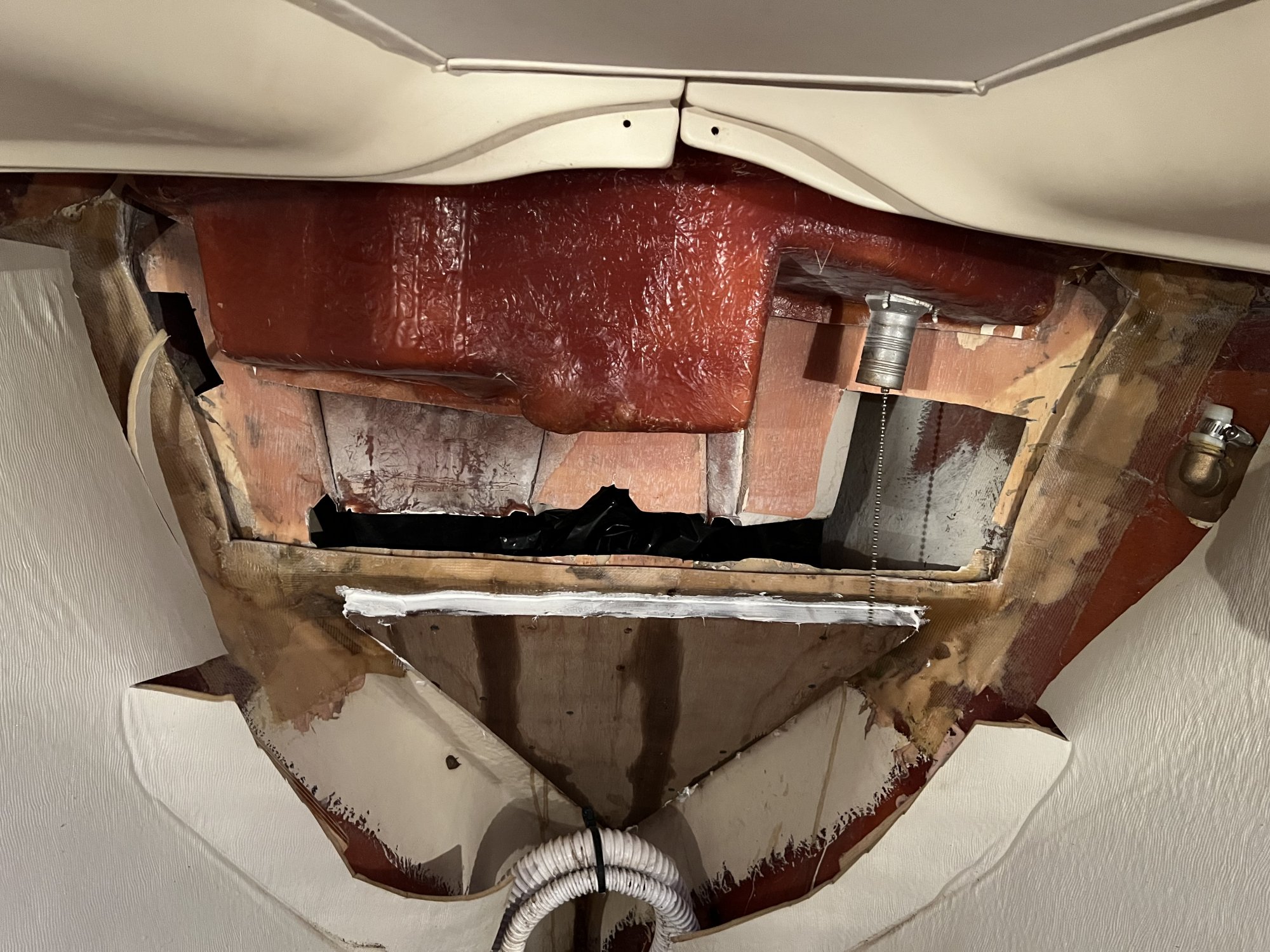

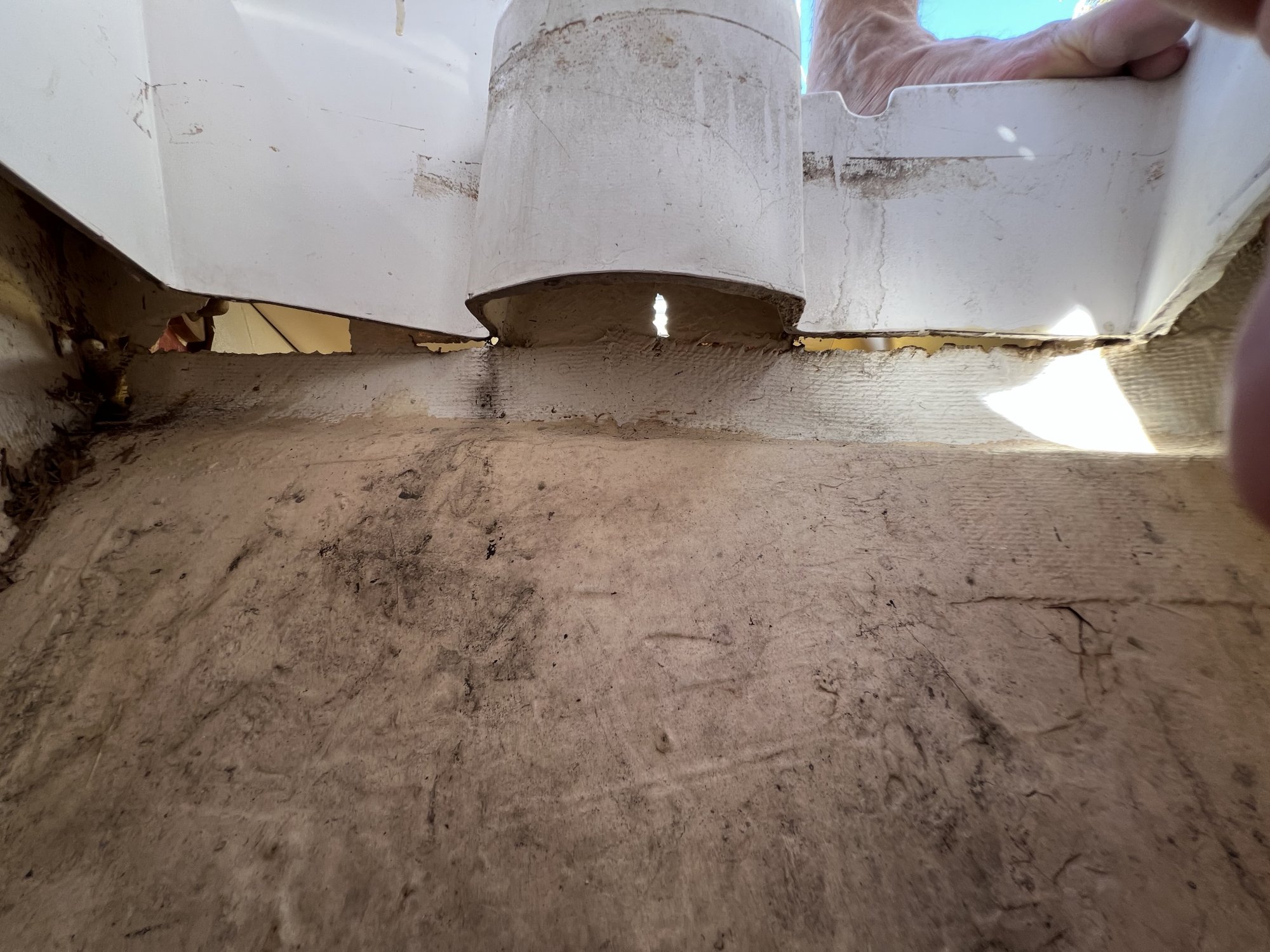

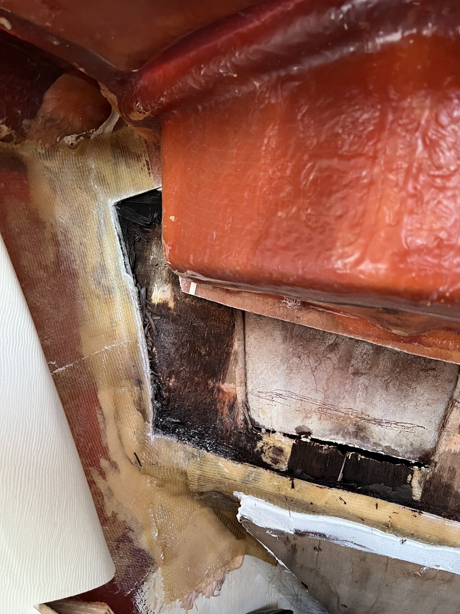

2 years later and I’m finally knocking this thing out. I’ve decided that the whole problem is a combination of questionable windlass platform design and poor fiberglass layup.
I initially hoped to be able to fix the thin crack of the wall that was clearly damaged, but found the entire back wall to be thoroughly wet and rotten. Ugh.
I’ve got most of the demolition completed and a rough template made and will plan on going overboard with extra fiberglass reinforcement. The front of the wall will be tricky because my boat yoga certification is out of date.
