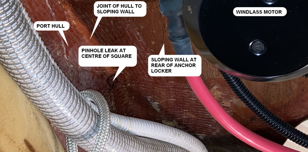

If you check post #6 in the above link, you'll see the above point of ingress into the V-berth. Fortunately, the leakage is limited to the rainy winter but it can reappear in a rainy June. For the sake of safety, once I prepare for summer sailing, I tape a small sheet of poly over the pinhole and lead it down into the sail storage area beneath the mattress deck.
I have been so tempted over the two decades to just seal the hole on the inside of the V-berth and be done with it. Undoubtedly that would lead to bigger problems.

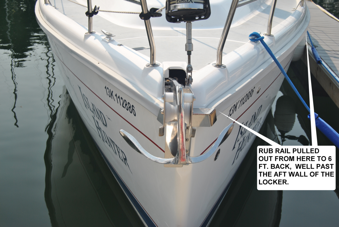

On one hell of a hot day in the August of 2012, I slowly pulled out the rub rail from the deck/hull flange. Actually, not too bad a job.

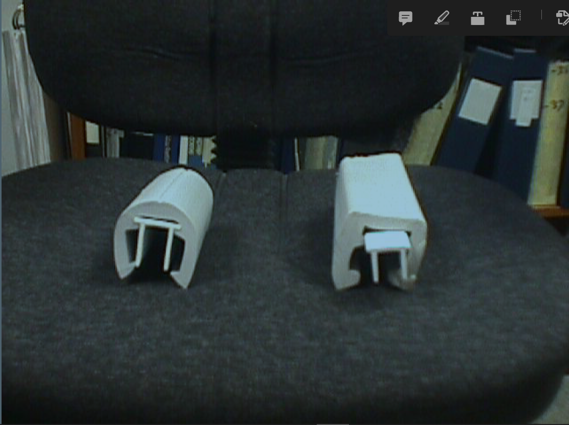

The rub rail remained attached at the bow under the anchor mount. Next, filled the rub rail with white DC 795. Good enough for grouting around windows, good enough for filling rub rails. This is the interior of the rub rail circa1998. My model is on the left.
Pressing the rub rail back into position was another story. The sealant became compressed between the interior vinyl piece and the inner surface of the rub rail. It took the right hand of God to press it tightly back into place.
Once that was done, the very next winter ................................. it didn't affect the leak one bloody iota.

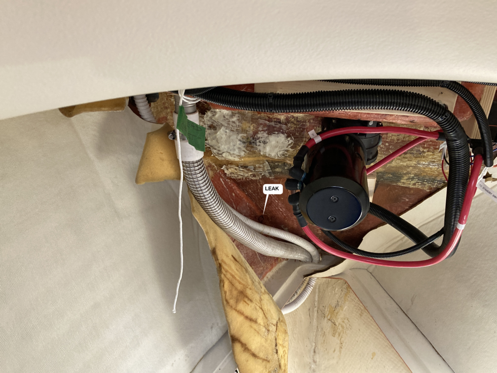

Mar 27, 2021
180
Hunter 306 Lake Pepin

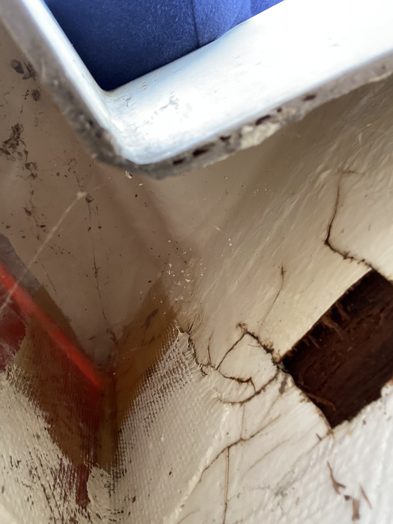

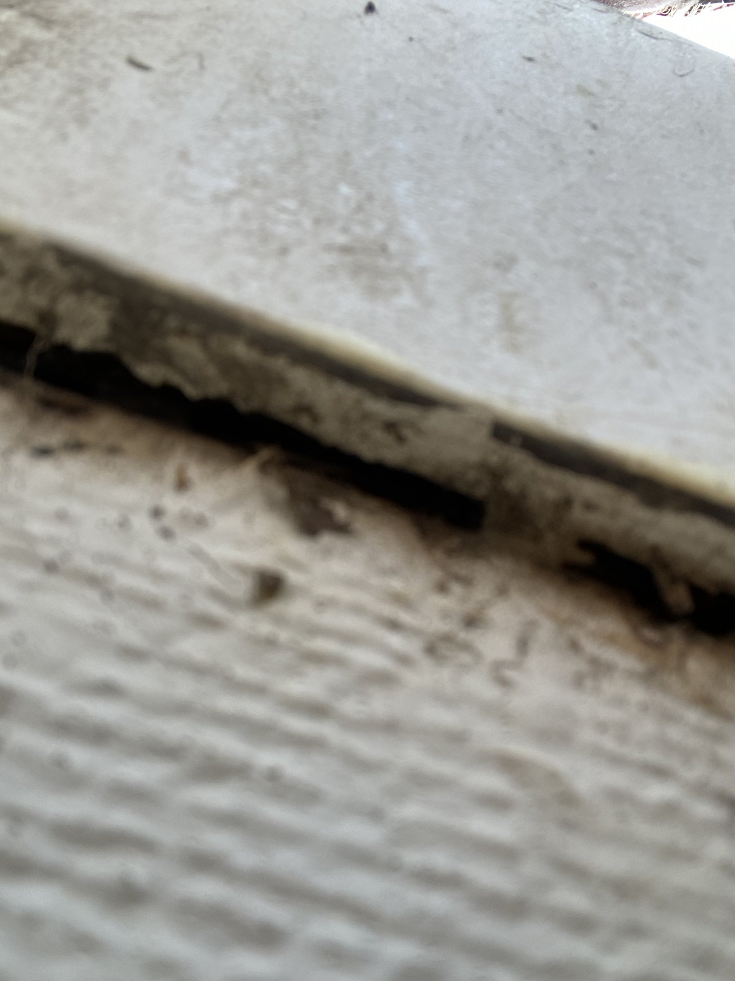

Here are a few shots from the aft lip/wall of my anchor locker. You can see a sizable square of wet, delaminated wood in the first shot. Oh, bother. The second pic shows a joint that’s just begging for some sealant. I’m not quite sure yet what/how I’ll fix it, but it seems to be a recurring issue.

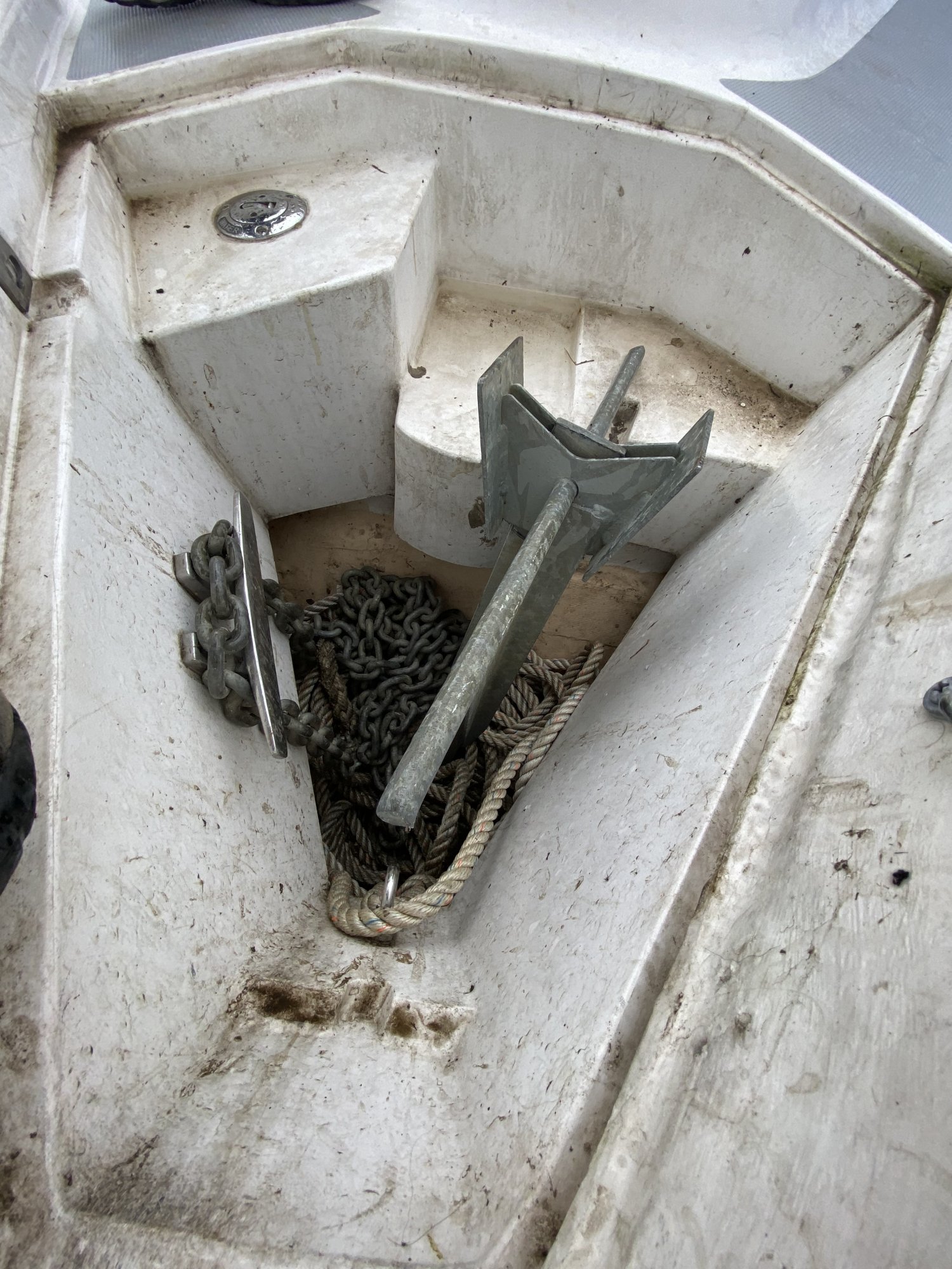

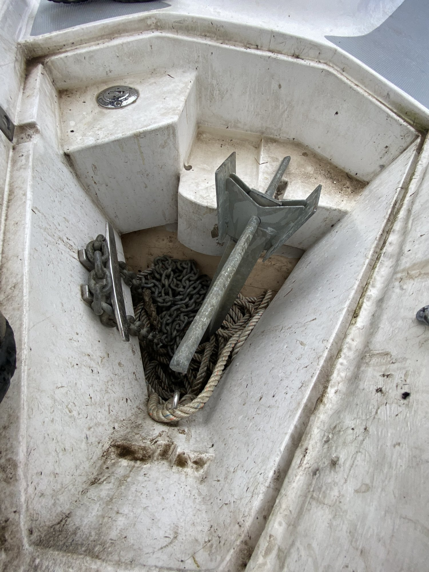

Jan 4, 2006
7,676
Can you take another shot a little further back of that first photo ? I can't quite get my head twisted around to recognize that section of the aft drip lip. Starting to wonder if yours is different from mine.

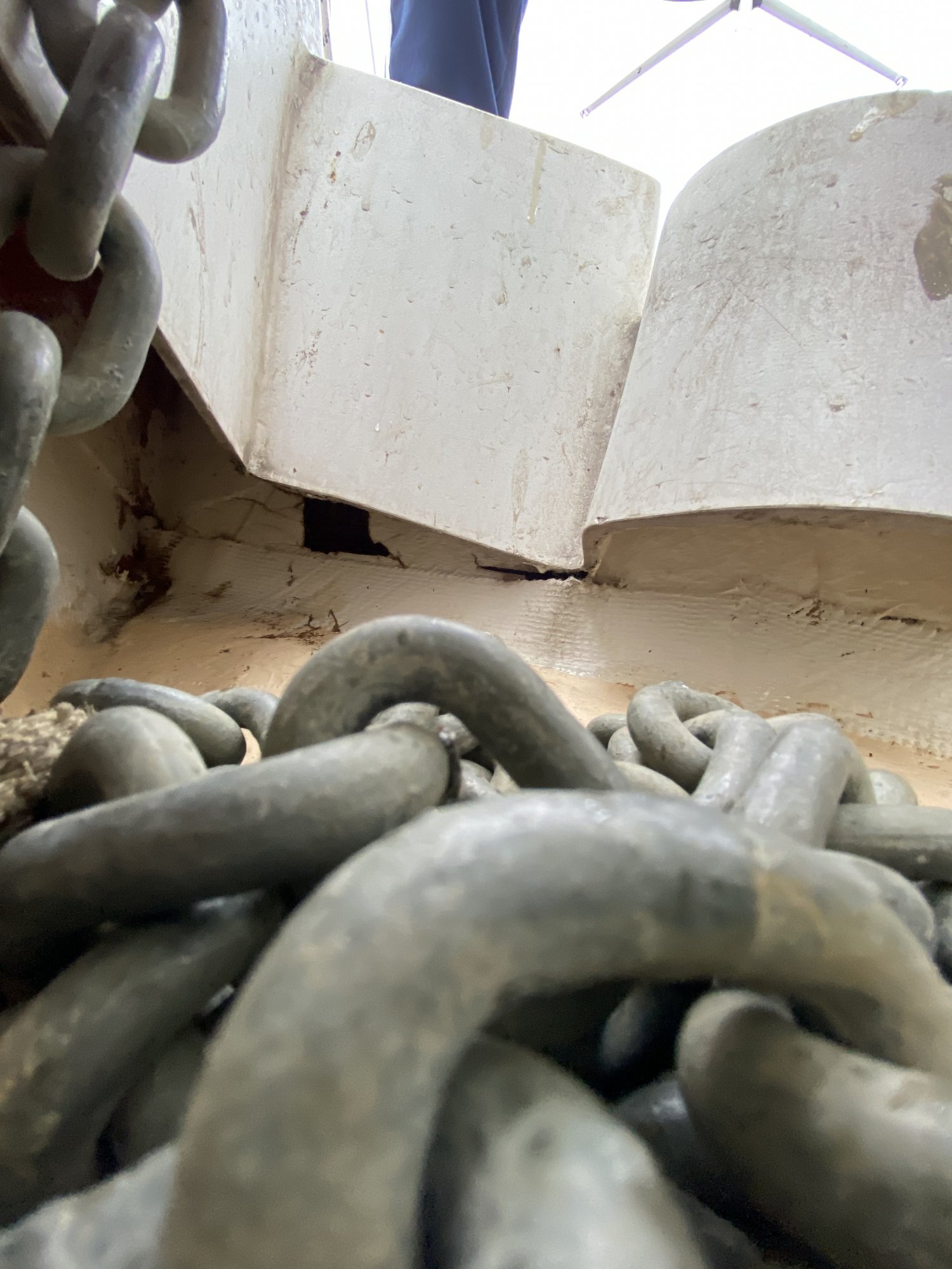

Mar 27, 2021
180

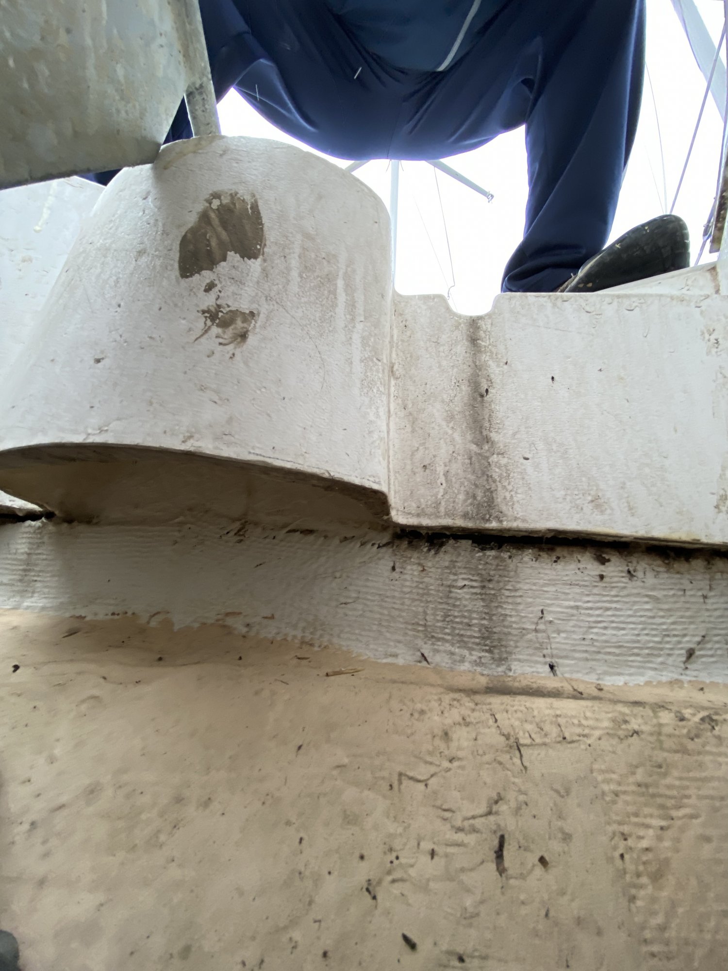

Here are a few better shots, each from the bow looking aft. It seems pretty clear that there was a previous weak attempt at a patch. I’m guessing the core was already wet when they put the patch on.
A5AE32A9-D15F-497C-A539-F033BFF33055.jpeg99B2E2DD-7C9E-42EA-8C45-10837CA82178.jpeg7E509509-2AC3-4AFF-AFCF-CDB4215CB1F2.jpeg

Jan 4, 2006
7,676
This shot of your anchor locker shows it to be quite different from mine.
And this is probably the first area that I hit with sealant and no decrease in the amount of leakage.
