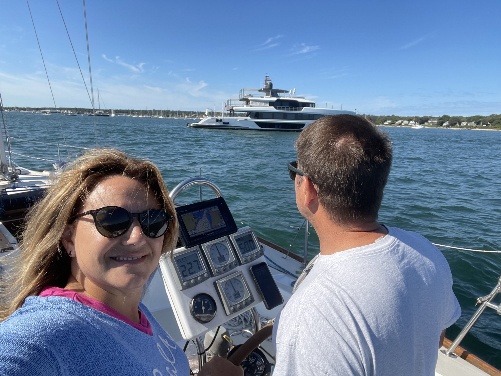

Garmin 741xs chartplotter, ($500) Has taken me accurately to a 1st place round the island race. Martha’s Vineyard has some current, rocks, and shoals. Nantucket sound haven’t run aground, lashed it to helm, powered it up. Super easy, garmin is very intuitive.
