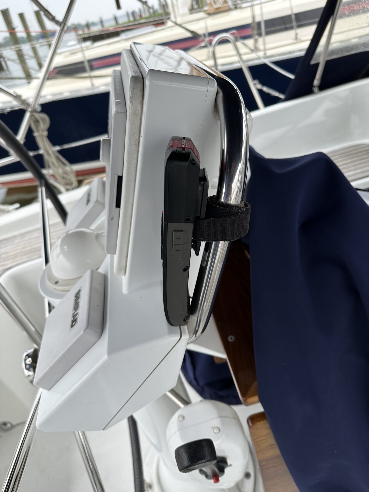

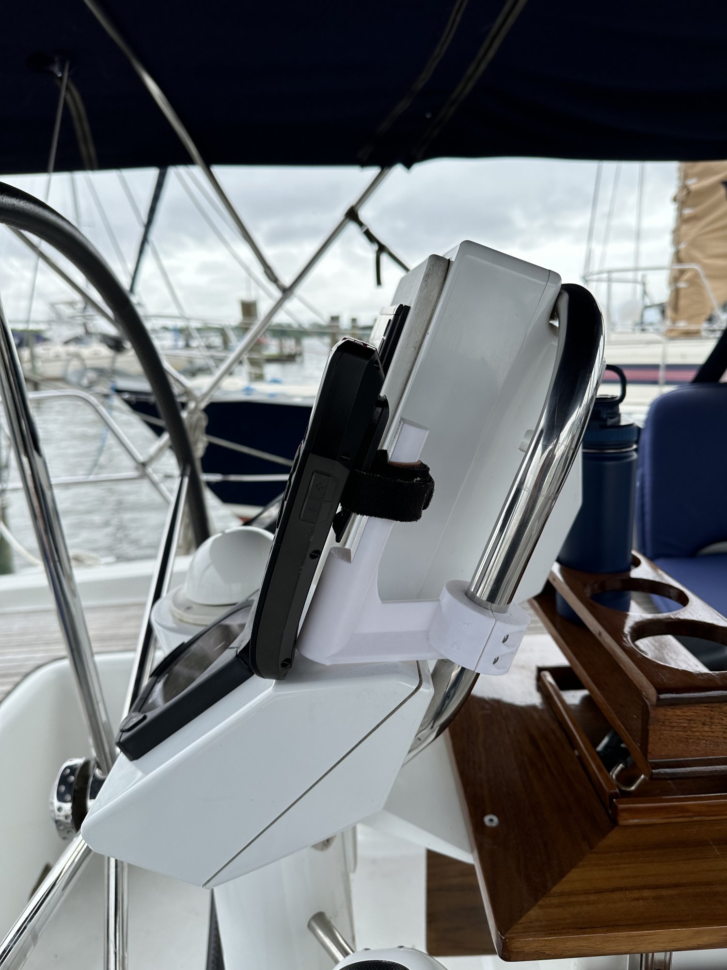

Cool, this will be much easier to install. Wrong. You still need to provide power to the cradle so the wireless unit gets charged. Yes, you could install the cradle down below, close to the battery, etc. But then where do you put the wireless handset when you're sailing? I
We wrapped a Velcro strap around our binnacle guard and used that to hold the handset with its belt clip.
The only downside of that was that we couldn’t grab the rail to brace ourselves anymore. To fix that I 3D printed a holder that only bolts around the bottom of the railing.
