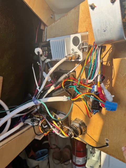

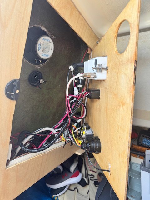

Hello all

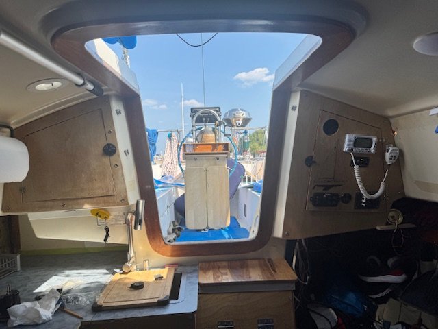

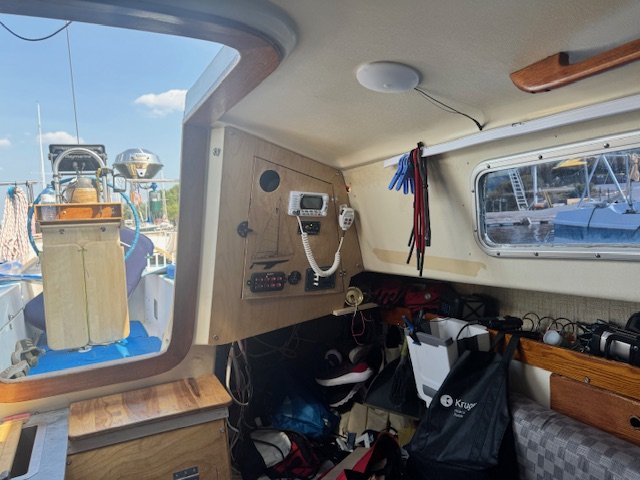

Had a busy day on the boat today.
mainly worked on making a new wall panel that includes the main electrical panel.
still a lot to work on, had a snag with the am/fm radio, the bracket to hold it in place is too big and makes contact with the cockpit speaker, so I will design and make a new bracket. Still have to wire the gas fume detector(new addition) make the holes for the mast light switches, add the inverter remote switch…

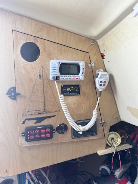

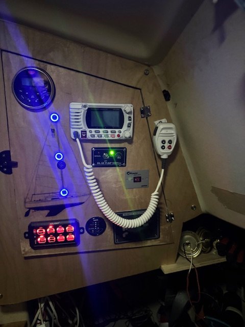

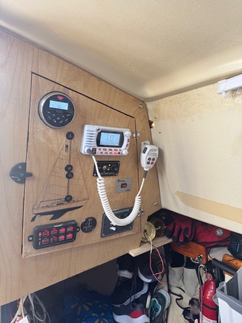

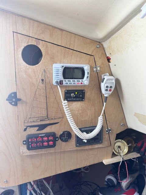

For the pic of our boat, I used the line drawing from sailboat data, copied the image, printed it on transparent sticker paper, stuck it on the panel and epoxied the whole thing
I do love the end result, next I will drill holes in the mast drawing to put the switch where they relate to the boat (anchor, steaming, deck and nav)

That's a great idea for getting the picture!
Interesting idea to put the switches in the positions for the light. Mine has LEDs that light up when the light is on. I'll be interested in seeing how the switches inserted in those locations look when you're done. Very cool!
dj
Likes: Timm R Oday25
24,521
Maybe more complicated wiring, but I’ve seen LED’s used to show the lights on the boat image when in use. They get wired to a 5 switch standard breaker panel for the lights. That would be your 4 plus a spare. It will not be long before you find a purpose for the spare.

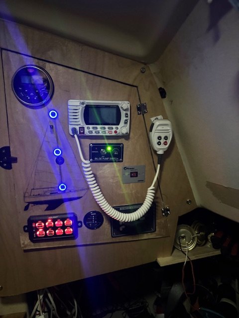

The switches I will add are light up as well, and I am planning / shopping for led’s for the nav lights on the drawing as well.

Nice!. Initially thought that you had burned outline of the boat on the panel. Look forward to seeing final result.

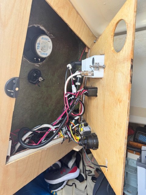

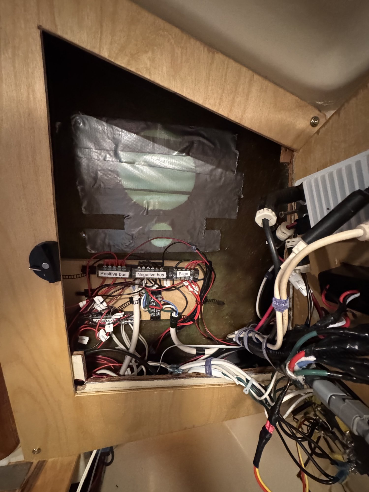

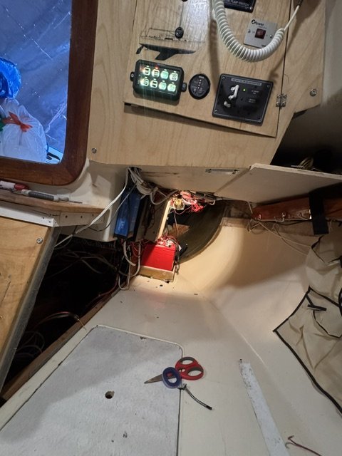

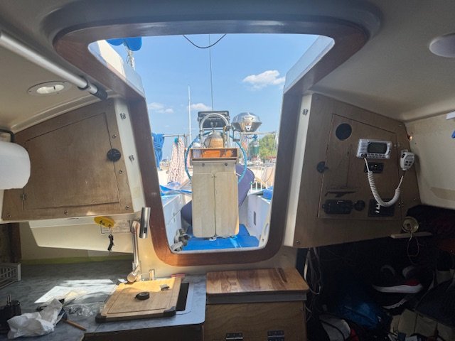

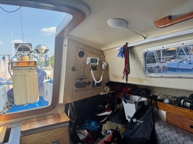

Here are the updates for the panel, almost completed.
still need to wire the gas fume detector.
I need to replace or check wiring for one of the mast light switches, screw down the inverter control panel.
and do a lot of structured wiring in the back, and elsewhere as well

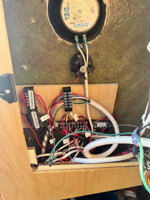

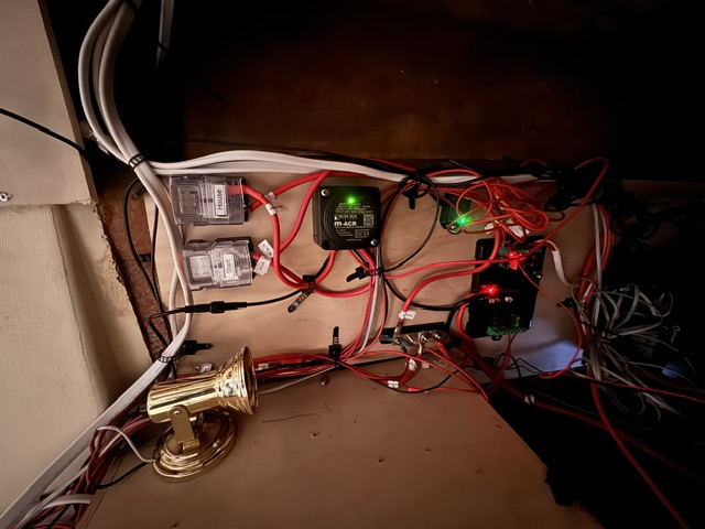

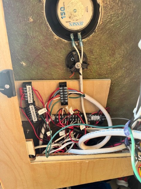

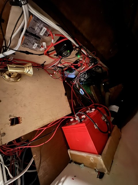

Hello all, did a lot of work on the electrical lately, thought I would the update.
even added a light for the battery compartment, did a lot of wire managing, still have some to do, but on the port side it is almost done!!!
it is a lot easier to wok in there now
