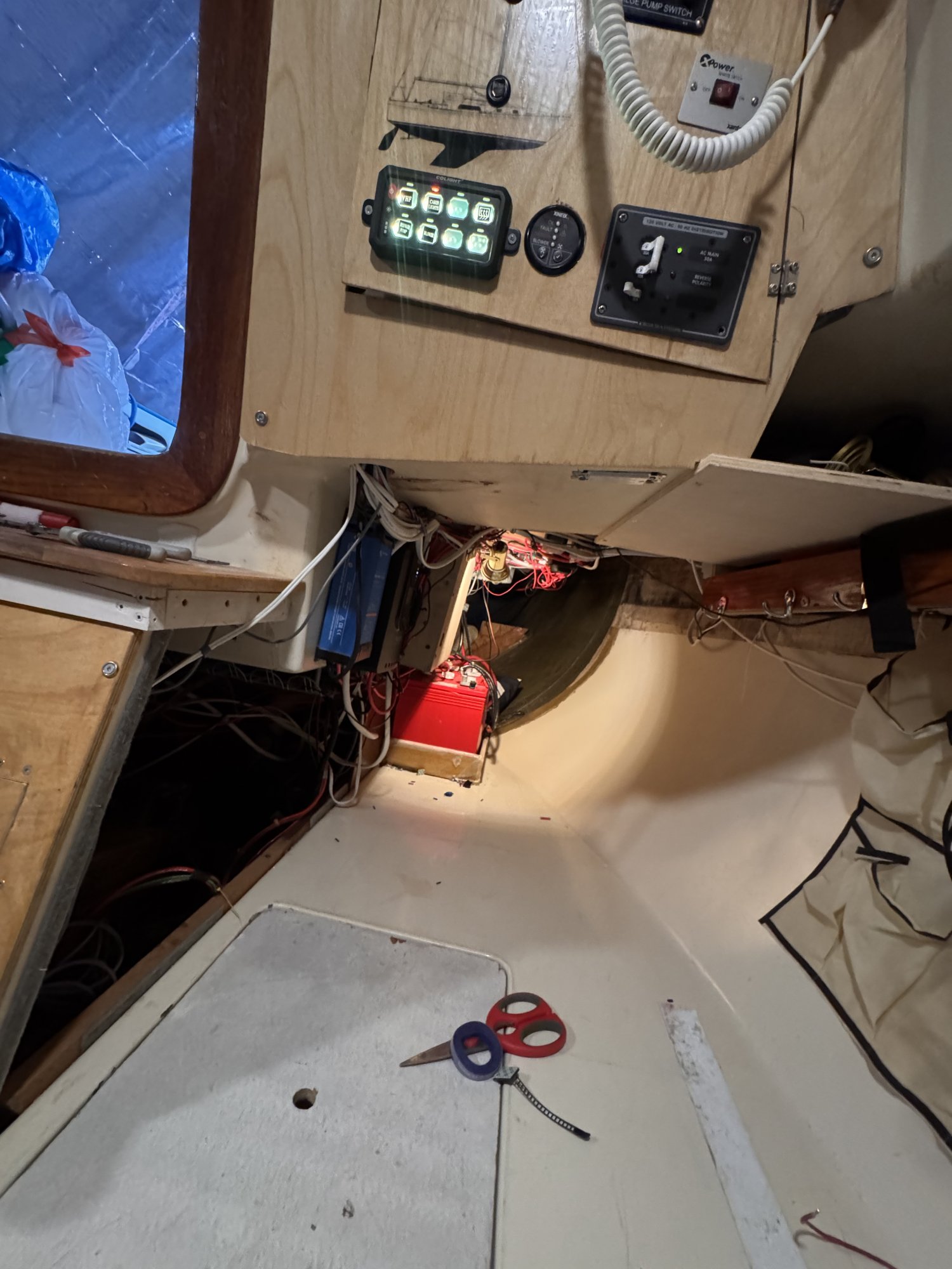

Hello all, did a lot of work on the electrical lately, thought I would the update.
even added a light for the battery compartment, did a lot of wire managing, still have some to do, but on the port side it is almost done!!!
it is a lot easier to wok in there now

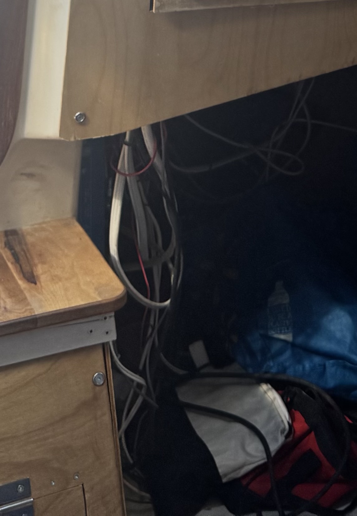

I wish I could say I am done, but still a long way to go to accomplish what I want, I am still trying to find a way to completely hide the wires, I am always afraid the grandkids might accidentally grab/rip out a wire.
these are before and after pictures

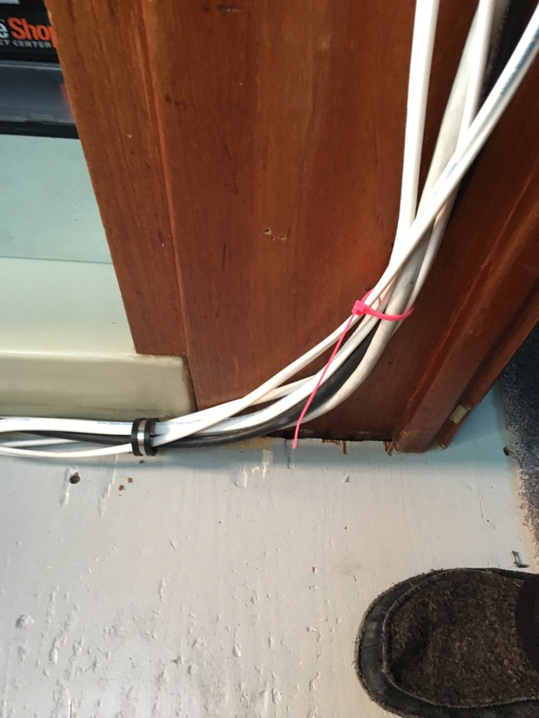

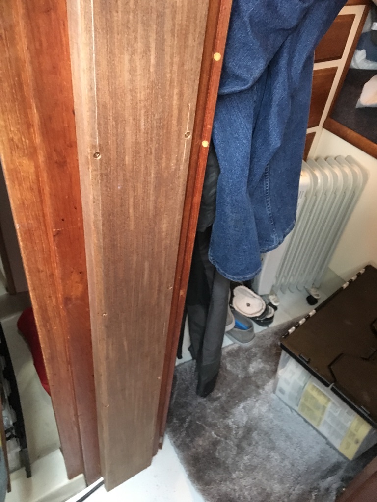

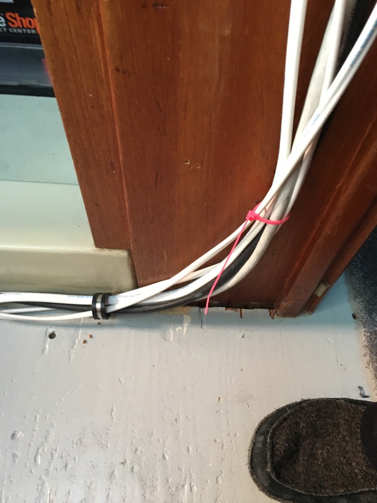

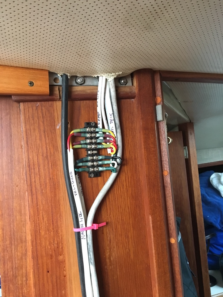

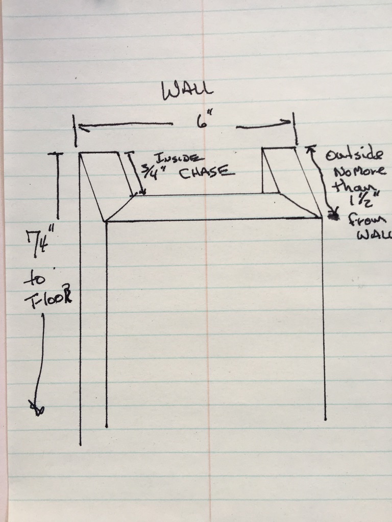

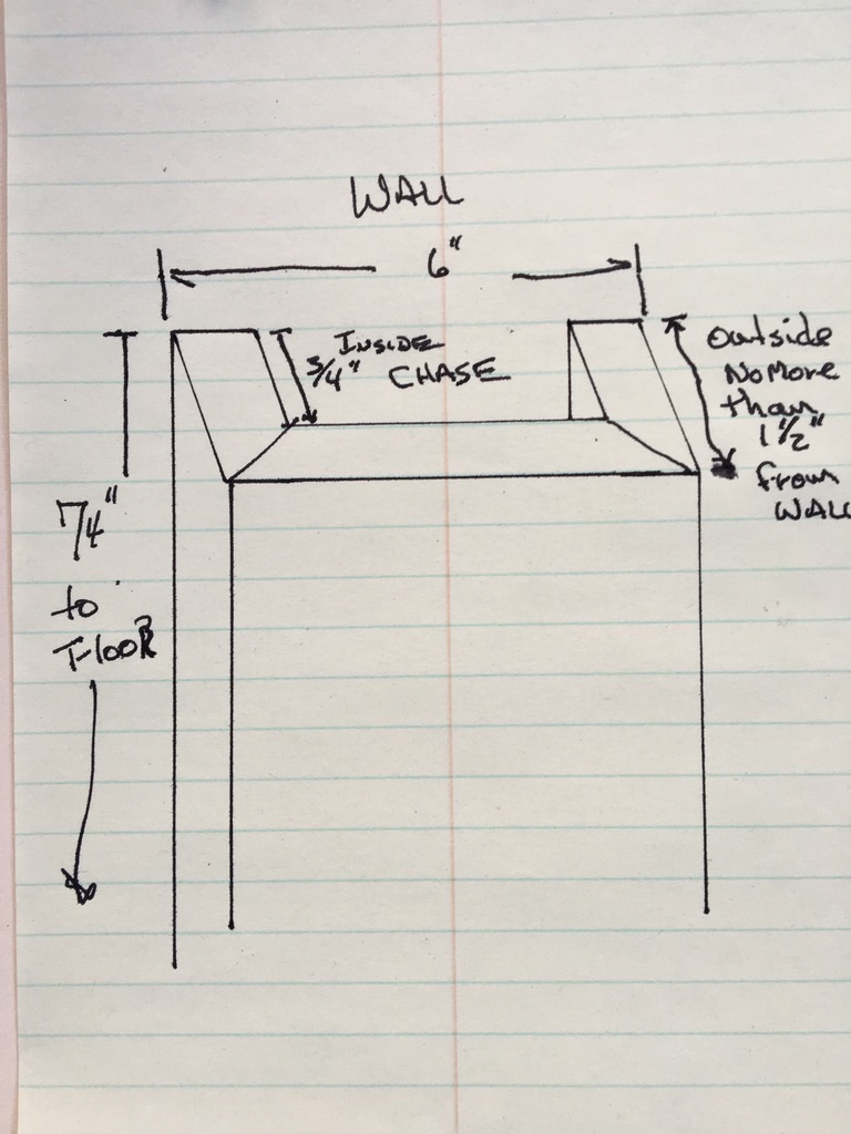

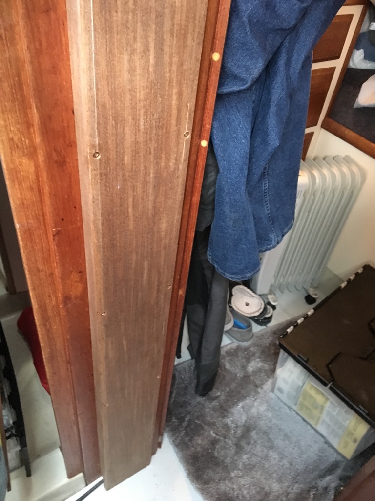

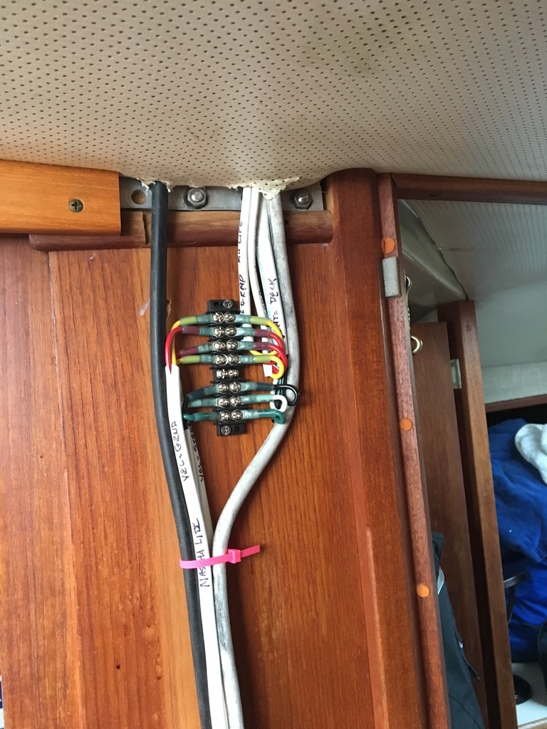

I was faced with running my cables from the mast to the electrical panel.
The original wires were somewhere in the compression post. Simple access to the wires was impossible. As they were already 45 years old, I was running new cables. I also wanted a way to disconnect the wires in the boat, should future mast removal be needed. (I prayed not in my lifetime.)
Here is the wire routing, and the chase I had made to hide them.
View attachment 237566 View attachment 237569 View attachment 237567 View attachment 237568
Nice! Thats exactly what i was thinking.
