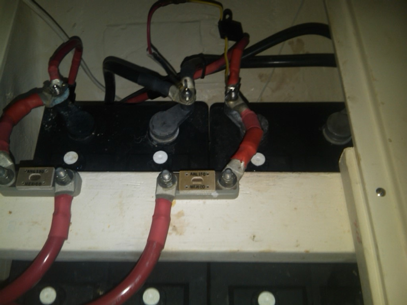

Maine...
Would these be acceptable or should they be the ones attached directly to the post??
Feb 6, 1998
11,760
Maine...
Those are fine, nice job!!! Ideally they should be covered to protect from the errant wrench but at least you have fuses. If that is a stand alone compartment not a big deal for post coverage but if "shared" the terminals would ideally get covered..
The ABYC standard is for the fuses (Class T, ANL or MRBF types meet the AIC requirments) to be placed within 7" of the + battery post. So long as the wire between the battery and fuse CAN NOT POSSIBLY SHORT then going a little longer is often fine. 7" can be next to impossible on many boats and any fuse is better than none..

Gpd955
Would it not be safer if the other two heavy wires from both pos battery posts were also connected to the downstream side of your fuses and the thin yellow wire to have an in line fuse of appropriate rating.
When Hunter sent out additional fuses and wires for many boats they included a 10 amp one for my low current wiring.
Thanks Hunter.
