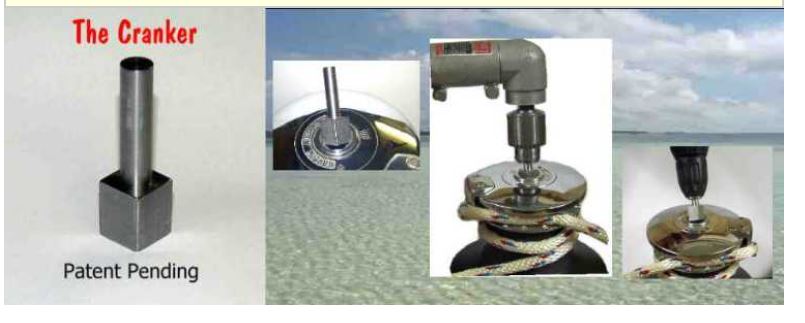

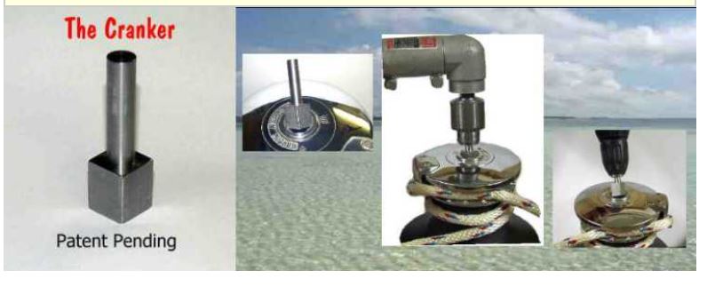

I did use a Makita 18v for several years till the batteries wore out, it had no problem raising the main. The right angle drill is easier to hold and get leverage.

Bill, can you send a pic of the cracker bit? I don’t think I’ve ever seen one or if I did, then didn’t recognize its “dual” purpose. Thanks, Jerry

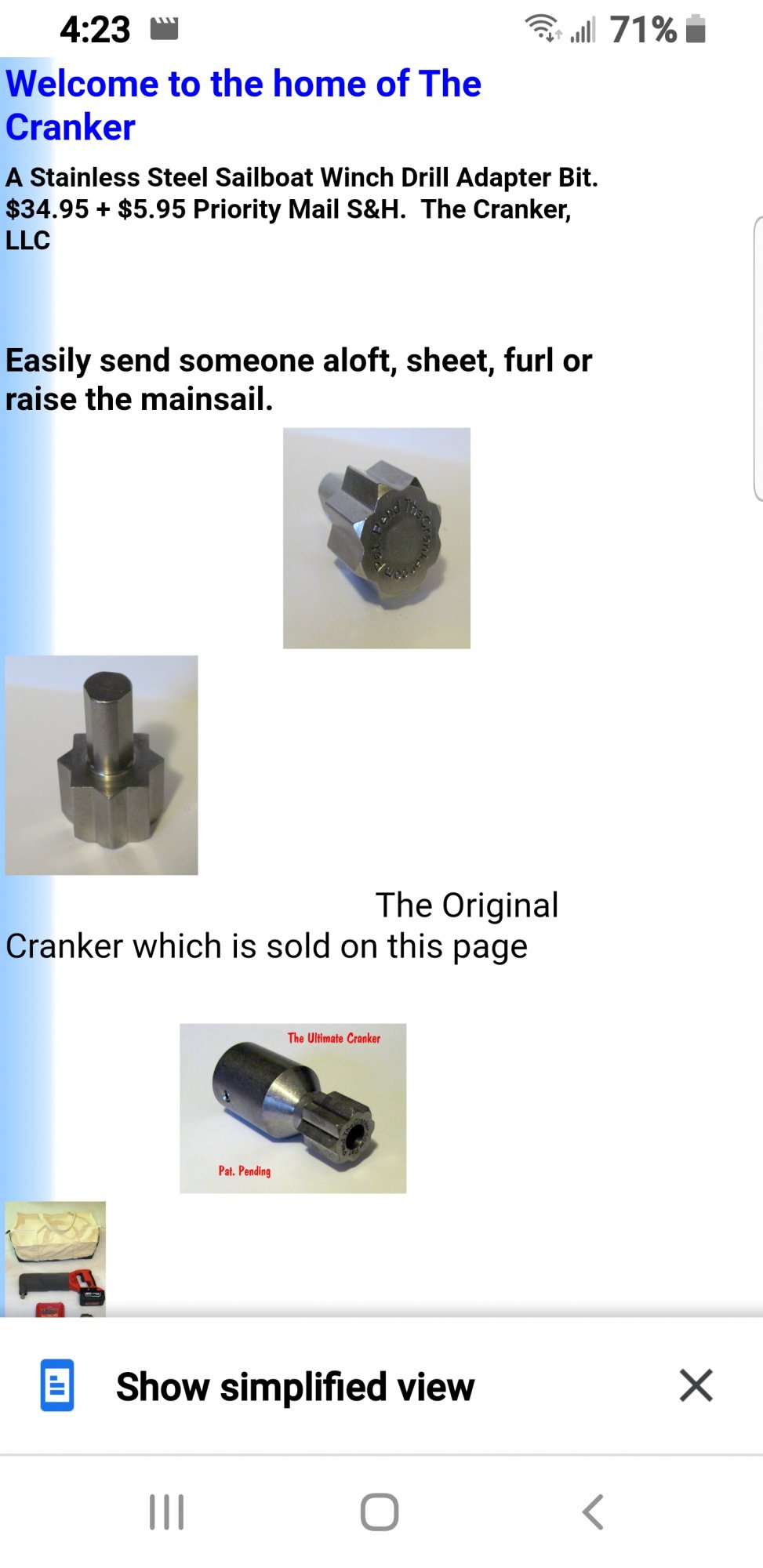

Who pays that kind of money for such a simple drill motor adaptor :yikes: . are they gold plated platinum or what? 10 minutes with a lathe or buy a Universal brand weedwhacker head arbor bolt and file/grind/sand 1MM off the 4 flats (19MM needs to be 17 across the flats). $8.00 new at a greedy lawn/garden supply dealer or .50 from the same dealers scrap pile.
ARBOR BOLT 10MMX1.25MM LHF HUSQVARNA
