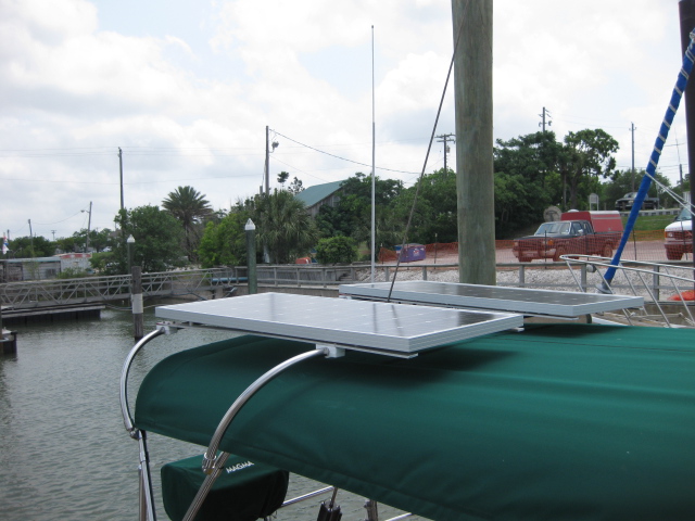

Wow, that's a ton of solar on a boat that size! How many square feet, do you think?
BougeRV 200 Watt Solar Panel are 58"x26" or basically the same size as my current 2011 95 watt panels on Impetuous. I found them on Amazon after hearing about the Bouge company on a sailing youtube channel.
Hold out for a sale price on them. I saw $169.99 a month ago.
These are the 95 watt panels separated by the backstay.
