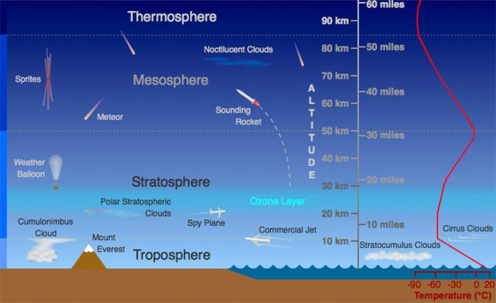

Yes, that reaction is correct. It is important to understand that 50% of the earths total atmosphere is contained in the lower 3.1 miles of air and that number reaches 80% at about 6.2 miles. See graphic attached.
I am not an expert on atmospheric chemistry. But I do understand molecular kinetics, equlibrium and how they effect reaction rates. There exists an equilibrium between "outer space" hydrogen and hydrogen contained within our atmosphere (however you choose to define atmosphere). But if we dramatically change the concentration of hydrogen in the troposphere, that equilibrium will change. Now that you have pointed me to this ozone studey with hydrogen gas, I am even more concerned that a hydrogen economy will result in the extinction of most life on this planet.
