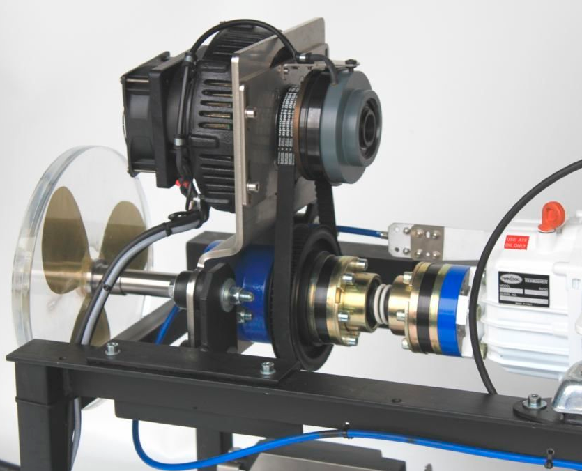

You could always go this route and it may even increase its sale ability down the road .
Now that's an interesting idea for a little boat.
As for resale value of any electric powered sailboat, I'd go with JRT's "1) Professional design and installation" as the most important criteria in that ball game. I wouldn't touch a cobbled together system without easily accessed standard parts with a ten foot pole, as they say.
Sorry, I've just seem (many on here and other forums) way too many owner modifications that become a head ache for those who own the boat later.
Rod of Compass Marine excepted, but of course, he IS a professional.
I agree this looks interesting, who is this? I'd be interested in how it prices out and the requirements. But honestly if this is in the several + boat bucks category, I'd probably just add some awesome high tech sails to at least make me look cool and fast even if I'm not...
