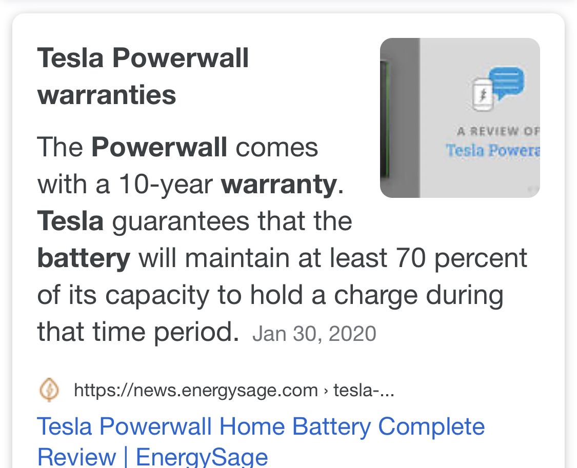

I do like the idea of electric power I have some reservations though. How long do these batteries last. From my limited knowledge I assume all batteries eventually die / won't hold a charge.
I'm a huge Tesla fan (car not the scientist although I don't do respect him) just wondering how long will those batteries last. Cost of replacement I understand is prohibitive. Sorry if I got away from electric power in boats.
Good point. TeslsaWall batteries have a 10 year warranty, and I think that is for something like 90% capacity (though it might be 70%, not sure). I know I had the same concern, which was fed by naysayers, back when we bought a Prius (yeah, I know) back in 2005. FUD (Fear, Uncertainty and Doubt) crowd said, "it will cost you $2000-3000 to replace those batteries! Well, 10 years and 305,000 miles later (when someone hit the wife and totaled it), we were still averaging 50mpg, and interestingly, never did have to replace those expensive batteries. YMMV
