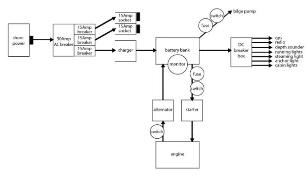

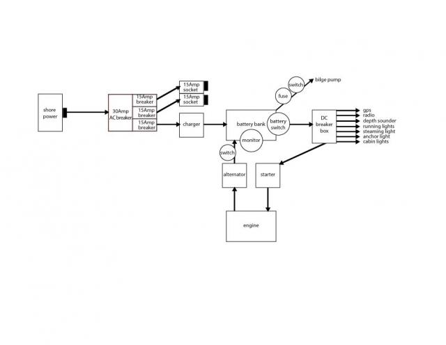

Your DC side seems a tad confusing and perhaps incorrect.
Batteries should go TO the switch. ...
To explain, the battery bank will probably have four 6V batteries, so the switch on there is a simple 1/2/Both suggested by MaineSail. I just didn't bother drawing that all out.
...if you want to fuse your starter...
I've moved the starter to the DC breaker panel based on yours and others comments; seems cleaner.

The sockets are usually 15 amp. The incoming shorepower is commonly 30 amp. It doesn't make sense to plug a 30 amp shorepower cord into a 20 amp breaker. You should keep the 30 amp double breaker and from there go to separate 15 amp breakers for each load - charger, outlets, etc. Below are pics of the one Maine suggested as well as an alternative with 2 less breaker positions.
Thanks, I've redrawn this as you suggest.

The starter should go to the common on the 1,2,both switch, or whatever main switch you will be using.
AC looks much better now.

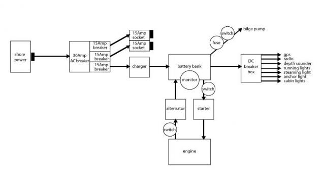

OK—since the breaker panel has an all off switch, I've removed the 1/2/B. The starter will have a separate switch with oversized wires and no fuse. I've updated the drawing.
I'm skipping the fuse on the starter wire per the BlueSeas circuit protection page:
"Except for those wires that are intended to carry starting currents, every positive wire in the DC main power distribution system must be protected by a fuse or circuit breaker."

I see what you have done. That leaves you without any battery bank fusing. You should fuse the battery bank as it is used for both house loads and starting. The way to do this is to use one of the 2 types of fuse I linked to - either at the battery bank with a MRBF or within 7" with an ANL fuse. After the fuse go to the switch and the switch output can go to both the main panel and the starter.
You do not need a fuse on a bank used exclusively for starting but your bank is used for both starting and house loads.

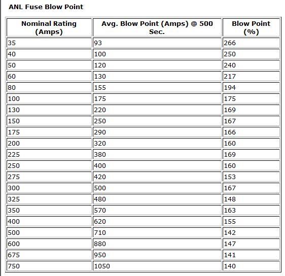

I fuse starters for customers on engines up 60 hp or so and have never had a problem. An ANL fuse will handle about 160% of its rating for 500 seconds (over 8 minutes) and a great deal more amperage for a short period of time. I would not try to fuse large engines and that is the reason for the ABYC exemption.
Here are the ANL blow points at 500 seconds.
I wouldn't use a lesser fuse for this.

Your latest diagram is getting closer -- but still not there. Fusing is serious stuff. It is designed to protect a wire that gets to ground, so look at your wires and say "what happens if this goes to ground right HERE?" A fuse better blow. So, with that in mind, a few comments:
* The charger needs a fuse, right close to the battery.
* The alternator needs a fuse, right close to the battery.
* You show the bilge pump with a fuse, right close to the battery, and this is correct.
* You need a fuse on the wire going to the main panel, right close to the battery (and a switch, too).
* You have a mombo fuse on the battery lead going to the switch.
The way you have the circuit laid out, all those items are right on the battery terminal. Two problems -- first, it's messy, and second, it's more than the ABYC limit of 4 lugs on a terminal.
My suggestion is to get ALL those items on the protected side of a big battery fuse. A nice MRBF, or my preference, an ANL mounted close (ideally under 7") to the battery. Then you have ONE wire going to the battery. You can then connect everything else to the fuse block. If you really want some loads to be uninterrupted, you could connect on the battery side of the fuse (I wouldn't), else you can put them on the protected side of the fuse (my preference). Also, I would connect both the starter and the breaker panel on the same switch (you turn the switch, the boat is "live" -- you have a problem and you turn the switch and the boat is "dead"). I would also take the smaller (non-starter) loads to a small fuse panel (no need for breakers) off of the battery fuse (or off of the "battery in" lug on the switch if it is more convenient). This fuse panel, with one wire off the fuse, would then have fuses for: Alternator (this may be a bit of a problem with size), battery monitor, bilge pump, and battery charger.
The connections then would be:
* Battery has a lead to the fuse
* Fuse has a lead to a small fuse panel and the main switch
* Main switch feeds house panel and starter
You would still need to put in a fuse/breaker, right at or near the switch, to feed your house panel.
Or, you could put in an MRBF, and run a lead to a Blue Sea 8686
http://bluesea.com/files/images/products/8686.jpg
It would then feed the starter without any extra fuse needed, feed the house panel through a breaker (both start and house would be switched, too), feed the bilge pump through a breaker, feed the "memory" (memory, battery monitor, other such loads), and has a nice empty spot for a breaker for the charger. Not my preference, as there is still a lot more distribution required after the 8686 (and you still have an alternator to deal with).

I agree with the above with the exception of the Blue Seas 8686. For one he only has 1 bank. For another, if he did have 2 banks that switch lacks flexibility to start from either bank, combine being its only option. Combining a battery that is incapable of engine starting with a charged bank makes no sense.
I would go to one on/off switch and from there to both the panel and starter. If a second bank is planned for the future a 1,2,both switch makes sense.
