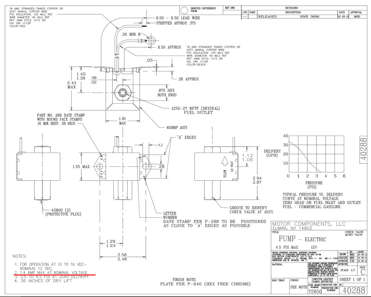

Can I connect the pump positive wire to anything ignition switched in the engine compartment other than the starter solenoid? The draw is less than the 3 amp fuse recommended. I saw somewhere 1.4amps.
The 3A fuse is intended to protect the pump as well as the wiring.

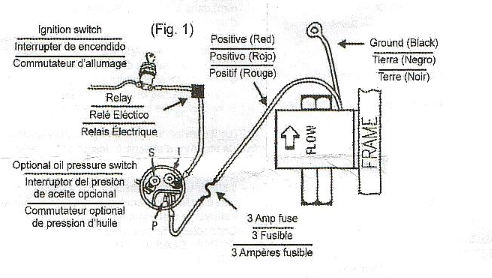

Absolutely. However, I wouldn't follow the installation instructions of connecting the pump in series with an oil pressure alarm switch.
In this arrangement, the fuel pump does not start until oil pressure is established. In your case, you want the fuel pump running before starting the engine and who knows, maybe it will assist in starting. Highly unlikely, but hope springs eternal. The oil press. alarm switch shuts down the fuel pump if the engine should die and the ignition keyed switch is unknowingly left in the run position. This is intended to prevent pumping fuel into an aspirated engine cylinder but not a fuel injected engine (think diesel) where any injector in good condition will prevent fuel flow under lift pump pressure.

...and, as Ralph noted about NOT using an oil pressure switch in the power to the pump, because it would be a way to defeat the great advantage of having an electric pump for BLEEDING.
FYI skippers Westerbeke and Universal actually added this oil pressure "trick" to their engine control system after the M25 and M25XP series, for the M30 and M35 for example. It created lots of bleeding headaches, which they argued by saying the newer engines were "self-bleeding." Bollocks, you still had to bleed the secondary engine mounted filter. Why? Because it was mounted vertically with no way to completely fill it up so it was necessary to bleed it via the screw at the top of the filter bracket.
