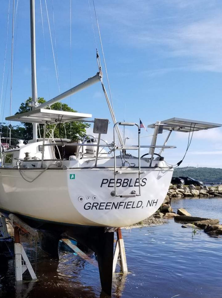

Tom,

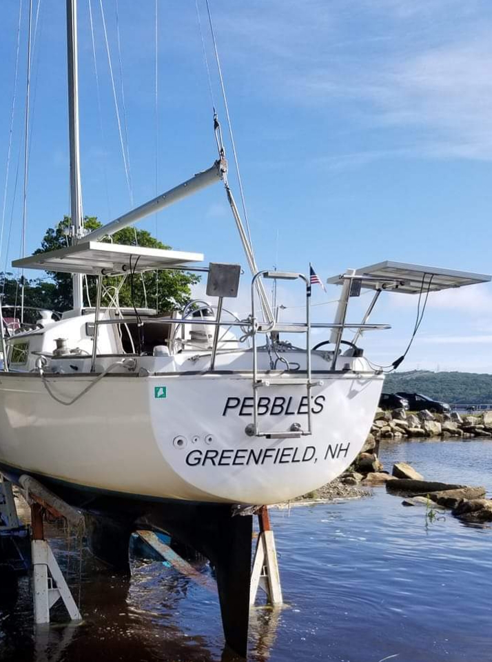

I put the panels on the stern rail using rail clamps. They can be adjusted vertically or horizontally. Plus they are very easy to take off & store in the quarter berth should the need arise. May not be "pretty" but it works.
I have sketched out a small pole system based upon what James Baldwin did with his boat Atom. This would allow the panels to be manually adjusted to follow the sun. Just haven't got around to fabricating it yet. Not sure I will, seems llike it would be a PIA to store them not to mention additional windage.
Your comment on light wind sailing is spot on. Hit the switch & 5 minutes later you're sailing again.

Tom,
"Pretty", is subjective.
I don't how you use your boat, but let's assume you're the owner of an average coastal cruiser, of which there are thousands along our coast used seasonally.
Most rarely go 40 or so miles from home. Use is mostly weekends with perhaps a week or two vacation on spent on the water.
Imagine you're in the Penobscot Bay area for 2 weeks on PEBBLES, eating, sleeping 24/7 with one other person onboard.
You'll anchor out (or moor) every night (no shore power) and travel between destinations - daily, for an average of 4 hours per day, under sail or power depending on conditions (as is typical).
Throw in a couple of 8 hour days underway, which might be typical. Average a comfortable speed for your boat, let's say 4 to 5 knots.
Forgot to add, assume you're running refrigeration as most would, for two onboard.
Imagining this scenario: How you often - and how long - would you need the gas generator running?

I'm on a mooring or anchor 24/7. Only time she gets tied to a dock is when she comes out or goes in the water.
Once the boat's in the water I pretty much live on her in Penobscot Bay for 10-12 weeks. The solar system provides 99% of my energy needs. I'll use the generator at least once a month to power the on board charger to balance & equalize the batteries. Other than the 24NM trip from Belfast to Winterport the genny only comes out to run powertools or the microwave. Haven't gotten around to installing a large enough inverter to run the microwave yet...
For the record, I've never have made the whole trip up the river without dropping the hook & catching the next tide the following day to my destination. This is due to the type of onboard battery charger I have. It doesn't charge the battery bank in a string but rather each battery independently. I went this route so the batteries in the bank remain "balanced".
Charging the bank in a string is the only way to motor long distances but I don't feel like spending $500.00 at this point in time for a charger that would allow this.
The thing about electric, faster you go, faster the battery bank gets depleted. Most folks that go this route are content with "motoring" at 3.5-4 knots. IF you are on a schedule or feel the need to motor at 5-6 knots for a prolonged period of time, electric is not for you.
Pebbles is the first sailboat I've owned. I came into this with my eyes wide open knowing that I'd play the tides & wind direction. If the stars don't line up I wait or what is now my new favorite saying thanks to jssailem, "float time".
