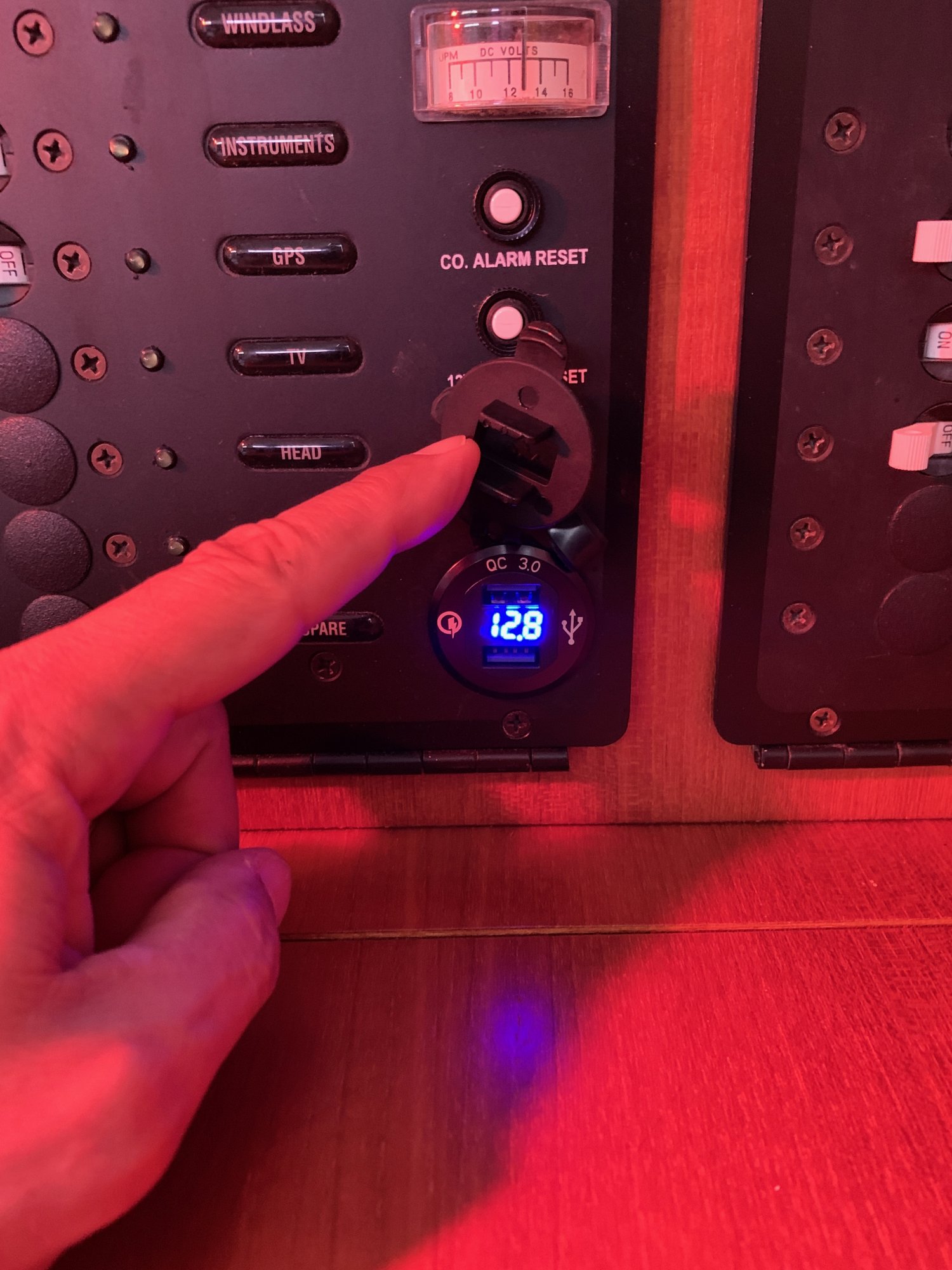

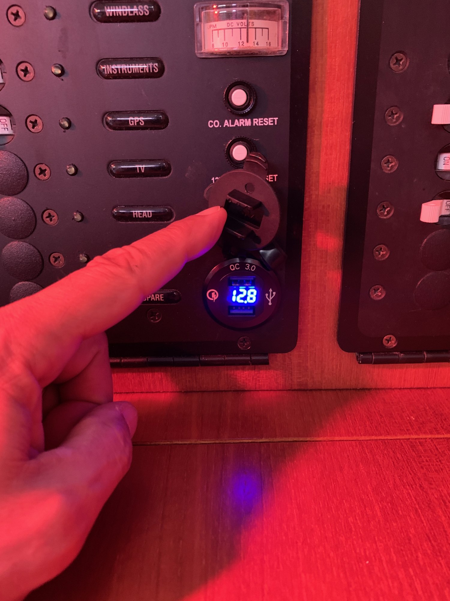

All done: very quick and easy with the step drill bit in the aluminum panel. Found some "step-down" crimp connectors to go from the 12 gauge to the much-smaller-than-12 that came with the USB port. Thanks for the advice (which, admittedly, probably didn't require 47 postings. But clearly entertainment is one aspect of this forum!)
