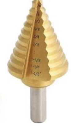

Drilling a hole for a USB port in the DC panel

I did this swap couple years ago. Changed out one of the cig plugs and installed a USB socket. I used the step down drill as mentioned above. Worked great.

It looks like clearance underneath may be a problem for a step drill. Even removing the nav station lid may not give enough clearance.
Also, be sure to power everything down before flinging those chips into the panel. I'd use a hole saw for those reasons also the hole saw makes smaller chips which will be less likely to lodge where you don't want them to.

Doesn't really apply here (it's just a drill bit), but...
Definitely not, if you ever need to make a hole in sheet metal or thin plate again. My step bits (I have three, covering a range of sizes from 1/8" to over 1.5") are among the tools I use the most. It's one of those tools where you wonder how you ever got by without it.

I think going straight in from the front of the panel (closed) will work fine, as opposed to going in the back of the open panel. Of course, I'll tape some paper back there to catch the shavings. Step drill bits arrived today. I got the metric ones, just b/c the USB device called for a 30mm hole.
Thanks again for all the comments. I'm pretty sure this will work much better than using a regular hole saw (although the trick about chucking two hole saws together is one I'll [try to] remember!).

Take your care when drilling that hole with the step bit. You will be tempted to put the bit all the way into the hole and start the drill motor but you are best to start the drill and slowly move the bit into the hole because you are shaving the hole larger with an edge drill rather than straight into the material as with a twist bit.

Step bit from harbor freight. I just used one to enlarge a hole on my binnacle, did a nice clean job.
