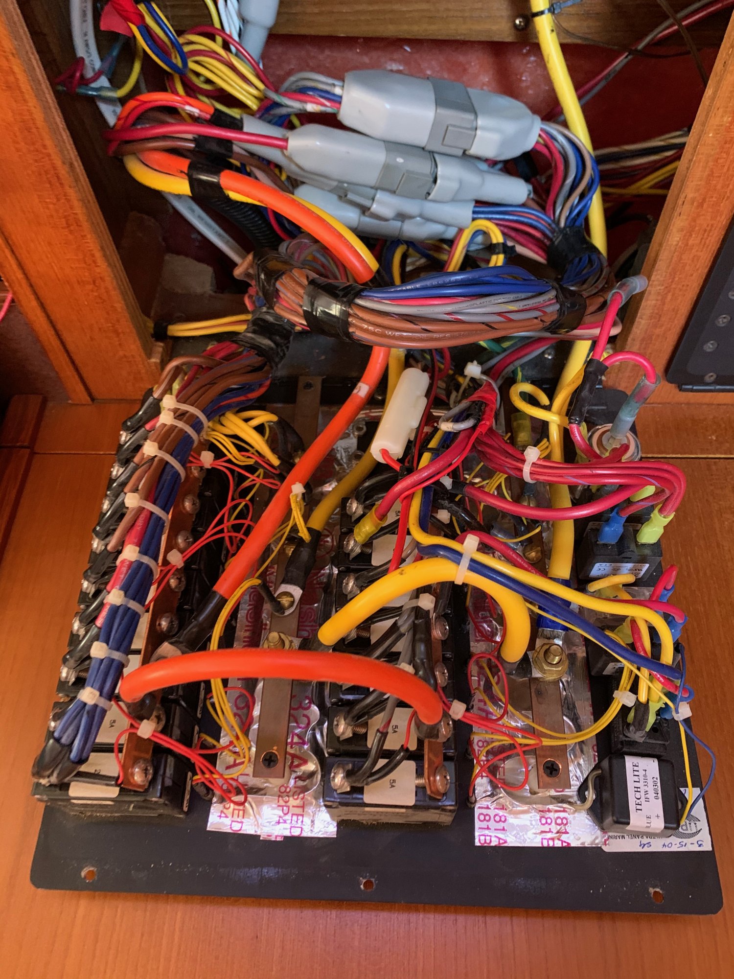

So my DC panel has 2 of the old cigarette lighter sockets for DC accessories, and I got this neat little dual USB port that I plan to swap in to replace one of the old sockets. Problem is, the old hole in the (metal) panel is 0.85", and the new hole needs to be around 1.18" (3cm). I want to redrill the hole without totally removing the panel from the boat, which would require undoing about 3500 different wires which are very nicely routed to the panel:

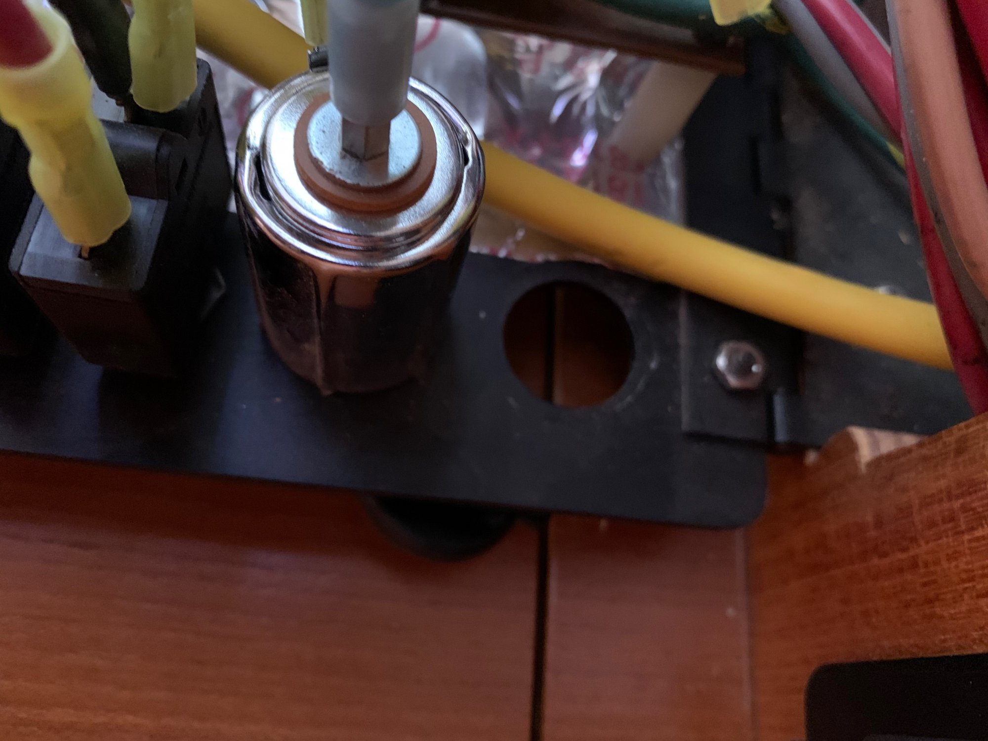

As you can see: that's one heck of a lot of wiring, but I think they did a great job with it, so I'd prefer not to disturb most of it. The best idea I have so far: buy a 3cm hole saw and cut a hole in a bit of scrap plywood. Then clamp this to the back of the panel (3rd picture) as a guide, and drill from the back. Put something under it so I don't drill through the chart table. I'm guessing the panel is made of aluminum (painted black), but I suppose it could be steel. I hope not...

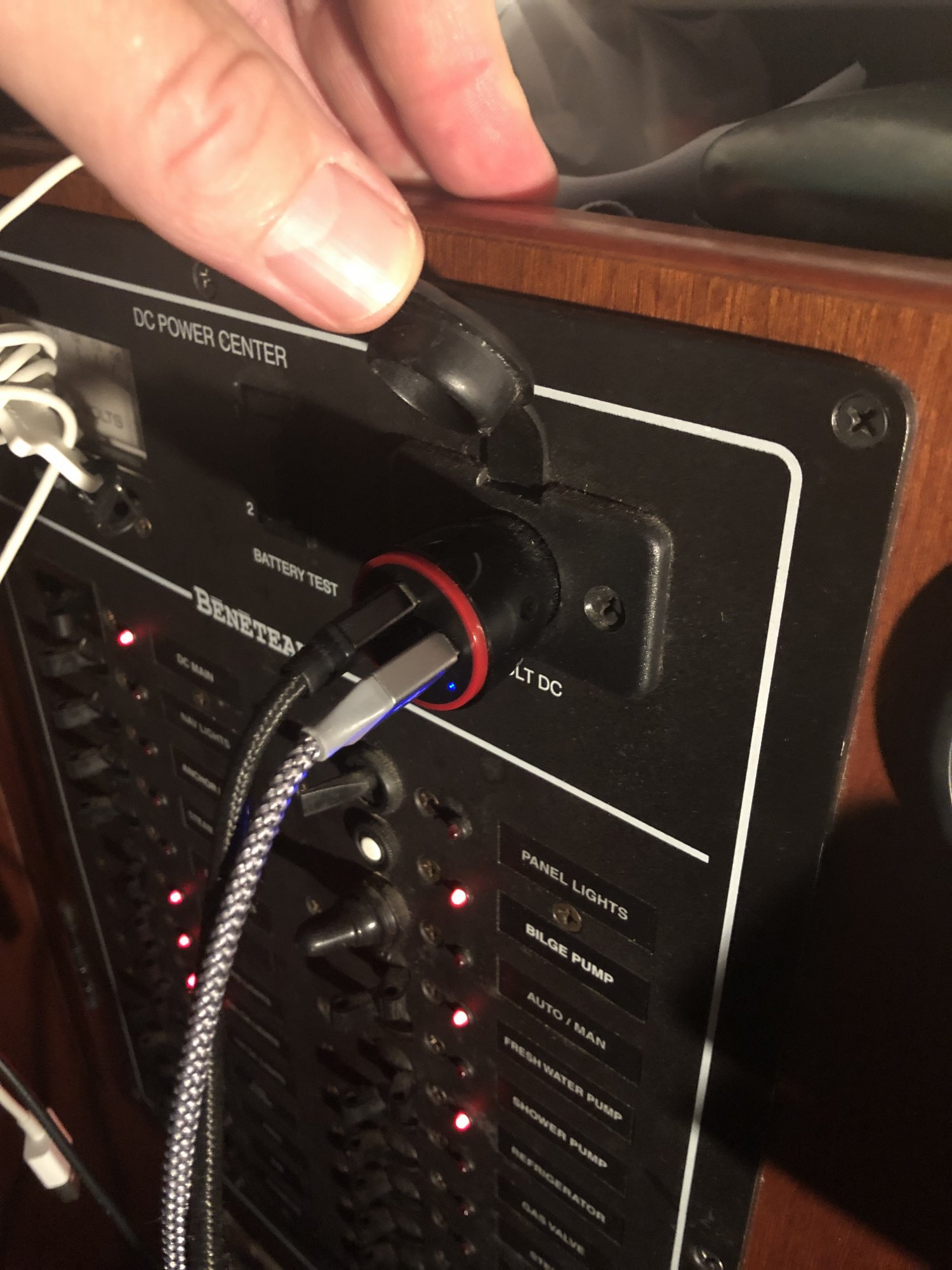

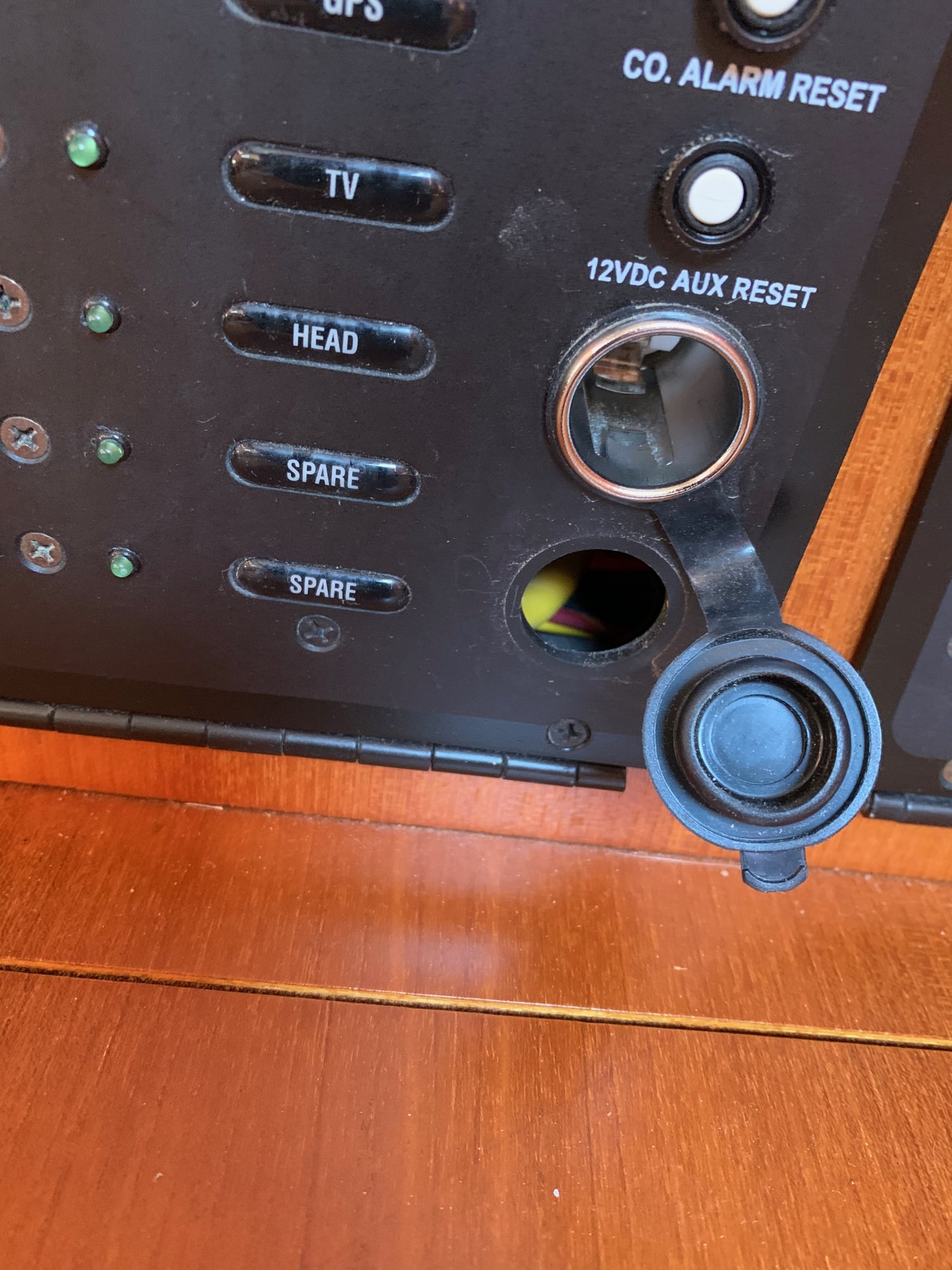

Die mentioned above does the best job.I had 2 ,12v sockets. I left them and installed the usb in another space on the panel.
I purchased a 12v to 19v buck transformer off amazon for the one outlet . 19v is what a laptop takes & now allows me to power the computer off the batteries. Bought a wifi extender and POE powered it with 12v and cut the 120 v transformer wires off my wireless router and wired it to 12v,
I now have full wifi on the boat ,laptop, and with extender hook to the club when on a mooring . Our phones automatically hook to the wifi saving data
