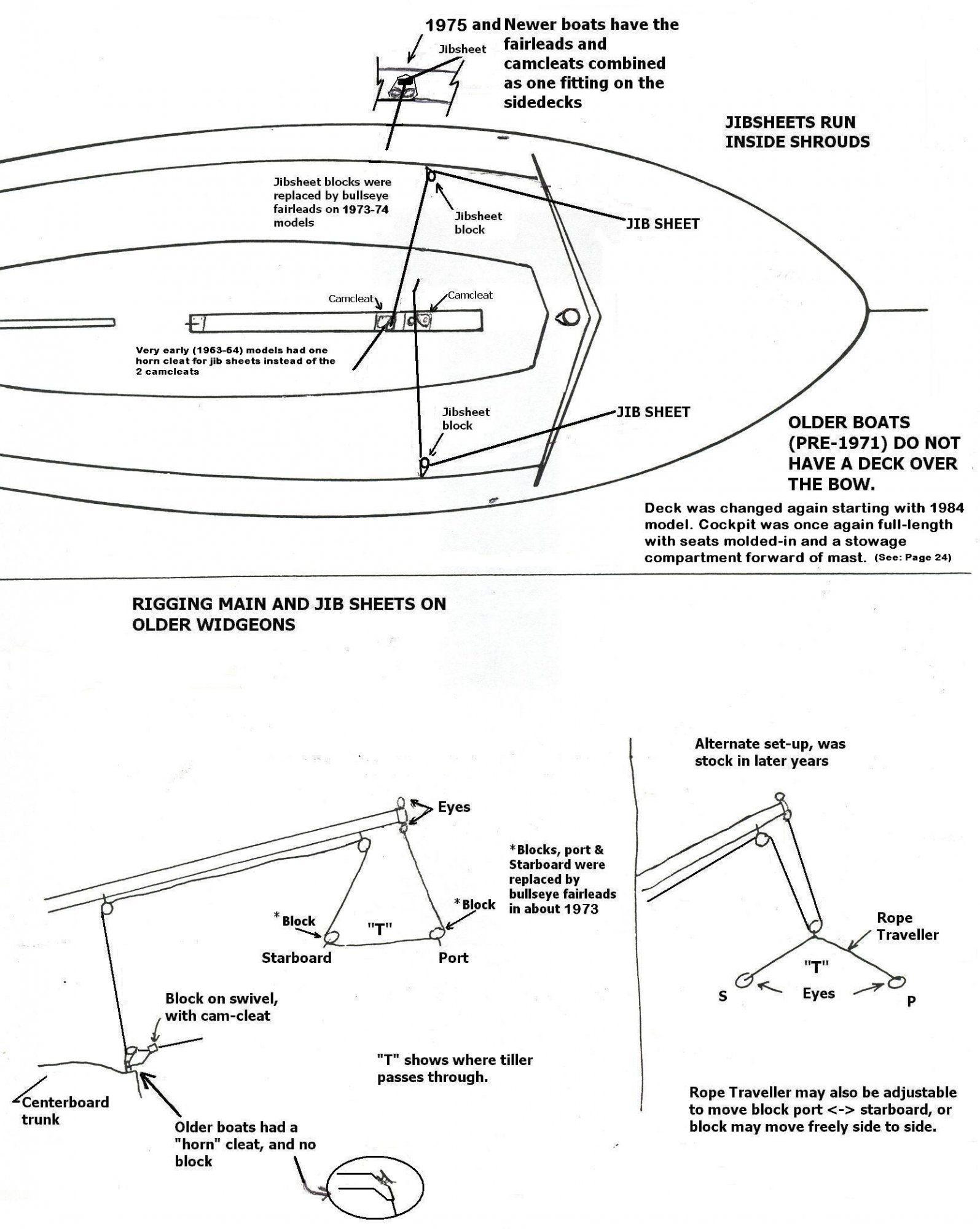

Here are the specs for the Widgeon rigging, taken from my Expanded Owners Manual. The specs are actually from 1979, but matched what I had on my 1969 model which should match your 1965 model. I have attached a diagram showing the rigging of the mainsheet and jib sheets as well. Any other questions? Let me know!!

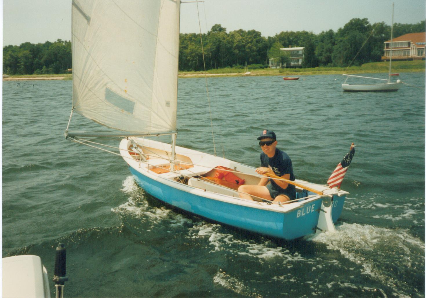

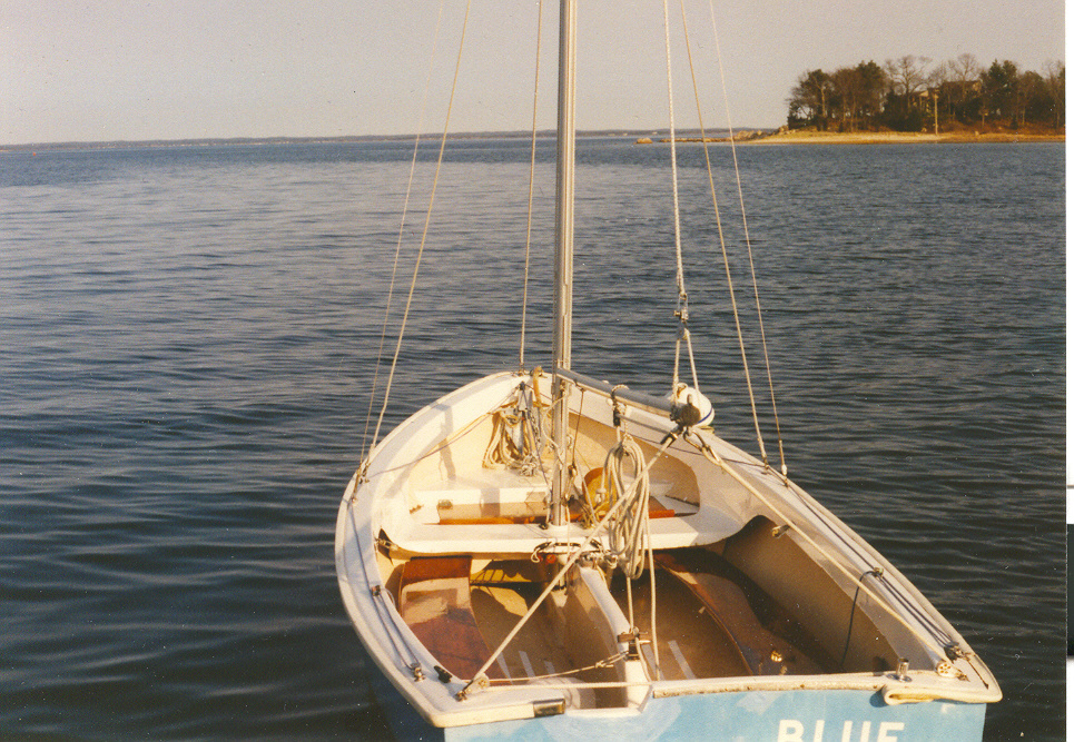

Hello sunbird can you tell me why the mainsheet line is so long Thanks
Jun 2, 2004
1,955
Oday Day Sailer Wareham, MA
?? Why so long?
Well, if it were shorter, you would not be able to let the sail out all the way! <GRIN!>
But, if your boat was set up with an aft traveler as shown in the attached diagram the main sheet may be shorter. That 36' length was the length of the main sheet on my boat, but I had the setup as shown with the triangle tackle at the stern. I have attached 2 pictures of my old boat, one at the mooring showing the main sheet, and one while sailing where you can see how much line is needed when the sail/boom is all the way out.

I get it now instead of one line going out when letting the sail out there is actually 2 lengths going out
