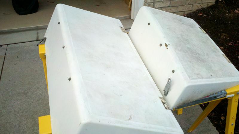

My boat originally had those spring type locker cover supports. They never worked right and would bend, then break. I have my covers home for painting and think I will simply glass over the holes. Or maybe you have found something that works.

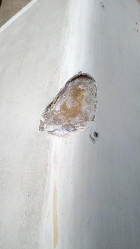

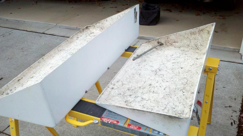

Someone(?) dropped something on the cover and cracked the fiberglass. In grinding it down for repair I find that the curved front edge is actually hollow. I guess from a faulty glass layup? Probably why it cracked so easily.

Ed, I've discovered void spaces between the gelcoat and the FRP also. But haven't been too concerned because I read about it ... Don Casey in his "Inspecting the Aging Sailboat" says:
Because of the numerous corners in a deck mold, gelcoat voids are all too common. It is not unusual to find a boat with a flawless hull and a deck as pockmarked as a rural road sign. Voids in the flat expanse of the deck suggest inferior layup technique; but if they are confined to sharp outside corners of the deck, they show only that the designer was more concerned with the style than the realities of production layup. Deck traffic quickly breaks out sizable voids; so an older boat without open voids means either good design and layup or voids that have been repaired."
And in his book on Sailboat Hull and Deck Repair"
Voids occur when the first layer of cloth is not compressed against the gelcoat ... While crisp angles and corners may look stylish, they are more difficult to mold with glass fabric. The fabric resists being forced into a tight corner and after saturation may take a more natural shape, pulling away from the gelcoated mold. The result is a void -- a pocket of air beneath the thin gelcoat, perhaps "bird caged" with a few strands of glass. The first time pressure is applied, the gelcoat breaks away like and eggshell, revealing the crater beneath.
On my boat, I found lots of small holes and void spaces behind in the area of the sharp ridge indentation for the eyebrow along the side of the cabin top. These became very evidence when I removed the eyebrow prior to painting the cabin top. (And decided that liked the look sans eyebrow better). I spent several hours filling and fairing the holes and breaks. Another bad area on my boat was around the sharp angles for the molded traveler platform. I am sure I've got more voids around. Just haven't been revealed to me yet.

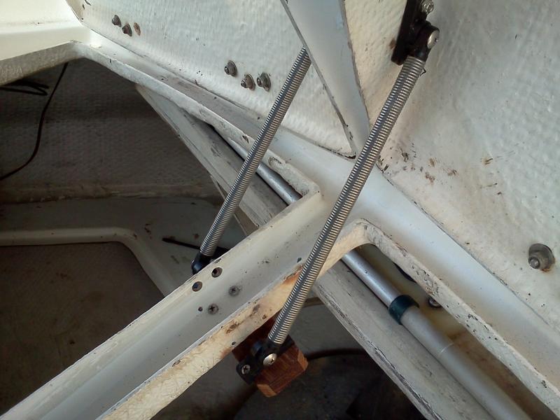

All of mine were missing when I got the boat so I purchased a pack of 6 on Ebay for about 40.00 and installed 4 in the cockpit and one in the nav table. These particular ones with plastic feet must bend in the right direction so I had to improvise somewhat. I still hate to bump them and receive a seat cover on the back of my head so I have a short broom stick that I use for added peace of mind when working in the lockers for an extended time.:)

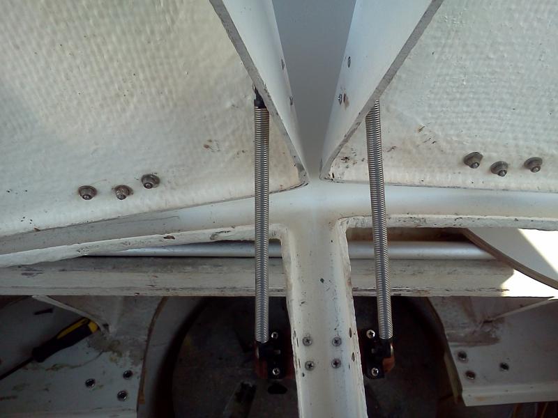

Your pictures with the modification perfectly illustrate the problem. The hinge of the spring has to be oriented in the plane of the bend. Did I just write that? Mine are like the ones that Bill's link illustrates.

When I got my boat both springs were dangling, broken off at the lower end. I bent out a portion of the lower end of the spring and reattached it. Hard metal but doable. It now works great!
23,522
Ed, I use the small springs for our nav station lid, the fridge top (added our own hinges) and to top of our engine "box." If I needed them for our cockpit lockers, I'd get the heavier duty ones. I believe they come in three sizes.
I particularly liked your "The hinge of the spring has to be oriented in the plane of the bend." phrase. You might ask them to include that in the instruction manual! :):):)
What we've found is most people don't know how to use them - they force them closed, and one of my "friends" broke my nav station spring, requiring replacement. Of course, the holes on the new one didn't match the old holes...
Often, people will inadvertently clip them with their arms and the springs collapse (as they should!). That's the real advantage of the gas struts, but if you teach your children well, no one'll get hurt...:)
