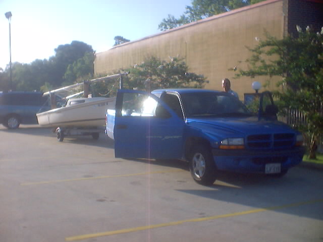

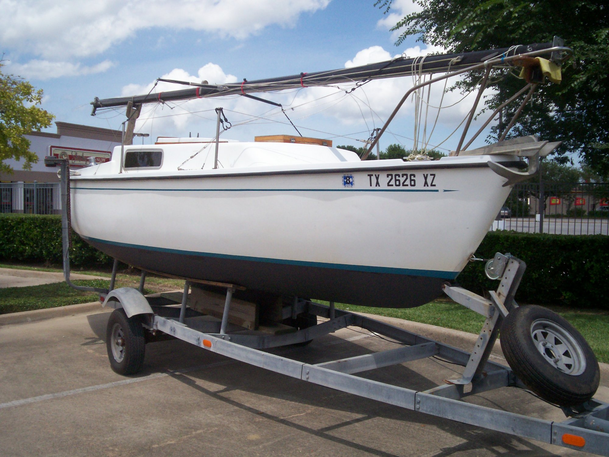

Always strapped this one down which you can barely see in this picture. Boat was so light I could move it on the trailer by myself.
I never strapped this one down and I always towed it like I didn't have brakes on the tow vehicle.
This one I have not yet towed so it hasn't been strapped down, YET.

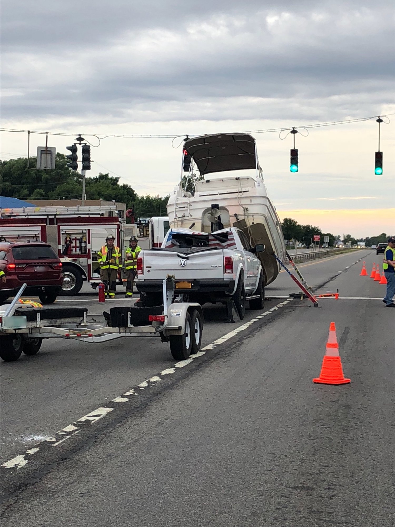

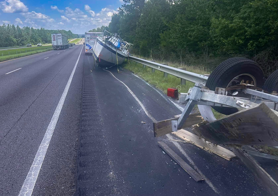

Do you ever see a truck with cargo that is not strapped or chained down? It is sort of ... illegal not to and points on your license if it is spotted.
Yes, many boaters do not strap boats down. A good many make the news. I think most of us have seen one of these, most of us several or many.
