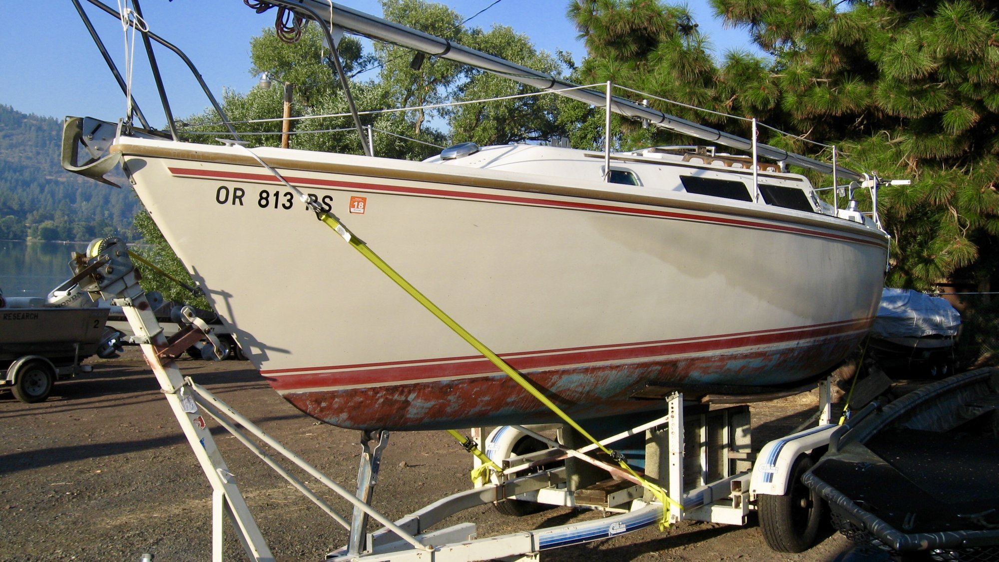

I don't think I have ever seen tie down eyes on the transom of any trailer sailor, but if I were going a long distance I might consider running a long strap from the trailer, up and over the cockpit. Also, when the previous owner helped me to bring my Catalina 27 to its current location (about a 100 mile trip that he made with the boat each year), he tied down the bow and the stern, similarly.
Having said that, I was once at a boatyard and the manager pointed out a MacGregor26 on a trailer with a strap exactly as I described, but with horizontal cracks in the hull right at the straps. He said, "That's what you get with a McGregor", explaining that it didn't have enough strength in the hull to withstand very much pressure. He didn't say the owner should not have strapped it, but rather he thought it was a combination of being too tight, given the lightweight nature of the fiberglass and the bouncing a trailer might encounter enroute.

Definitely tie it down. Use two on the stern, one on either side and an additional tie down at the bow. The trailer winch is not a good single method to secure the boat, too many ways that can go wrong.
I prefer not to use a ratchet strap; it is too easy to put too much tension on the boat. I use the cam lock straps and if at all possible, run them pulling forward on the trailer to help keep the boat up against the bow chock. Try to avoid very short lengths. A short strap does not have room to stretch and can damage the hull or pull-out fittings when the trailer flexes or the boat is jarred as it travels down the road.

When taking it from the marina to my house that is less than 3 miles away, no. For longer trips, yes. Something reasonably hefty with ratchets.

I use two ratcheting tie-down straps. One over the cockpit to the frame and one over the foredeck in front of the cabin top, to the frame. The forward strap catches a cross rail on the trailer too hopefully not allow forward movement

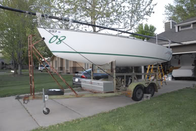

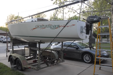

Line from the trailer upright through the guide to the bow cleat and locked then through the other guide and down to the trailer on the other side and secured. Same drill at the stern. I had eyes welded to the trailer uprights. Tens of thousands of miles trailered that way.
