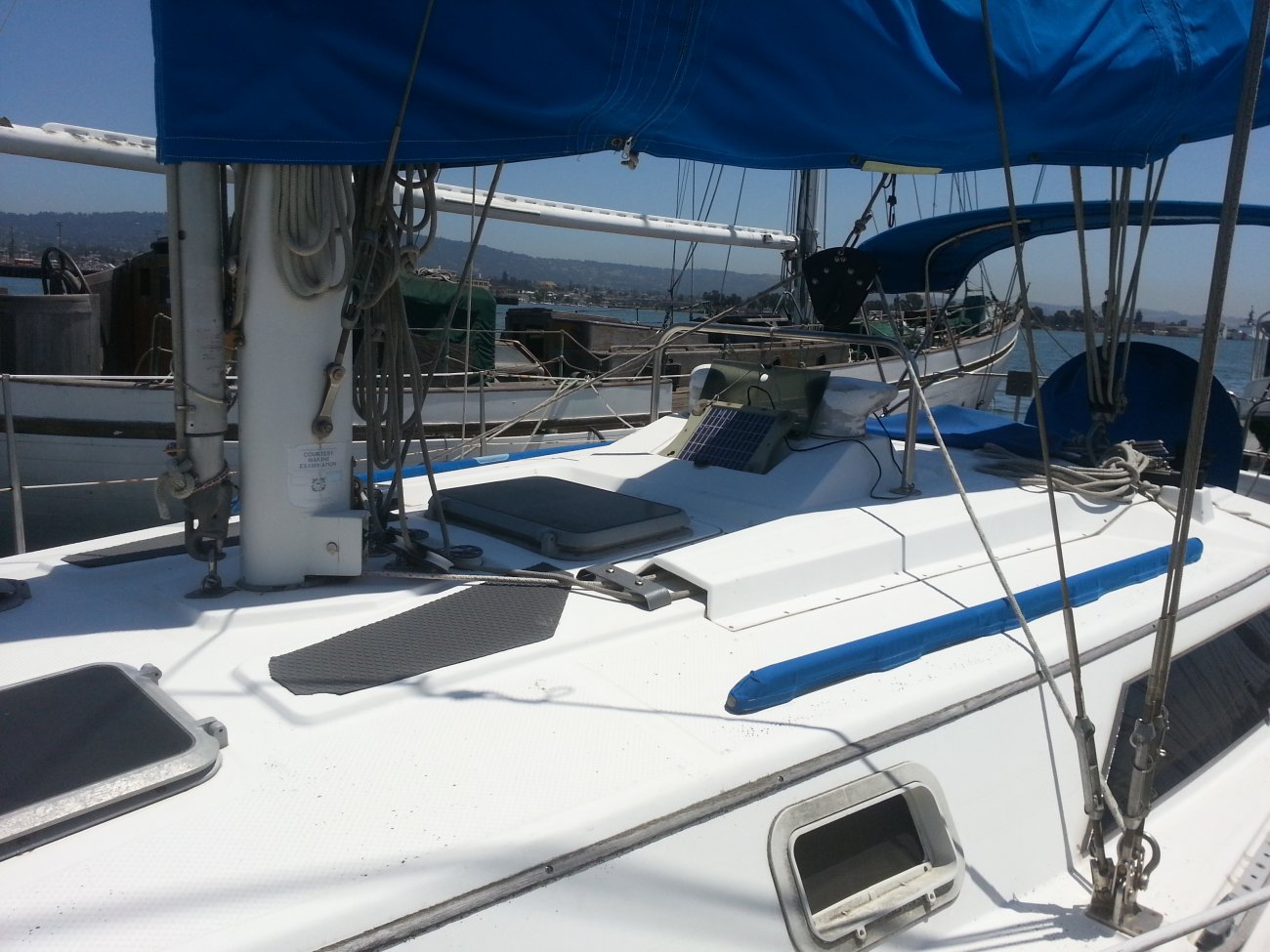

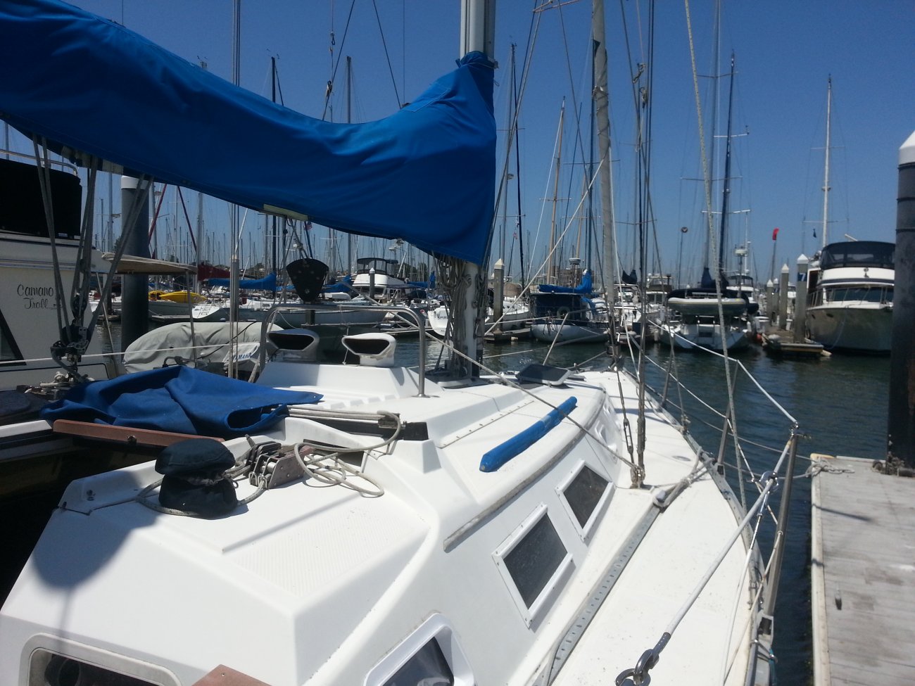

Hunter 34 Alameda CA
I have experienced accidental gybes. Luckily no serious injuries or equipment failures. My friend broke his boom on a Hunter 466 sailing from Half Moon Bay to Santa Cruz. He was trying to sail DDW and figured the autopilot would be fine. First wave that kicked the stern over and that was that.
In my case and in most others with the B&R rigging or swept back spreaders we always reach downwind anyway because I don't want to wrap the main into the spreader tips. That stays more in the boundaries of the cabintop traveler. We try and stay as far away from a gybe position as possible. And I have had a Dutchman Boom Brake for a long time. It saved us on a number of occasions when we started surfing while sailing the same route with our friend who broke his boom. Once we started to surf, we lost control and even from a broad reach we got kicked around into a gybe. The boom brake did its job. From the picture you can see how I rigged it. There is a fixed length line with an eye splice at each end that is shackled to the chainplate (replacing the clevis pin). I repurposed my vang as a cunningham with a hook through the flattening reef cringle. A separate control line is attached to the shackle on the boom brake that runs up and under the boom, forward, then down the mast, through the seahood to a sheet stopper on the starboard cabin top next to the winch. I can elevate it easily applying the required brake tension. It self centers under the boom. After a controlled gybe, I ease the control line and it follows the fixed line over and below the boom again, then I re-tighten. It also serves well as a replacement vang when I can keep the boom down. That even works upwind in really light air when every little wave bounces the boom up and down destroying sail shape. If I can keep that from happening, we can keep moving albiet slowly.
