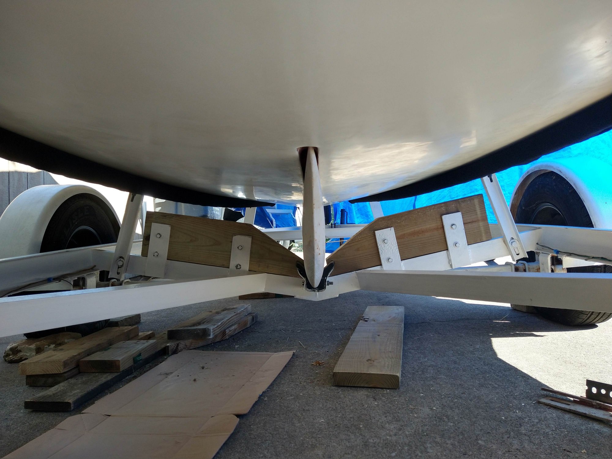

The photo is named "bottom job." What was done?

The photo "bottom job" is the current condition, just plain original gelcoat.
