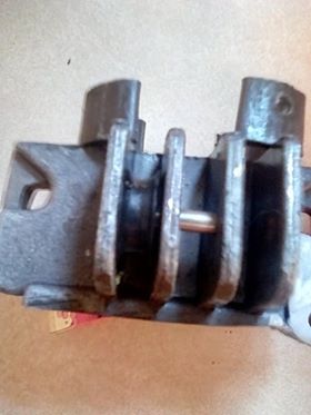

The sheeve at the foot of the mast is broken. This is a pic of the mast foot when it was off the mast. Can you tell me how to replace the sheeve?
@Dhamil6490
The photo is too low resolution to see any detail, so it’s not much use. Please post higher resolution pics with both a side and a front view. Like I’ve already said at least twice, we can't help alot unless your pictures are bigger, in focus and well lighted!!
But the general approach would be as follows. Remove the pin. Remove the sheave. Measure the inner and outer diameters and the width. Use calipers. You can get plastic calipers for less than $5. Get back to us with a high res picture taken in good light, so we can help you locate an appropriate replacement.
Inspect the pin for wear and straightness. Inspect the hole in the mast foot for wear. Uneven pins cause the side of the sheaves to rub against the cheeks and cause friction, side wear on the sheave and chafe on the halyard.
Get back to us with high resolution big pics of the parts. show at least two views from different angles, around 90 degrees apart.
Sorry for the low res. It's the best I can do. Your general instructions are helpful.
