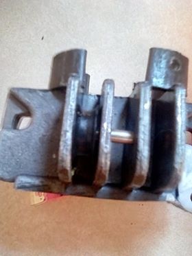

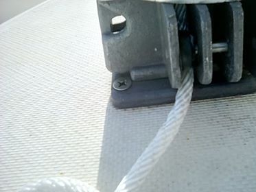

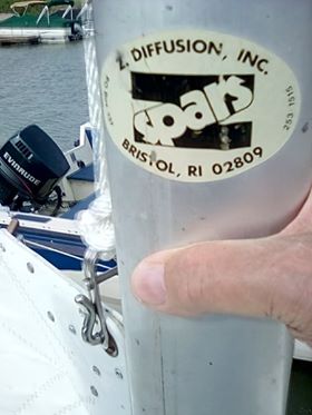

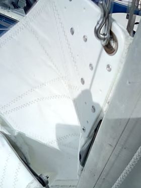

Hi, Judy. Correction: it has 5 full battens. The age of the sail is unknown. When I bought the boat, it hadn't been sailed in 3 years and it had been stored outside with no cover. The main was packed in a bag and folded neatly. It was stored in a garage, but unused in 3 years. The apparent condition of the main is good. It has no holes or other damage, and it looks like nylon but I don't know for sure. The bolt rope shows a lot of wear, but seems solid and intact. Some photos attached.

HI, @Dhamil6490
those pics of the headboard are useful, but I still need to see what the bolt rope looks like and the batten end boxes at the luff look like. Please take several pictures of the luff showing bolt rope and batten boxes. Please put A small ruler in the picture so I can get a sense of the dimensions.
Also pictures of the top two battens when they are inserted into the mast. Hoist them above the feeder area so I can check for clearance between the batten box and the bolt rope.
Also a couple of pics of the bolt rope so I can assess its condition please
All photos high resolution please.
