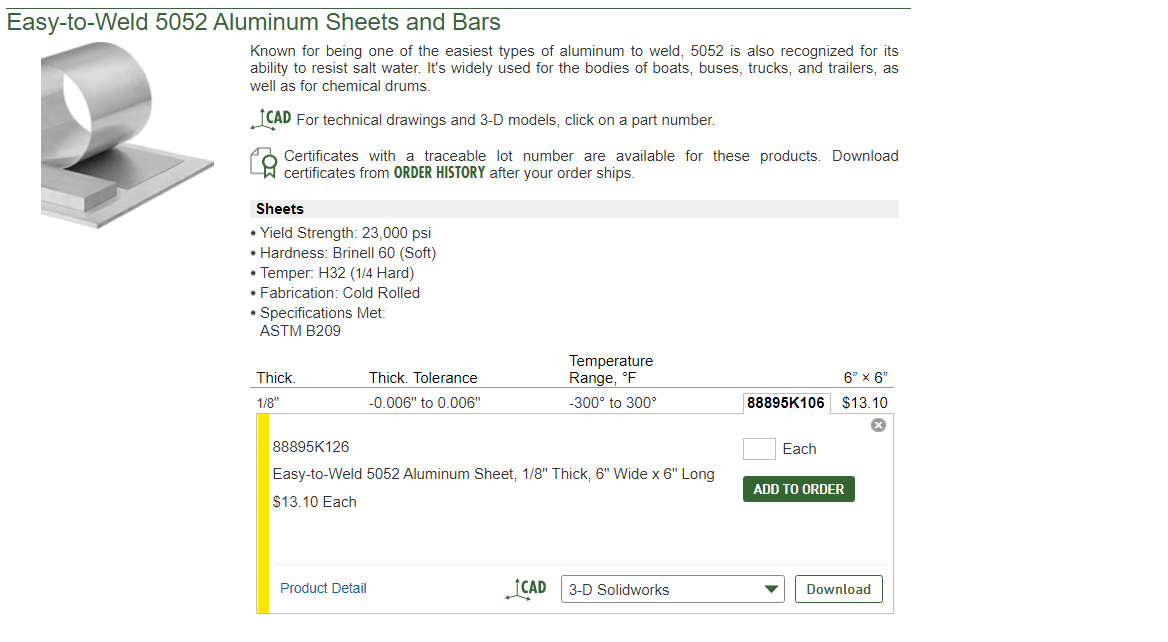

We had a C30. I also opened the fuel tank and considered how to clean the tank. I decided that the fuel gage access wasn't big enough. I added an inspection port using a 4" hole saw and a 5"-5.5" top plate with diesel resistant gasket material. If you go that way, the hole saw generally cuts a little bigger. The top plate was 1/8" aluminum from McMaster Carr. I carefully laid out the holes and used a transfer punch to get the exact hole location on the tank. Then threaded the holes followed by complete chip cleanout. Never had a leak.
Do you by chance have the part numbers for what you purchased so I can see what you got?

Used #10-24 machine screws (tap drill #25 [5/32"], 5/32" transfer punch (3374A16). Screws can be any style- hex head, flat phillips head. Drilled cap holes as 5/32" then transferred positions to tank. Tapped tank and opened cover plate hole for screw clearances. Alum cap was cut from info shown below. Bought gasket material at local auto parts store.
