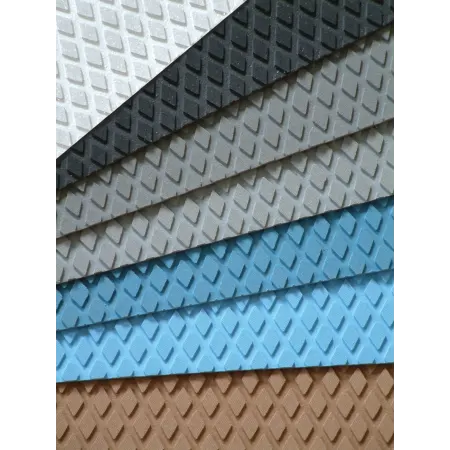

Or would having faux teakwood or anti skid epoxy make a better solution?
13,031
Or cover over the bulk of your deck with rubber decking and only dremel out and fix the cracks on the gunwales etc. There are also some anti-skid paints that you could cover over much of the deck's surface
