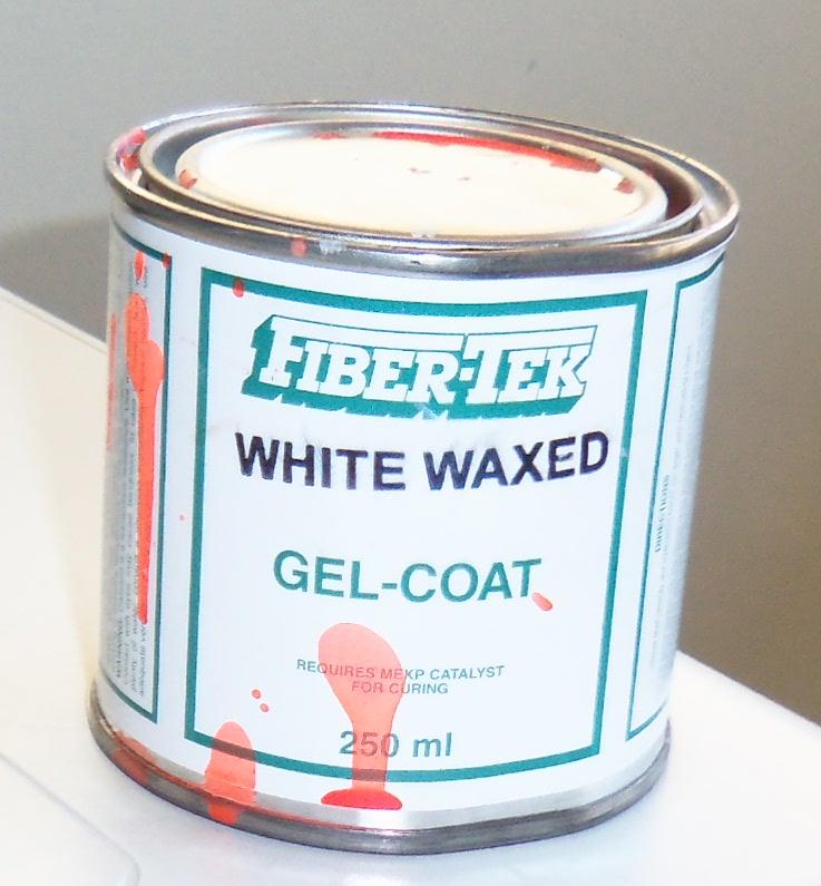

I've had this in the fridge for about five years now and do a few spider cracks each spring until I get bored, which is becoming less and less each year. Repairs are invisible.

The gel coat is referred to as "waxed" as shown on the can above. It hardens in air, without a covering as the wax goes to the surface and protects against air. Same applies to polyester resin.

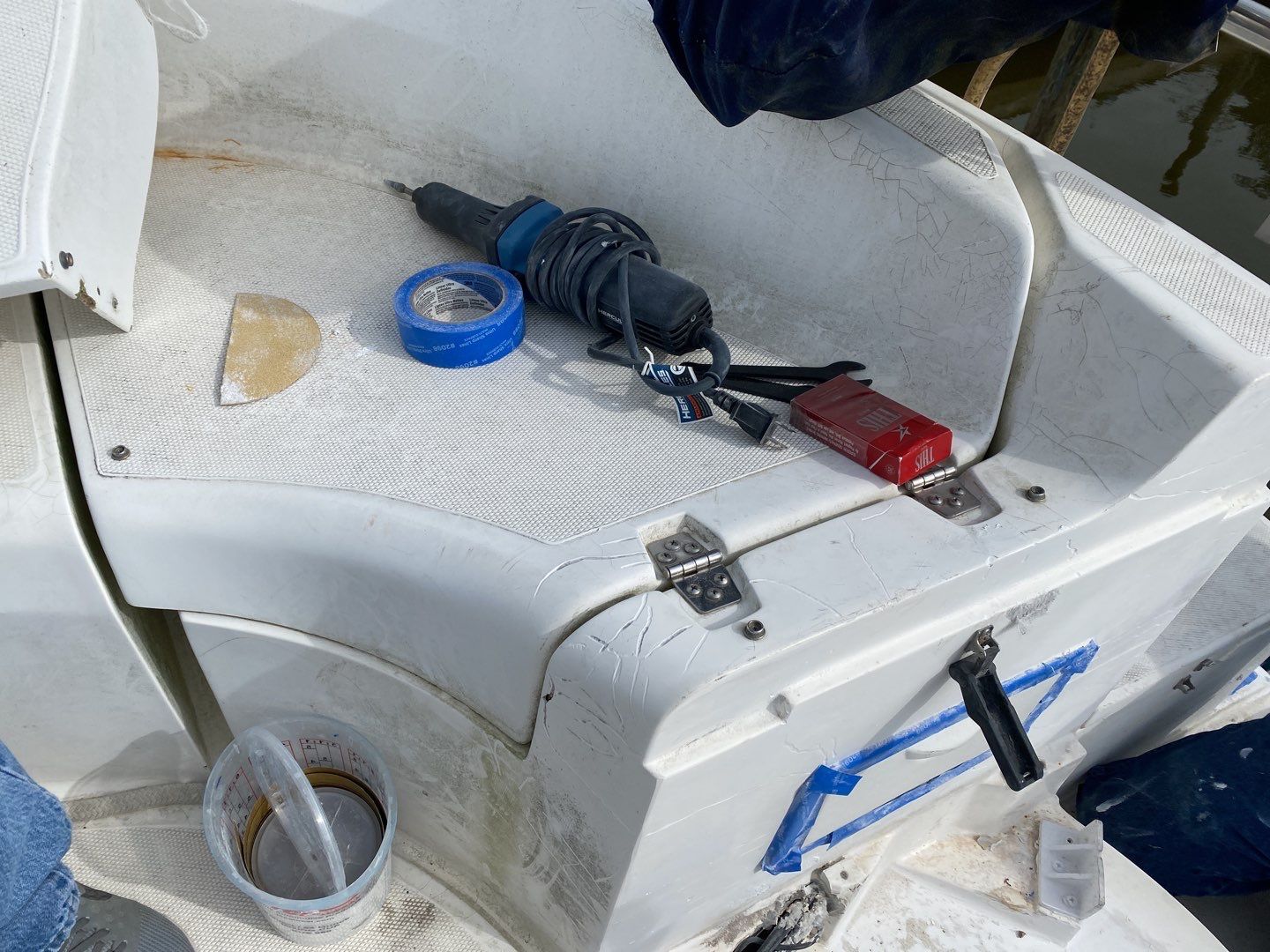

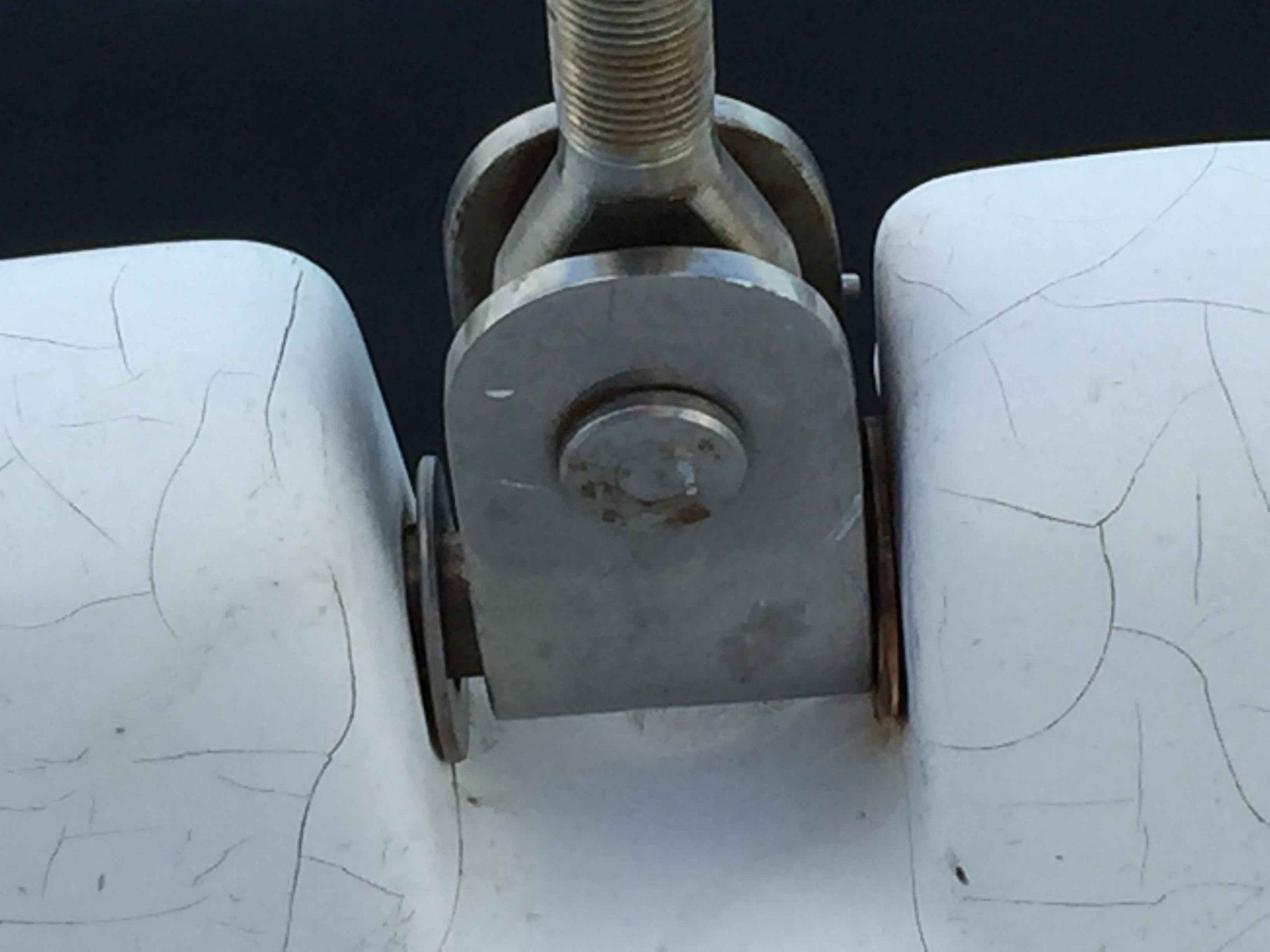

I thought I would up date this older thread to provide some new input.
Many people note on older boat that they see ...
Gel Coat Stress Cracks [aka Spider Cracks]
This are normally seen where steep curves in Gel Coat occur.
Examples of a Before in my pict library...
Due to unfortunate damage to our boat, we have time, on the Hard, to have professionals remove the UGLY cracks.
But @Ralph Johnstone post #7 and it's links shows how professional Ralph is.
Just like our professionals are doing !!
Grinding out the GC cracks with a Dremel type grinder.:)
Then adding a filling compound, that I will find out the type and update.
Zoom in to see the now filled GC Cracks.
_____
They ordered matching Gel coats [Blue and White] which I will up date the Hunter's chart above by Spectrum.
I will talk to the pro's today and get their full procedures for the DIY's here on the Forum.
Jim...
PS: The Yard is providing the professional labor. We are watching the progress and these Pictures are by the Yard.:biggrin:
