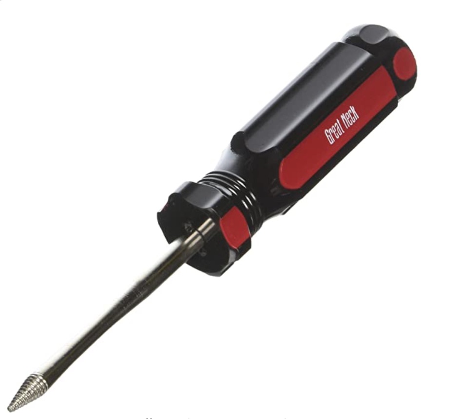

I have had something similar to this for decades... also on Amazon, a "screw starter", this one is $9 and it's about the size of a phillips screwdriver. I use mine for small jobs, starting holes for just one or two small screws (like, for your fire extinguisher bracket), etc.. I just used it on the boat the other day.
