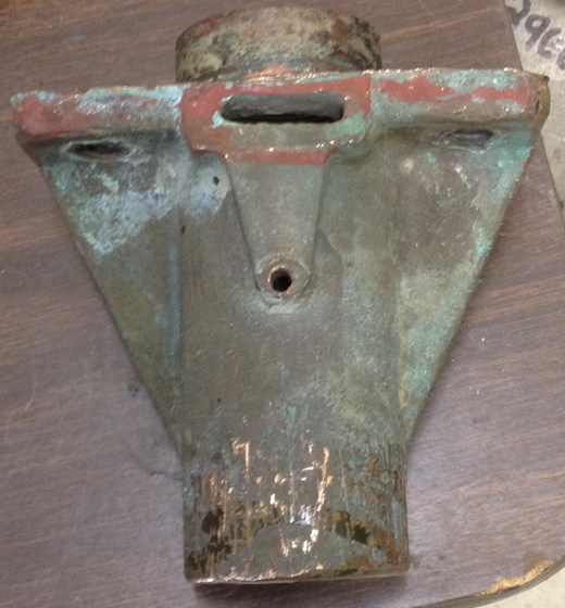

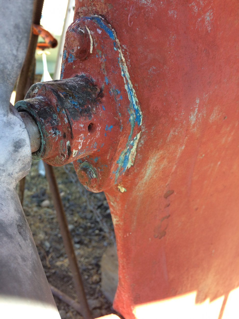

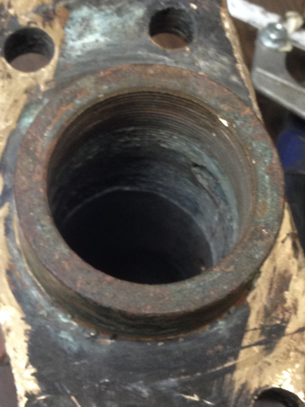

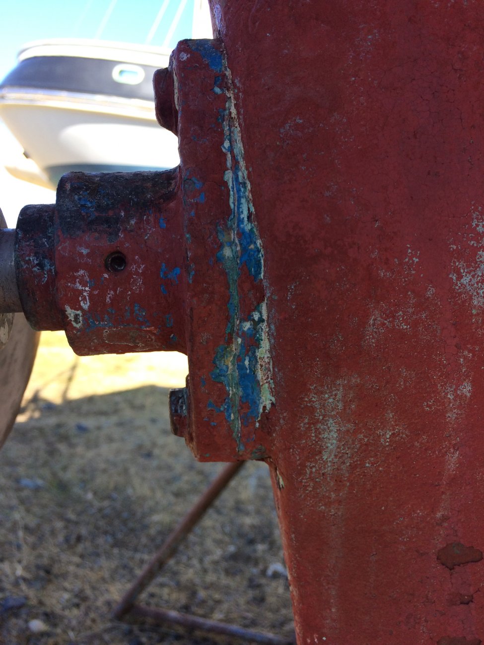

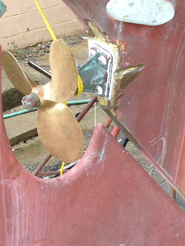

Mine had me stumped as well. Had 4 bolts. Removed them and nothing. I finally figured out it was screwed into the shaft log. The bolts kept it from un-screwing itself! cutlass

My Albin Vega has the same type of arrangement, only the bearing isn't screwed into the log like @bletso. I just remove the prop, remove the two retaining bolts, and the bearing comes right off.
