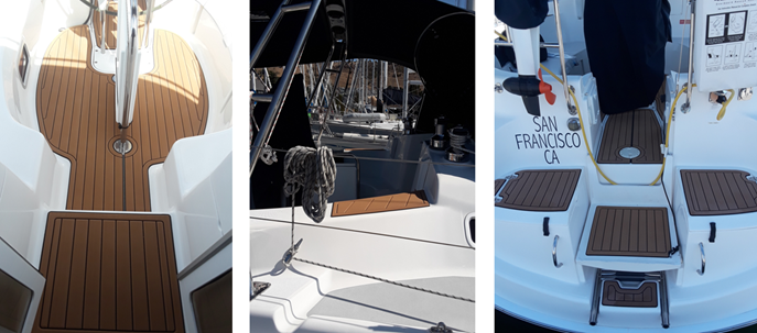

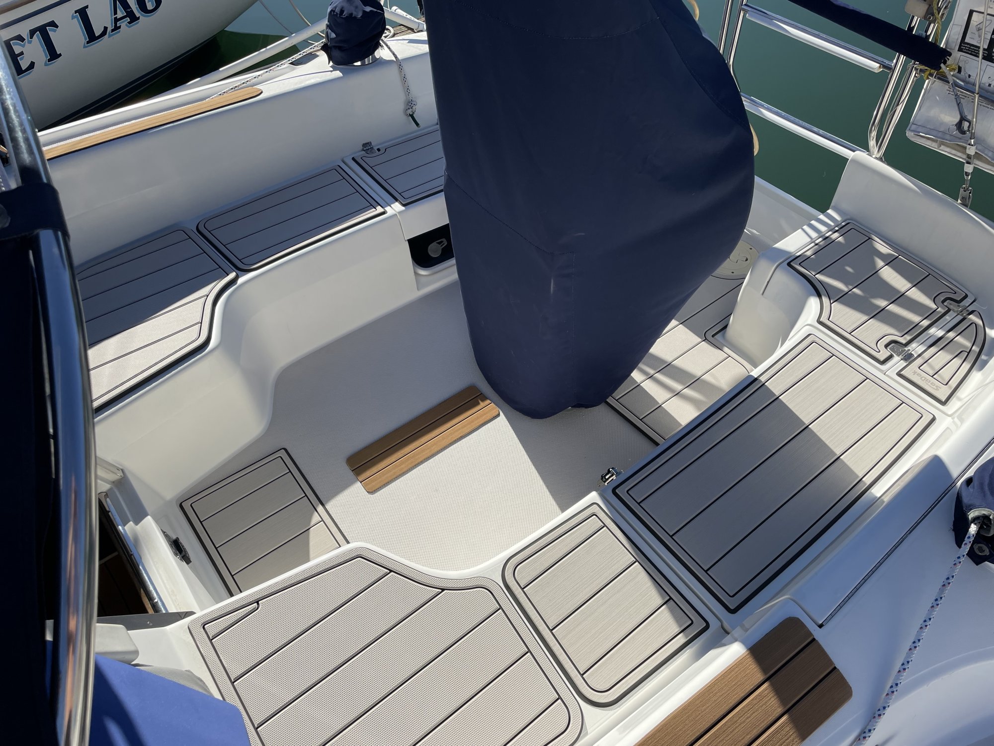

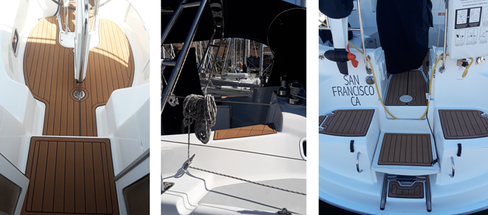

They’ve got a few options. You can buy sheets/rolls of it yourself, which I did with my previous Catalina 22. However, for this we did the *do-it-yourself* custom option where seadek sent me sheets of plastic film; I cut and marked it out; sent it back; they sent back design templates based on my sketch; I confirmed them; then it finally went to production. There were tons of color/thickness/pattern options during the process. The instructions were simple, and the service was great. It took about 4 months from start to finish. And you aren’t fully financially committed until just before they send it to final production. I opted for the 3 yr warranty where they say they’ll send an entire new kit if there are issues (fairly liberal criteria).

It sure looks great. What did it cost in the end if you don't mind sharing?
is that like a 5-6mm, grey over black and they cut the grey to expose the black?

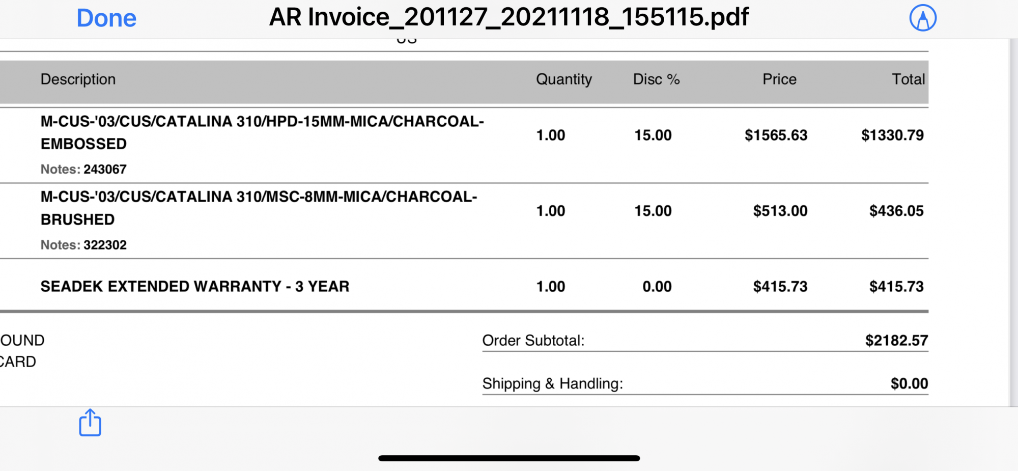

8mm in most parts, and some padded areas of 15mm at helm pad, and the two pieces near the winches where we kneel a lot. Here’s the break down including the warranty. I think it was 15% off for a military discount… but it was so long ago I can’t remember.
