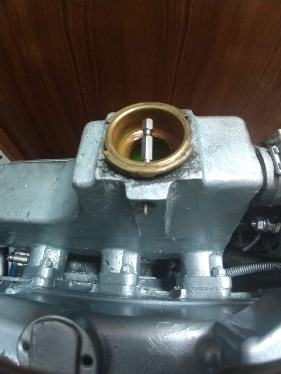

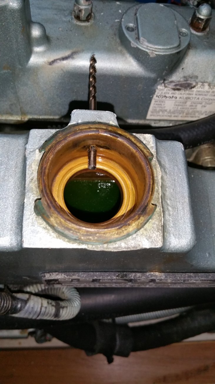

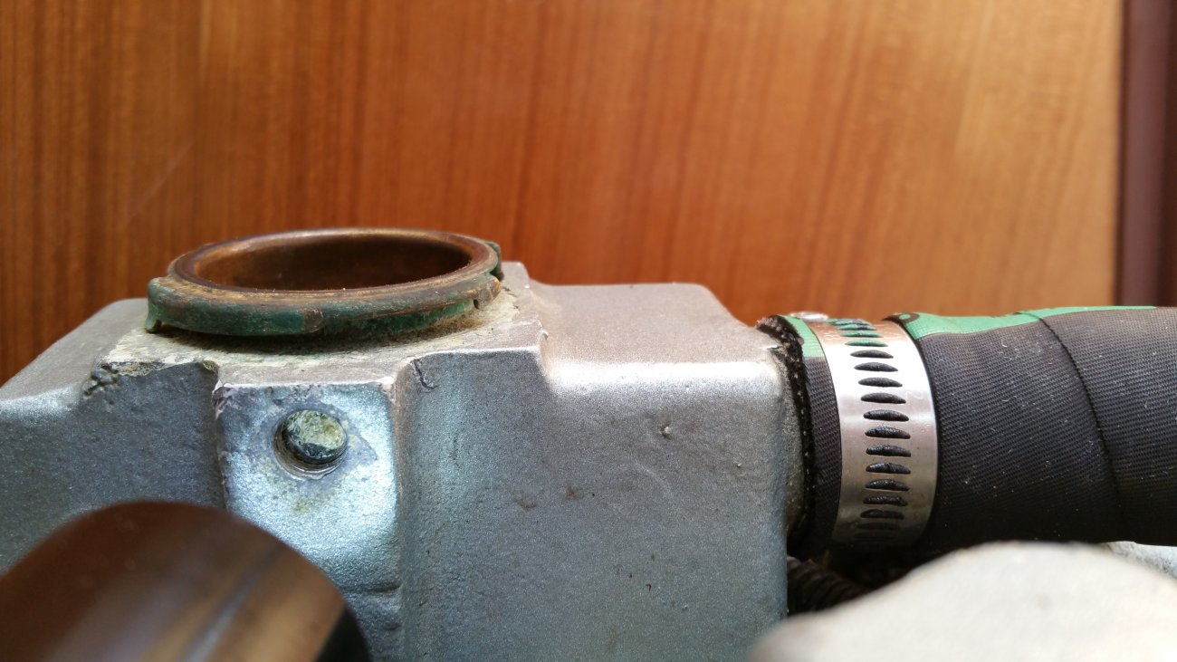

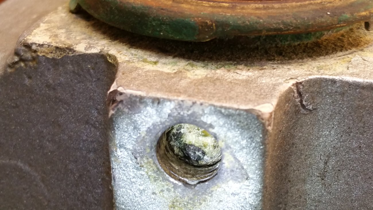

I bought my boat in Jul 14. I'm the third owner. The level in the tank never moved, not even when I drained the fluid from the manifold to change it. I investigated, and found the hole in the fixture where the hose plugs into the manifold doesn't go through. It looks like it was never drilled out. The face is totally smooth. In the picture posted by Paulj, it looks as if some foreign material may have plugged the hole.
Paulj, what size drill bit did you use?
What did you do for a hole ?

I've lived without one. That being said, I'm planning to drill out now that I know someone else did so and the diameter of hole they drilled.
The good news is the recovery take level stays remarkably consistent. The bad news is the cap on the manifold must be removed to check the coolant level.

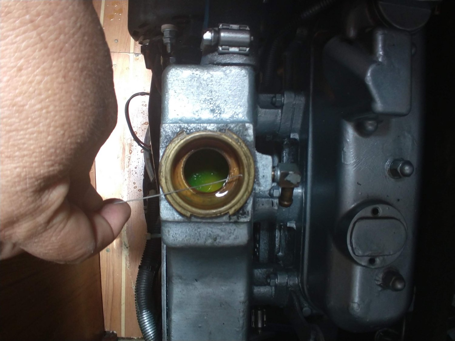

My advice do not drill the hole.
So many others have not responded to not checking to see if they have a hole drilled thru.
I did not have a problem for 12 years but I just had to drill the hole :yeah:.

I say drill the hole. Lack of a hole is an oversight by the manifold manufacturer.
Here is a schematic of a radiator pressure cap. The cap can't work properly without the hole. Your leak may be due to the system becoming over-pressurized.
Note there are two valves, both ported to the overflow vent on the left: a pressure valve and a vacuum valve.

After drilling the hole, does it work, as advertised?
May 20, 2016
3,015
Thee overflow tank wasn’t bringing fluid back into the manifold. Then I realized the cap only had the pressure valve and no vacuum. Trip to Napa cured the problem
