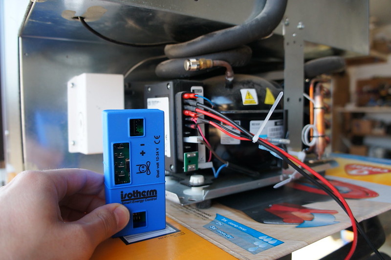

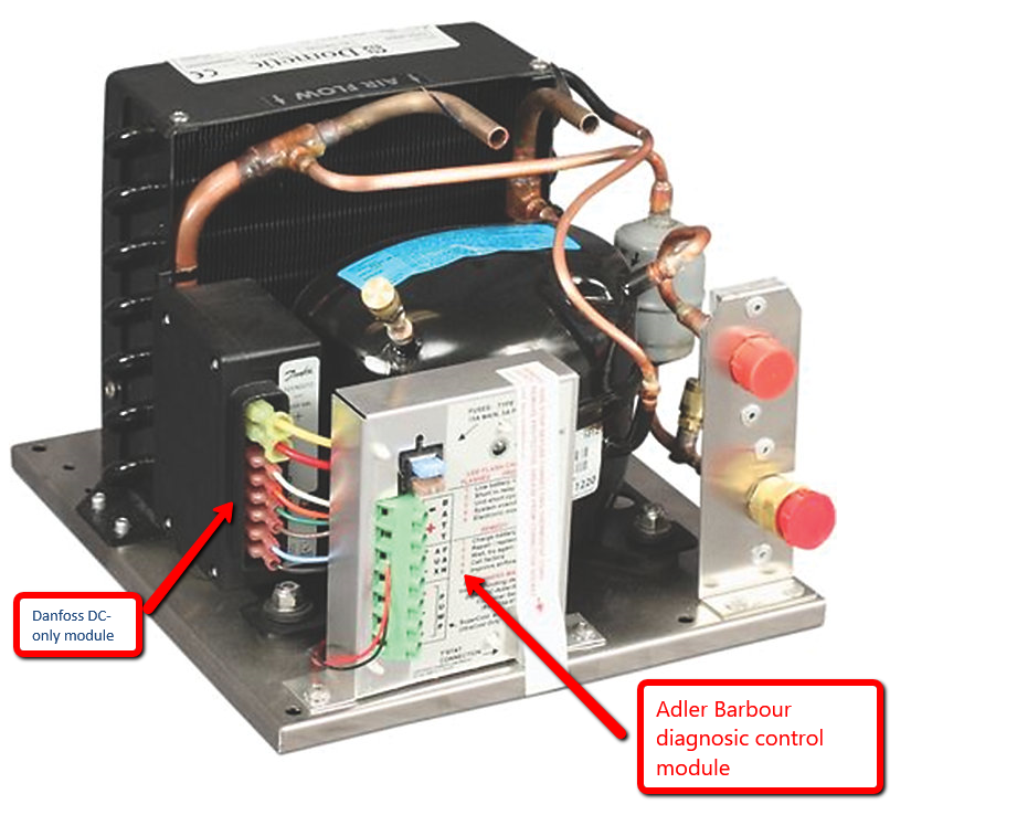

I got a response from Isotherm and they said I can connect to my compressor using the Danfoss control module which is the black unit behind the aluminum diagnostic module. They didn't mention whether I needed to bypass the AB control module so I will update when I hear back from them.
You disconnect the wires off the Danfoss control module (black controller above, back of and to the right of the new controller) and ....
The new controller has spade terminals on the pack of it that allow you to ...
.... install the new controller where the wires were on the Danfoss control module. Then hook up the required wiring to the isotherm controller as explained in the manual posted above.
Here is a link to the site where the photos above came from...
http://vagariesabound.blogspot.com/2016/03/spring-update-5.html

You are correct, the AB module goes. In fact, it doesn't add much value, in fact, even the diagnostic blink codes come out of the Danfoss controller that it front-ends. I haven't found a schematic or examined one, but I infer it just adds the LED (that could also be plugged into the Danfoss box,) a three fuses and a connector for the thermostat with wires for digital thermostat power. It is also a failure point, as folks have experienced burnt PCB traces from power supply current, and other things.
