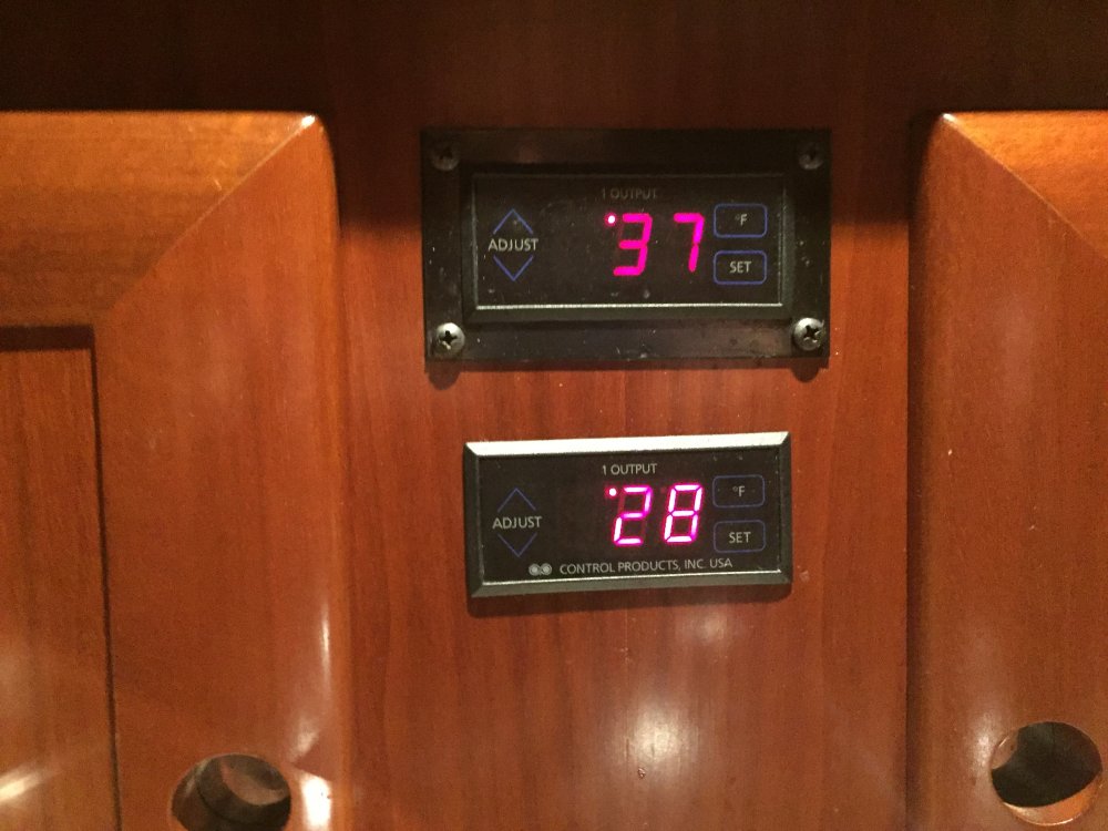

I have a AB ice box that feeds the refrig..... on mine I have two separate controllers made by Control Products Inc. seem to do a good job......
