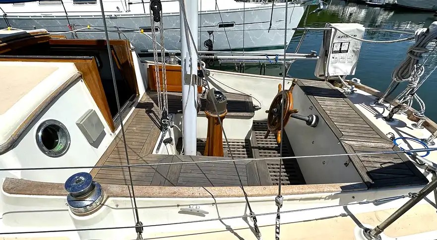

Ugh ... I think I have just about resigned to a complete cockpit makeover. When I bought this boat (about six weeks ago), I knew I had some teak repair to do in the cockpit. There are a few split pieces and the overall look is shabby. I figured I would replace the bad pieces and recaulk and sand everything, and I would be basically happy with the results.
Last week, I removed the floor grating, repaired, cleaned, etc. and they look great/grate. (The picture shows the "before" state.) And, I've started to renovate the toe rail with really nice results. So, this makes me start to be a bit pickier about the state of the cockpit seating and locker lids.

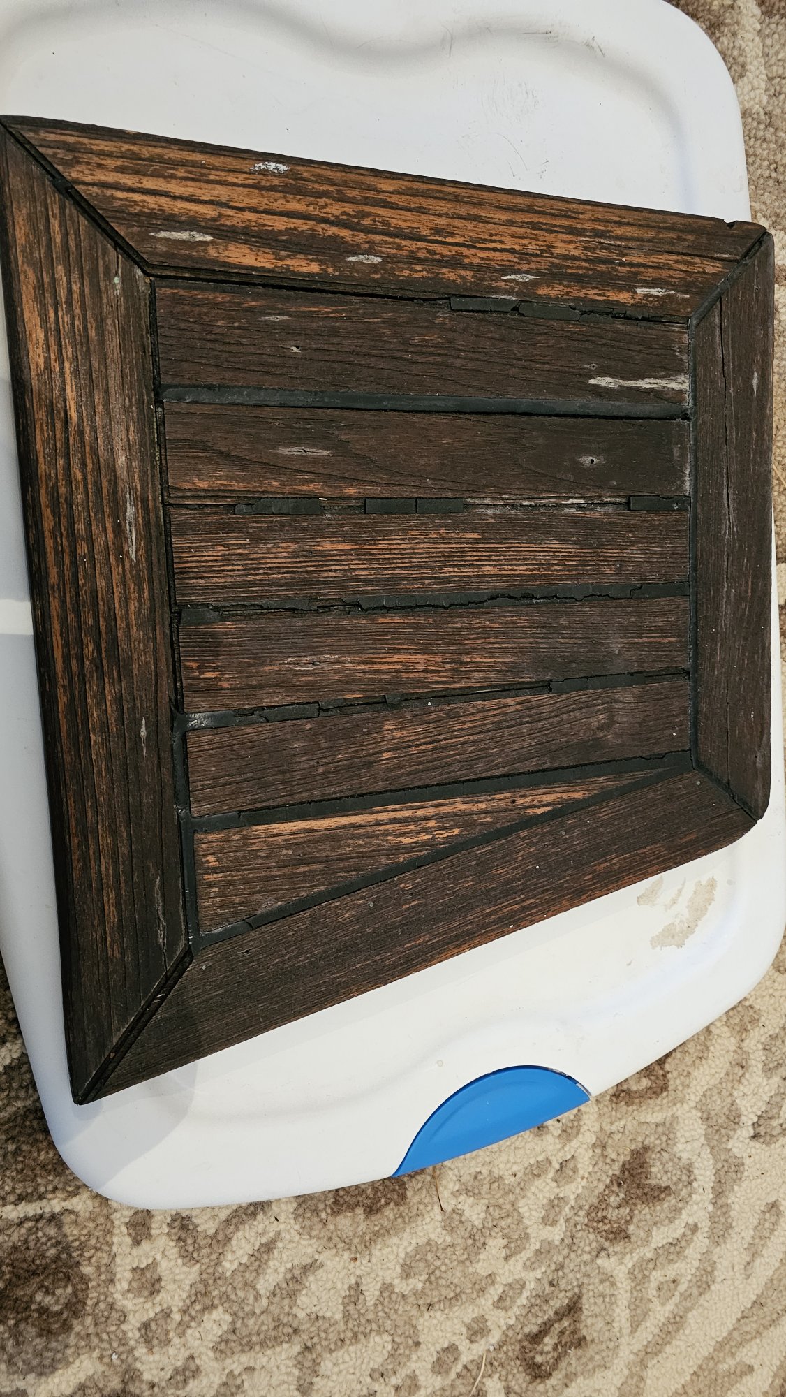

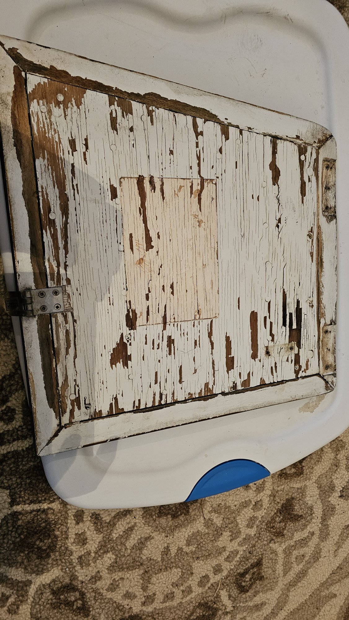

So, I removed the aft-most portside locker lid and brought it home to get a sense of what I was getting into. It is pretty typical of the state and construction of the other locker lids. About half of the teak decking strips you see in the photo are attached to plywood to form a locker lid. The other half is screwed directly down to fiberglass.
I disassembled that small lid (in the photos above), and found all wood to be in questionable condition. I initially thought that I would just replace the substrate plywood and rebuild the lid using the existing teak. But, that is looking less feasible. I am concerned that, although I might be able to do that in some places, I wouldn't be able to do it consistently throughout the cockpit, resulting in an inconsistent patchwork.
So, I am considering the idea that it might be easier to completely rebuild from scratch using new wood - maybe just keeping the most viable pieces of the original cockpit. I do want to keep the appearance of teak, to be consistent with the style and vintage of the boat.

There is a mystery that I'm keen to solve, though. If you look at the picture of the cockpit - on the forward edge of the cockpit, there is a bulkhead with a small round port. Inside, on the bottom edge of that bulkhead, there is something like teek veneer plywood with old water damage along the bottom edge - right about at the level of the teak decking in the cockpit. (The source of the water was rectified some time ago, but the damage is done.)
My assumption has been that the decking had some water incursion that seeped into the core material and wicked over to the interior of the bulkhead. But, looking underneath, there does not seem to be a seam in the fiberglass between that bulkhead and the top of the cockpit seating. It appears to be either a single molded piece or the seam was well taped. But, I can't get an unobstructed view from below, so I'm not sure exactly what it actually looks like.
As with most boat projects, this will be a can of worms. When I get the decking off, I will find out how water made its way into that bulkhead interior. Which means I will need to address that. And, having addressed that, I should just replace that interior surface. And so on ...
What really has me stumped about that water damage is that it definitely was resolved, somehow. Water is (almost) definitely not leeching in there anymore. Since the cockpit appears to be original material, I have to assume that someone just rebedded and/or recaulked some of the cockpit, and that stopped the water.
If that turns out to be the case, I am going to fiberglass over the area before putting the new decking down. I don't want to cover a permeable seam with teak. Water WILL eventually find its way back into that seam.

By the way, I just came in from the shop where I tried to clean up the pieces of that small locker lid. That pretty well seals my fate - that I won't be reusing the existing material. I think that I would be lucky to salvage about half of the existing wood, and even then, I would have to repair a bunch of dings around screw holes and such. It would never look great.

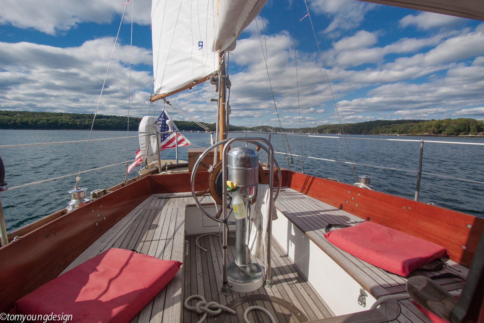

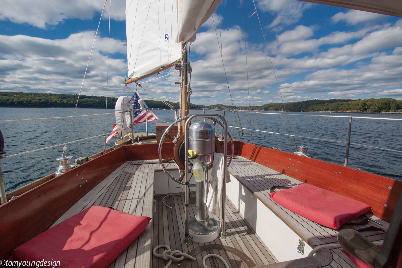

Teak isn't your only source for decking. Custom boat builders are using tropical alternatives like Meranti that are sustainable tropical hardwoods and much more affordable.
When I built a new cockpit for my fiberglass Alden, I used Ipe. I don't believe I paid more than 1k for all the Ipe stock that I milled into decking.

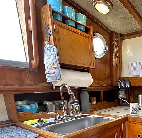

I would be suspicious of the extended wood coaming around the companionway entry. It looks like a small seam directly below the port side lower corner and the hand hold in the interior photo, and that seam is also discolored. Another possibility would be the instrument (?) mounted between the round port and the companionway. Once inside, the water could just spread laterally behind the trim at the lower edge of the panel.
Apr 25, 2024
828
Yeah, on the inside, the water damage looks more or less consistent. That is, the discoloration is roughly the same all along the width of the damage, making it seem like it has a single cause. But, having contemplated this for a while, I'm betting I find at least to causes, and I suspect the same two locations you pointed out. I think there might be a third at the extreme port edge. That could be caused by any of about 3-4 holes in that neighbourhood.
Since the cabin is cored, water could easily wick some distance from the original point of ingress, as you point out.
This winter, I will be removing that interior surface and a whole new can of worms.

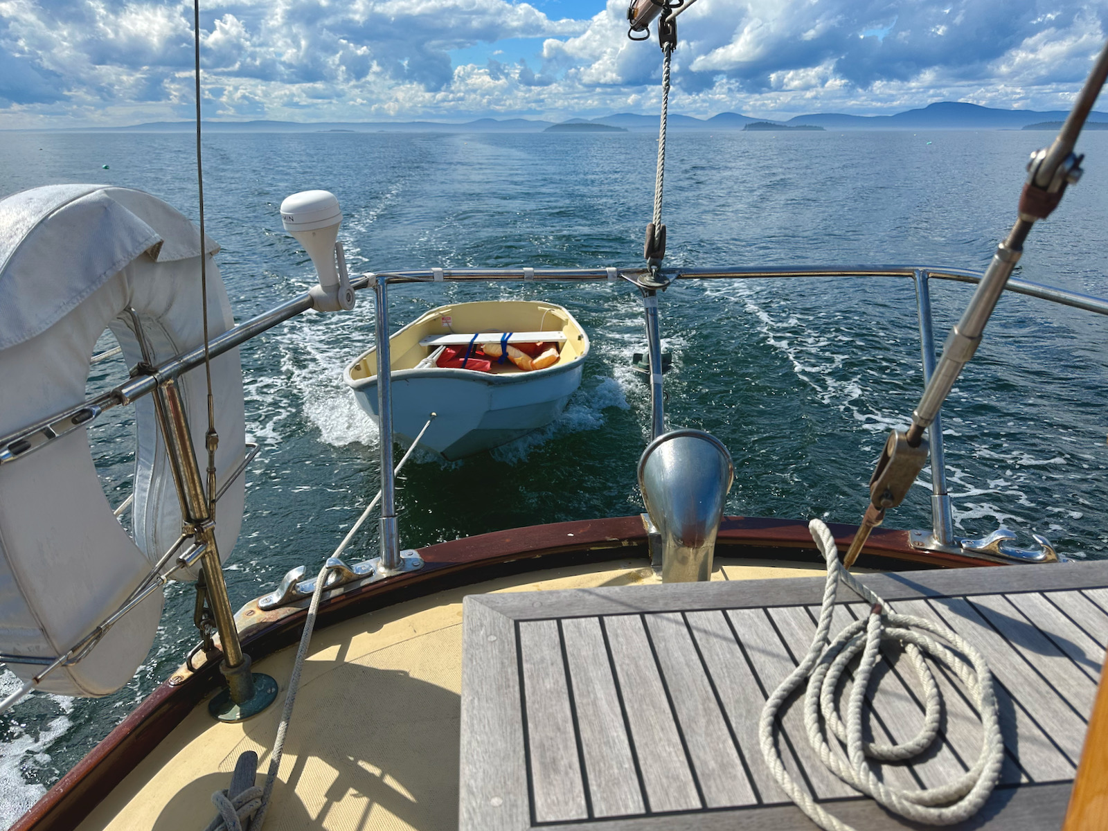

I've built a Sipo mahogany top on a deck box. It's sort of a test to see how it holds up. So far it appears to be a good decking material
BTW, no screws are left in anywhere in my work. All are removed after epoxy dries and full depth plugs are inserted with epoxy
