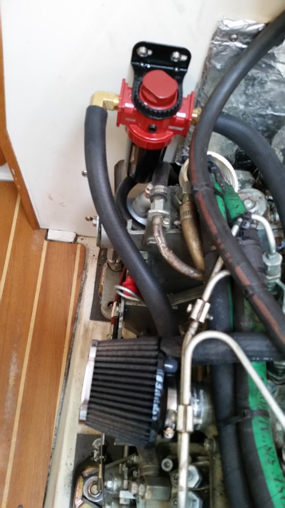

I still have my breather hose attached to my K&N but in between I added a fuel/water separator. I do not get the oil build up on my air filter and my crankcase is ventilated.
May 20, 2016
3,015
K&N even sells an adapter to connect a breather hose to the filter, I also have an oil separator on the hose to prevent an oily filter.
