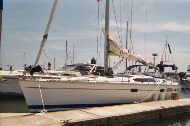

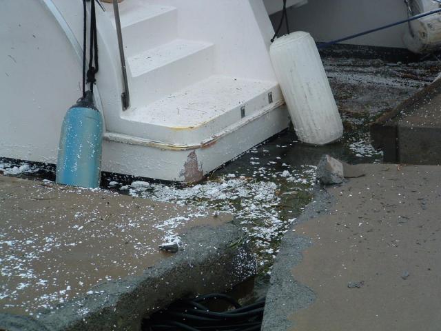

Floating docks are the norm here. Here's a couple of photos that indicate their durability in our conditions. The first is in Mexico, 25 year-old Bellingham docks in an area with a nasty surge. Could use some maintenance, but holding up well. The second is in Marina del Rey. Bellingham also, but 50 years old; should be replaced sometime soon, but did well. The third is in my current marina, five year old concrete docks. Having been on wood docks for 34 years and concrete for four and on a marina board, I'll take concrete.

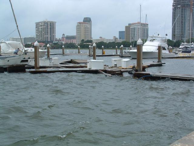

I've lived on each type during the past ten years. I loved the concrete floaters. But I can assure you that they don't have to float off the top to be a problem. Just ask the folks at the Vinoy in St. Pete.
I live on concrete fixed now. Although I like them fine I harbor no illusions about what would happen if Anthem got up on them in a storm.
