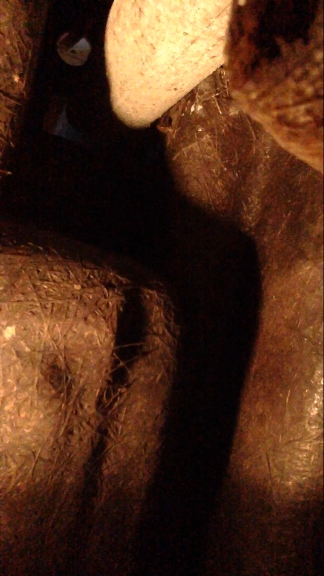

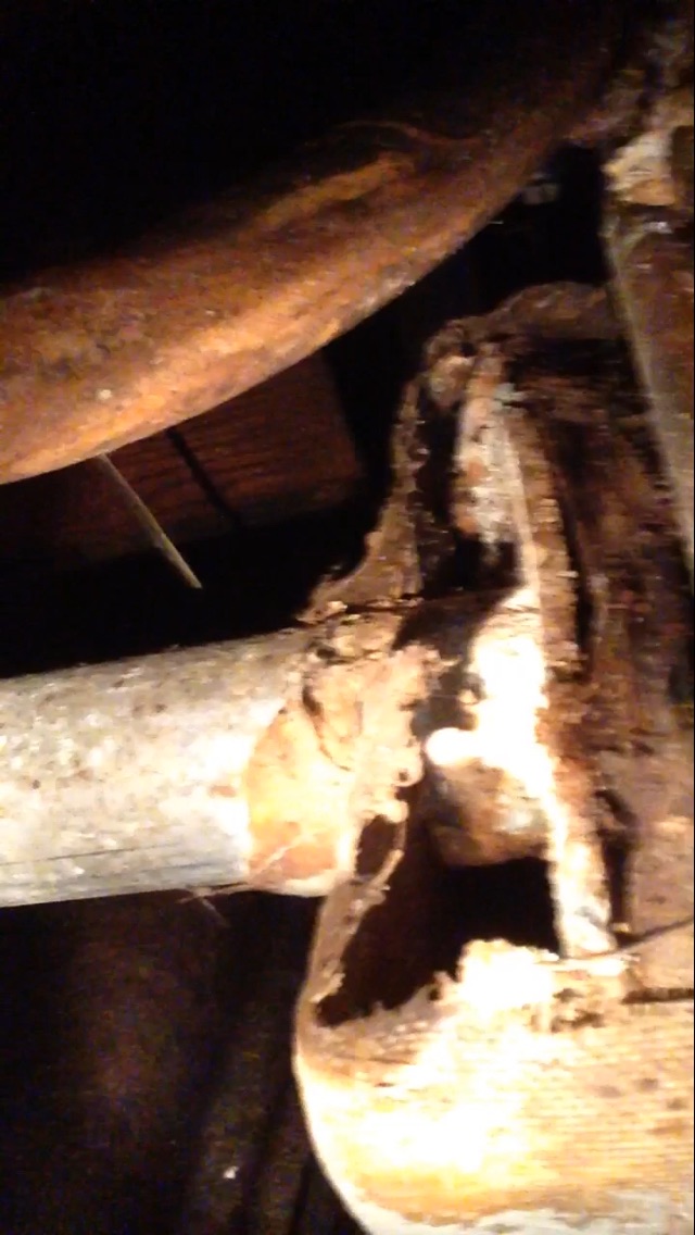

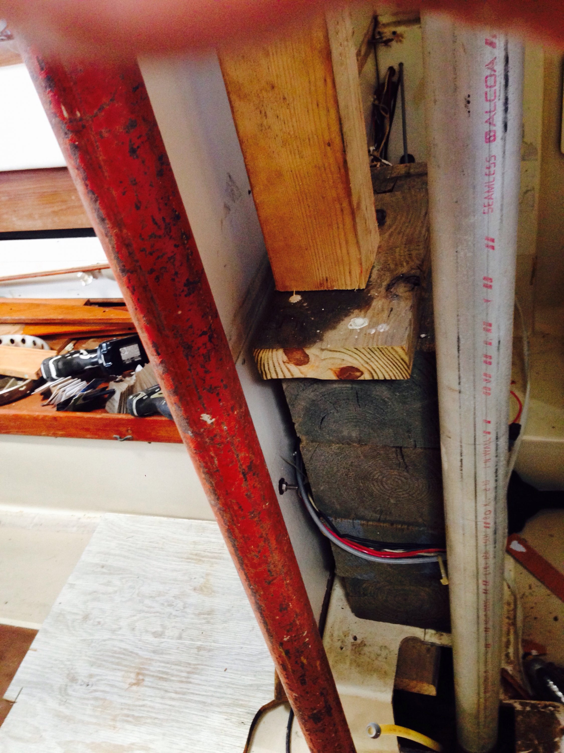

Hi! I own a P35 1977 hull #367. I inspected the compression post and block and by the looks of the pictures, I have aluminum corrosion at the base- see picture- and a partially compressed block. This weekend I will inspect the step, but that seems solid.
I need advise on how to remove the compression post on a Pearson 35. My plan is to removed the bulk heads, because I see no other way to remove the compression post. I think it comes out aft. I was remodeling so one its out of the way with 4x4 support on the forward cabin .
I plan to loosen the rigging and raising the cabin carefully from below with structural support.
I was also wondering if the aluminum post could be fixed without removing it by cutting the base and attaching a new one.
Your advise will be appreciated.
Thanks,

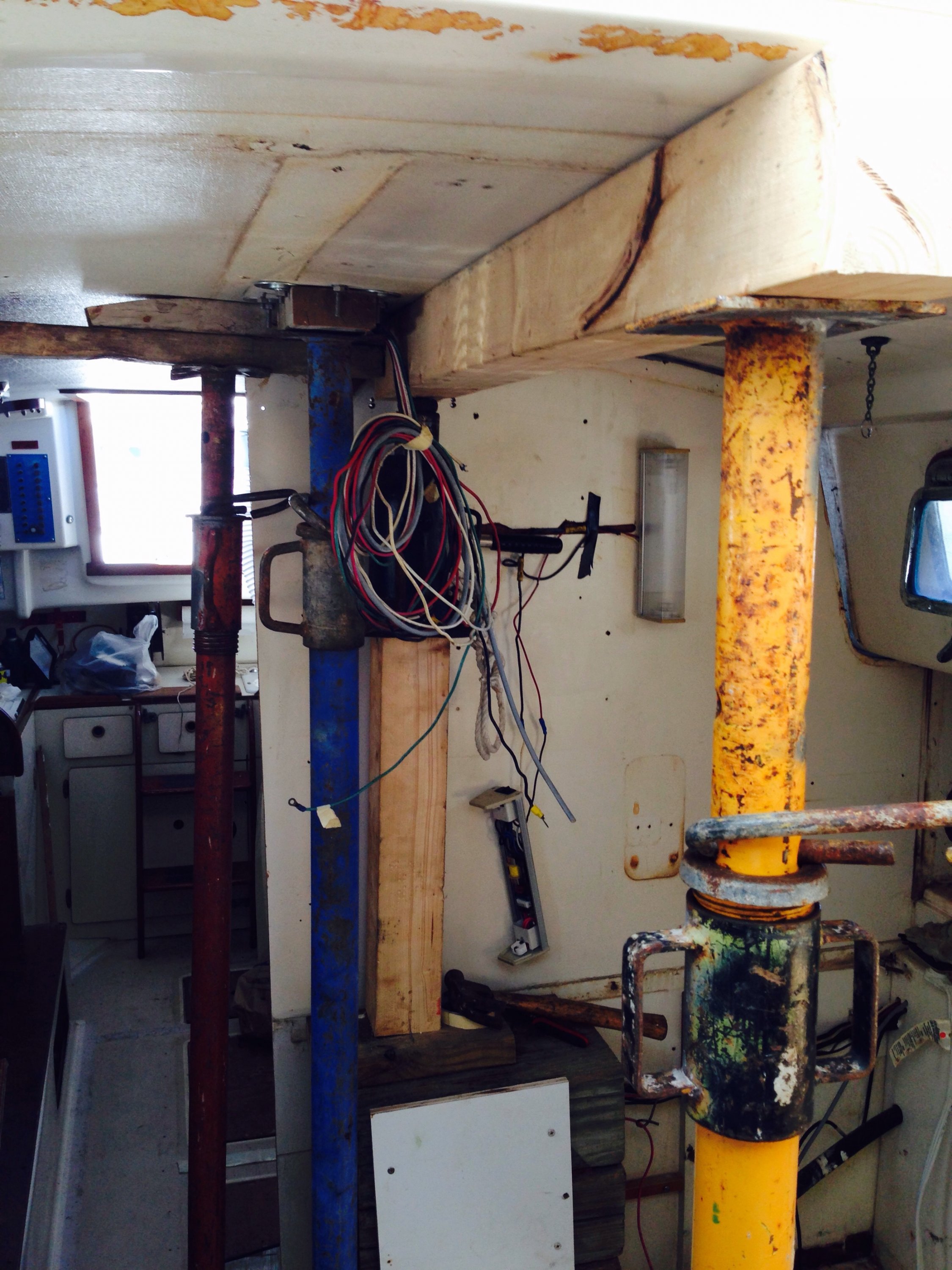

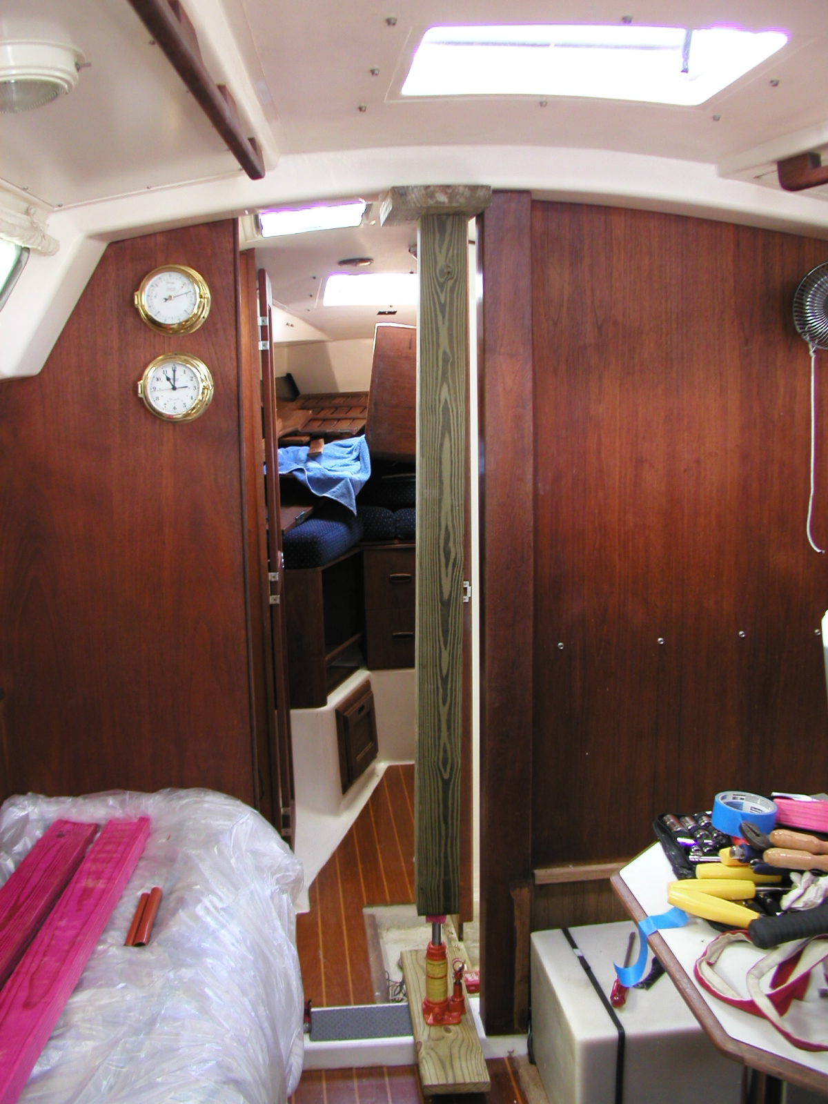

On my boat, once the rigging was really loose, it was easy to gently jack the deck the inch or so that was necessary to remove the post and do the work.. Jack to install post.JPG

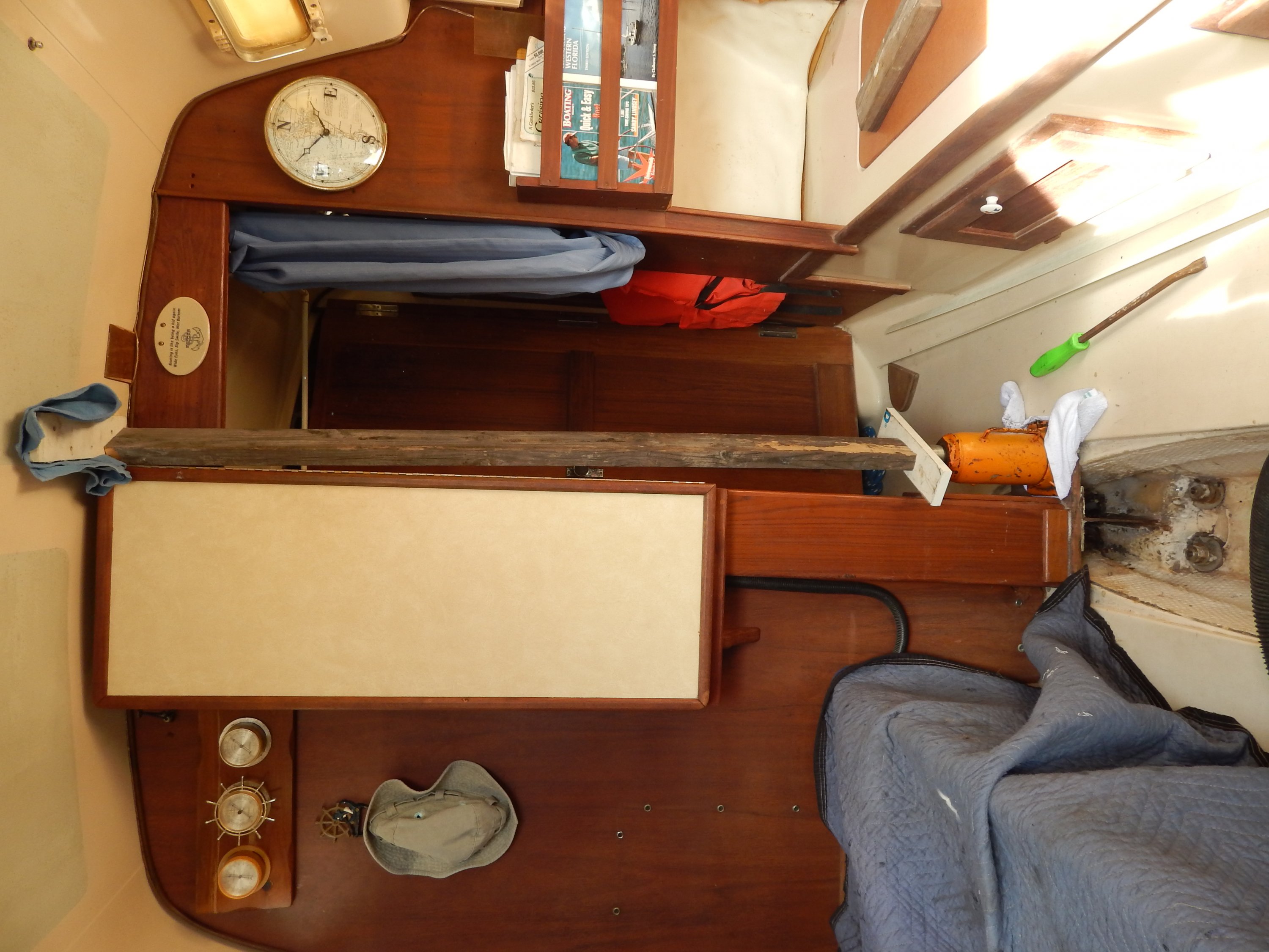

That's exactly how we did it on Fraulein II last month to remove the I-beam. Sorry pic is sideways.

Thanks for your advice. For those Pearson 35 owners I will share this project.

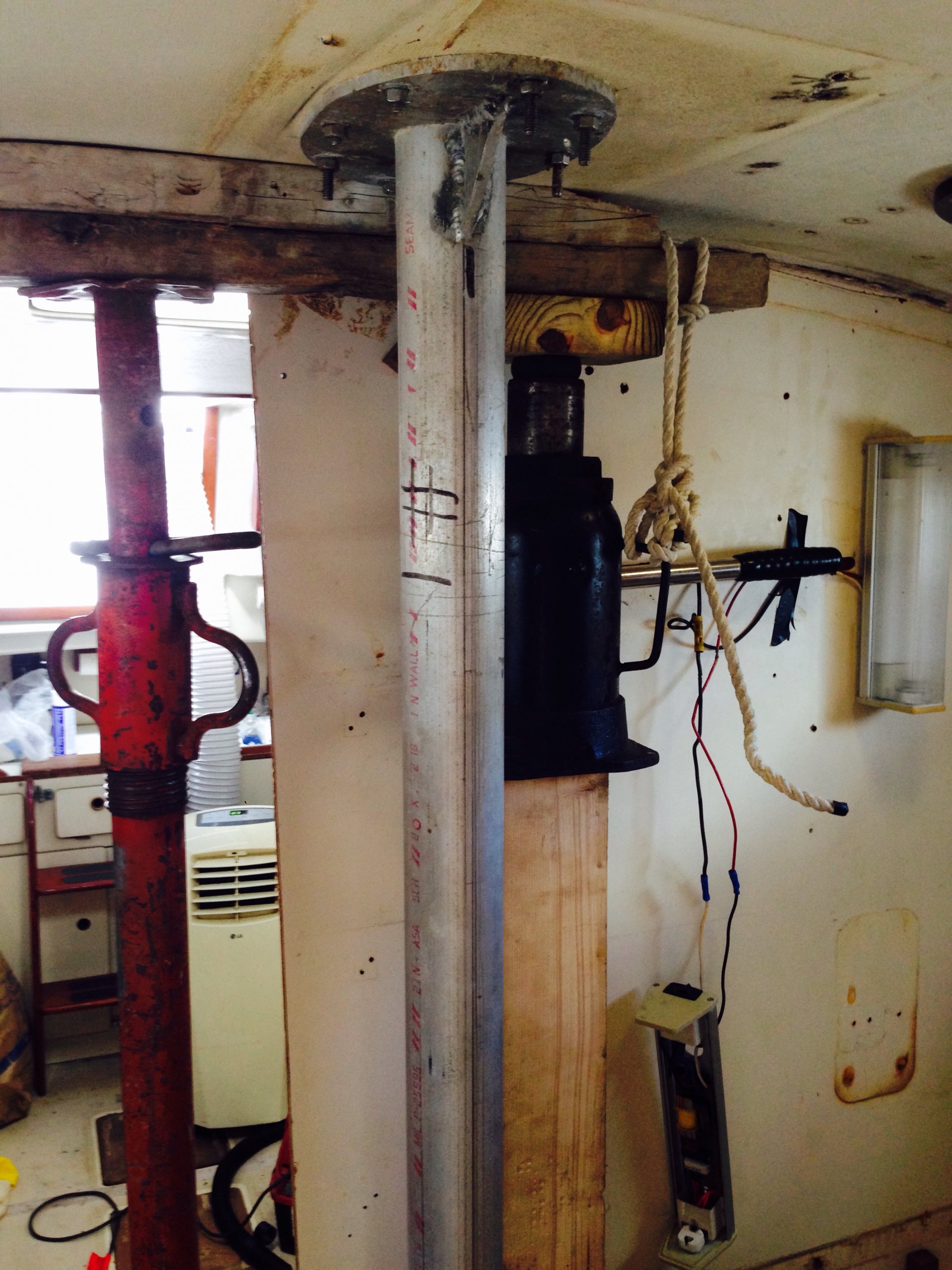

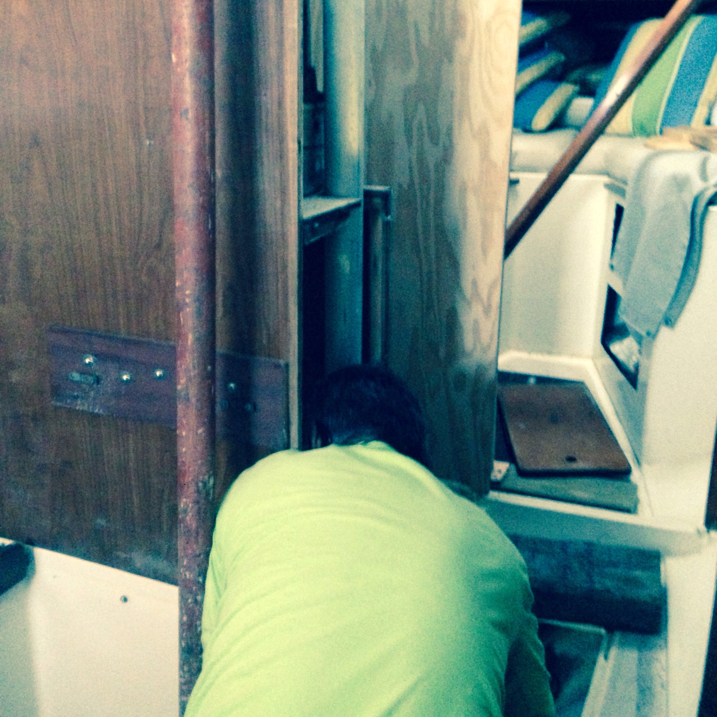

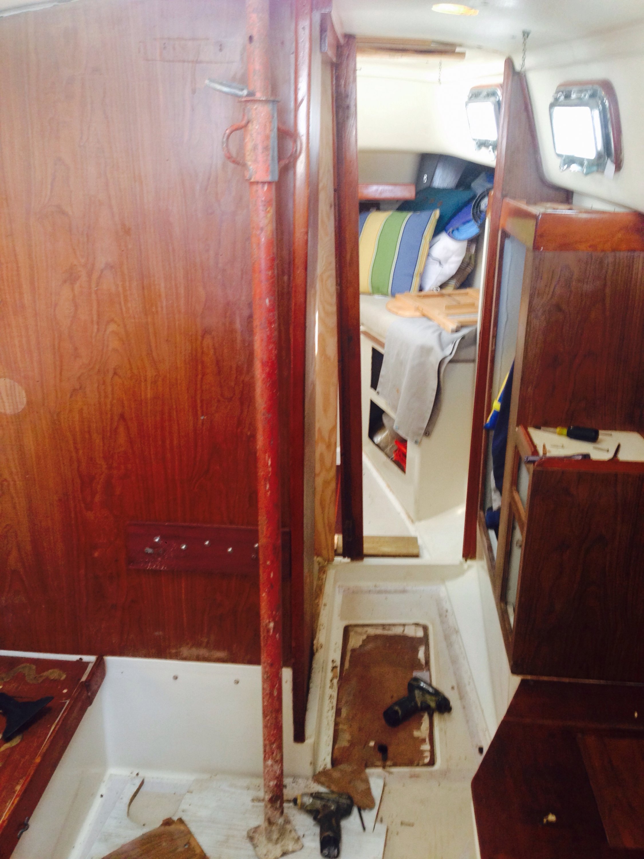

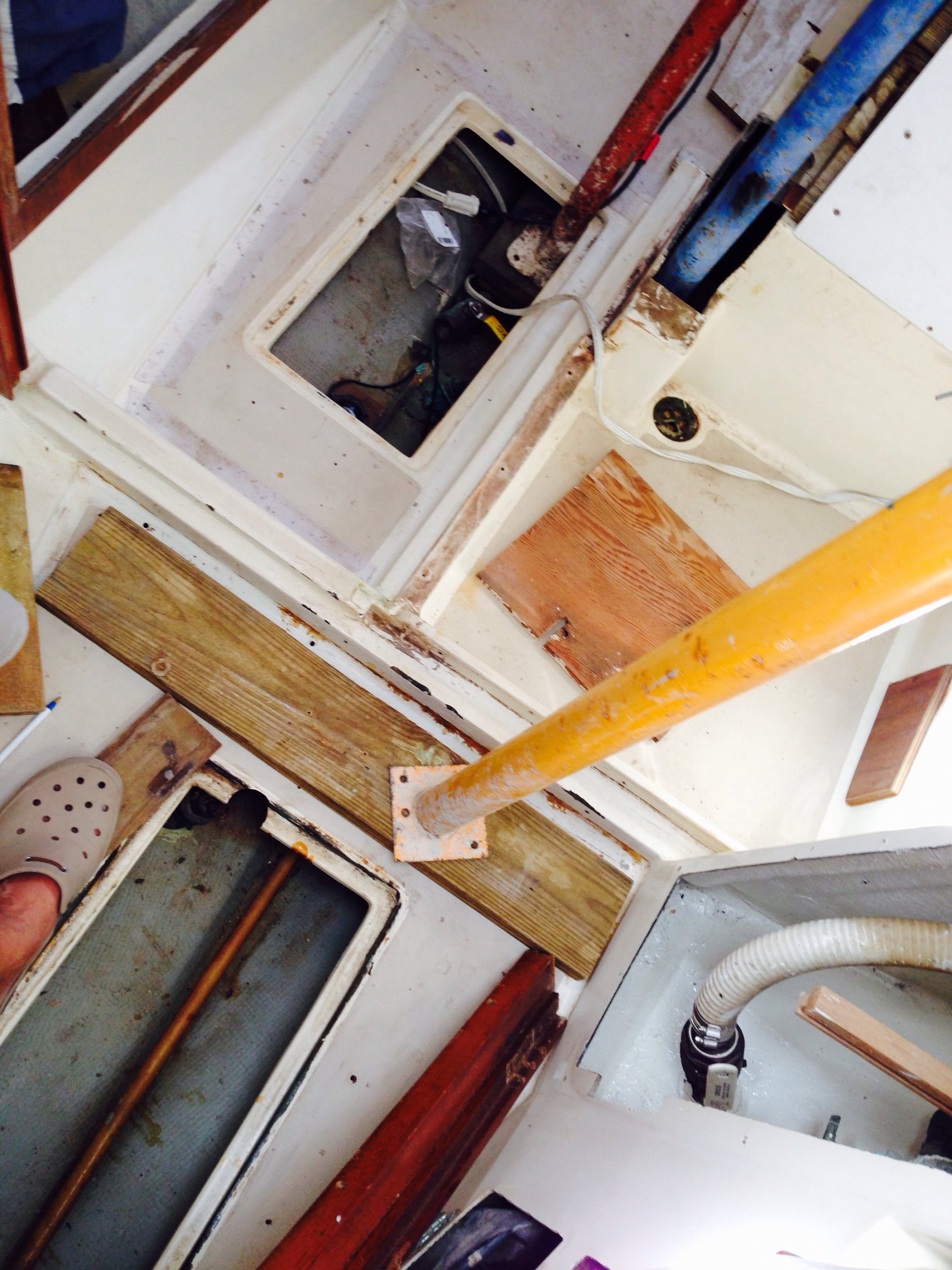

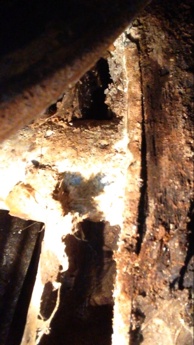

To get the compression post out is difficult. I removed the head cabinetry, door, the forward bulkhead and the side wall. Then I cut trough the fiberglass moderately to be able to see the base of the post. As suspected it is compromised and bent. Then I cut through the fiberglass base to free the post and the block.
I have not removed the post yet and not until they are ready to work on it at the shop.
Here are some picks.

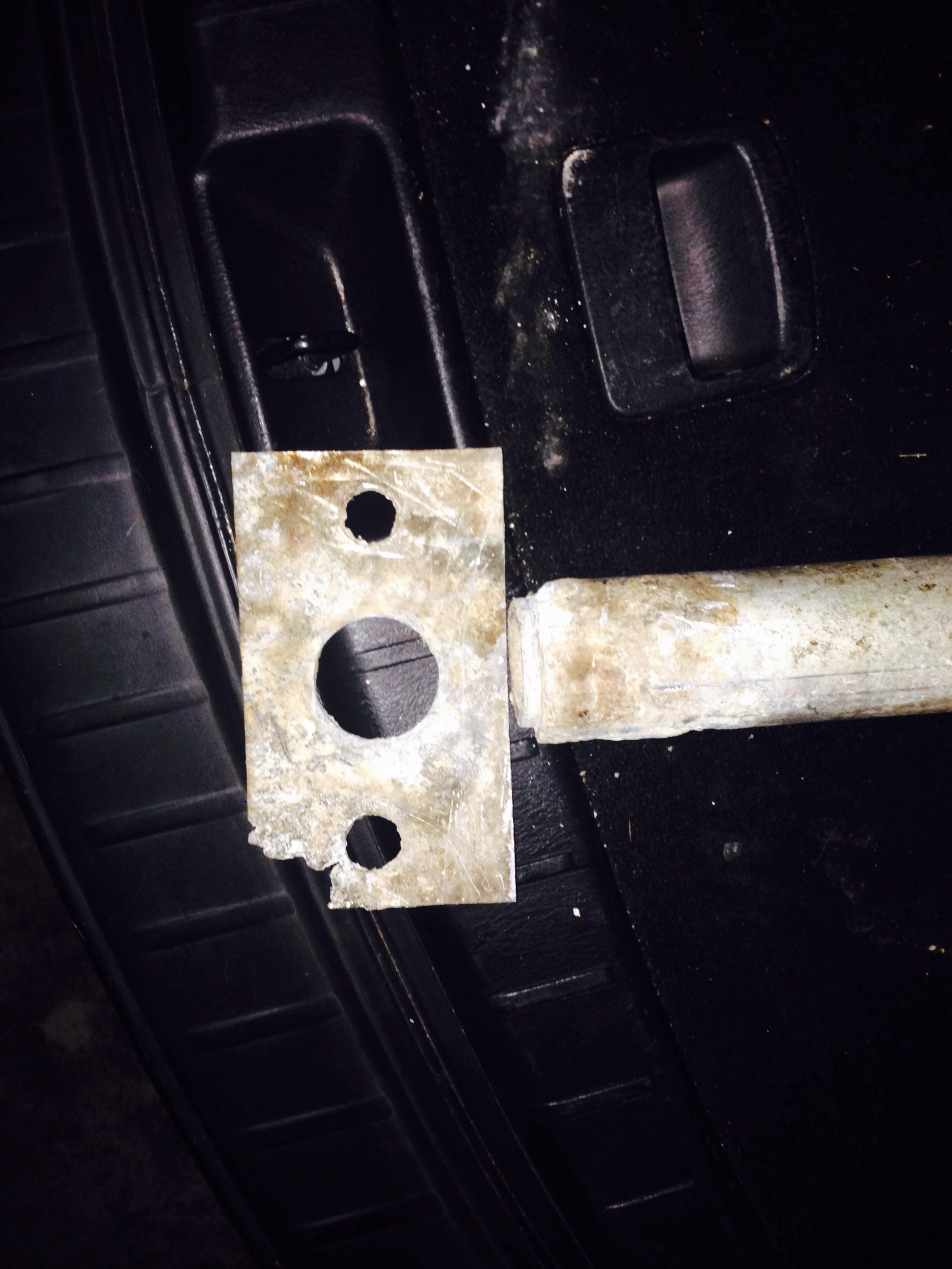

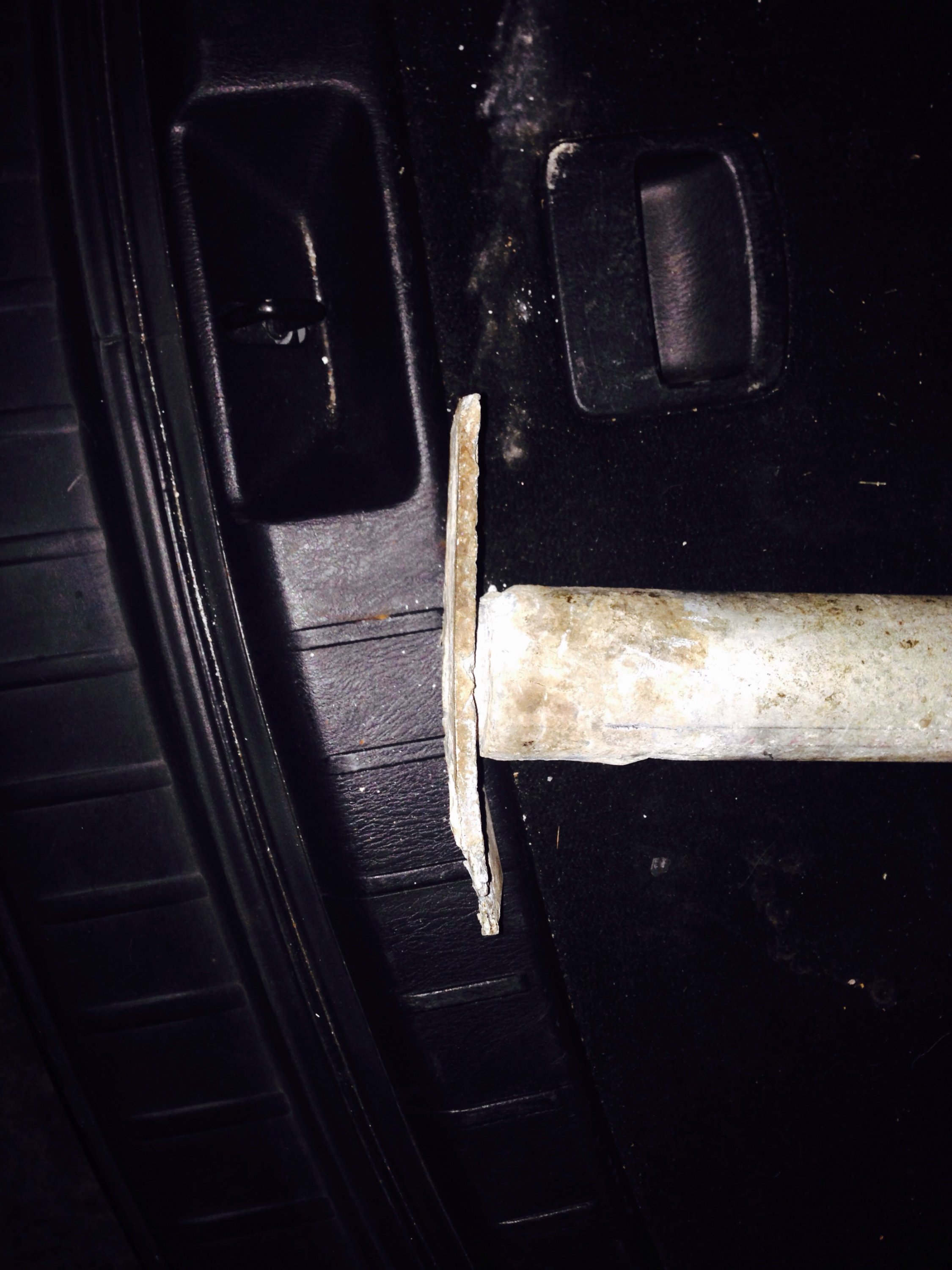

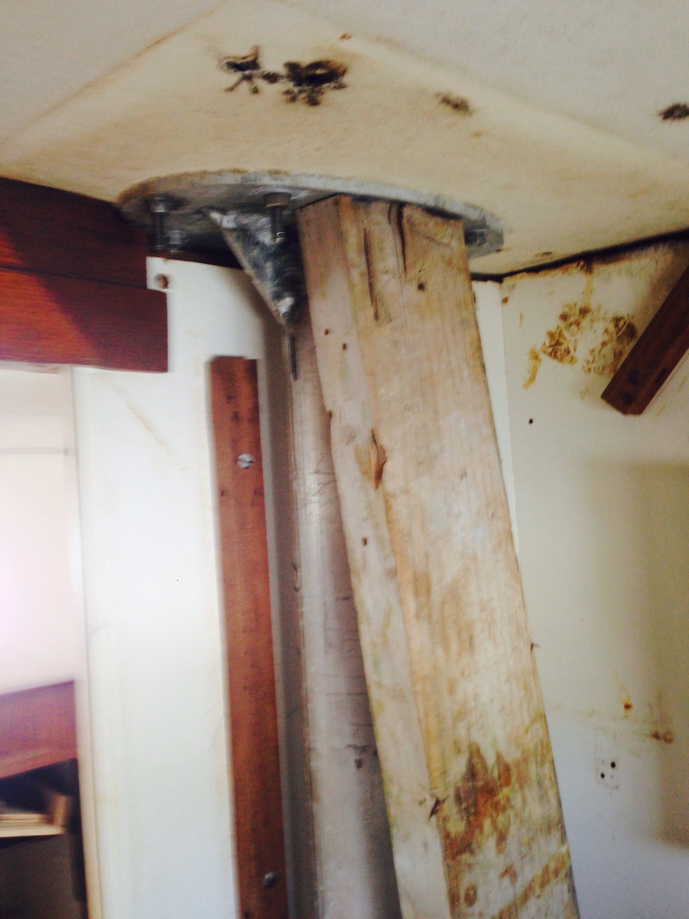

Thanks. When I remove the screws from the post , I will have a better idea of the condition of the deck mast step.
Going back to your suggestion of removing the mast , now that I have clarified that I have a step mast and if the step is solid, would you remove the mast anyway?

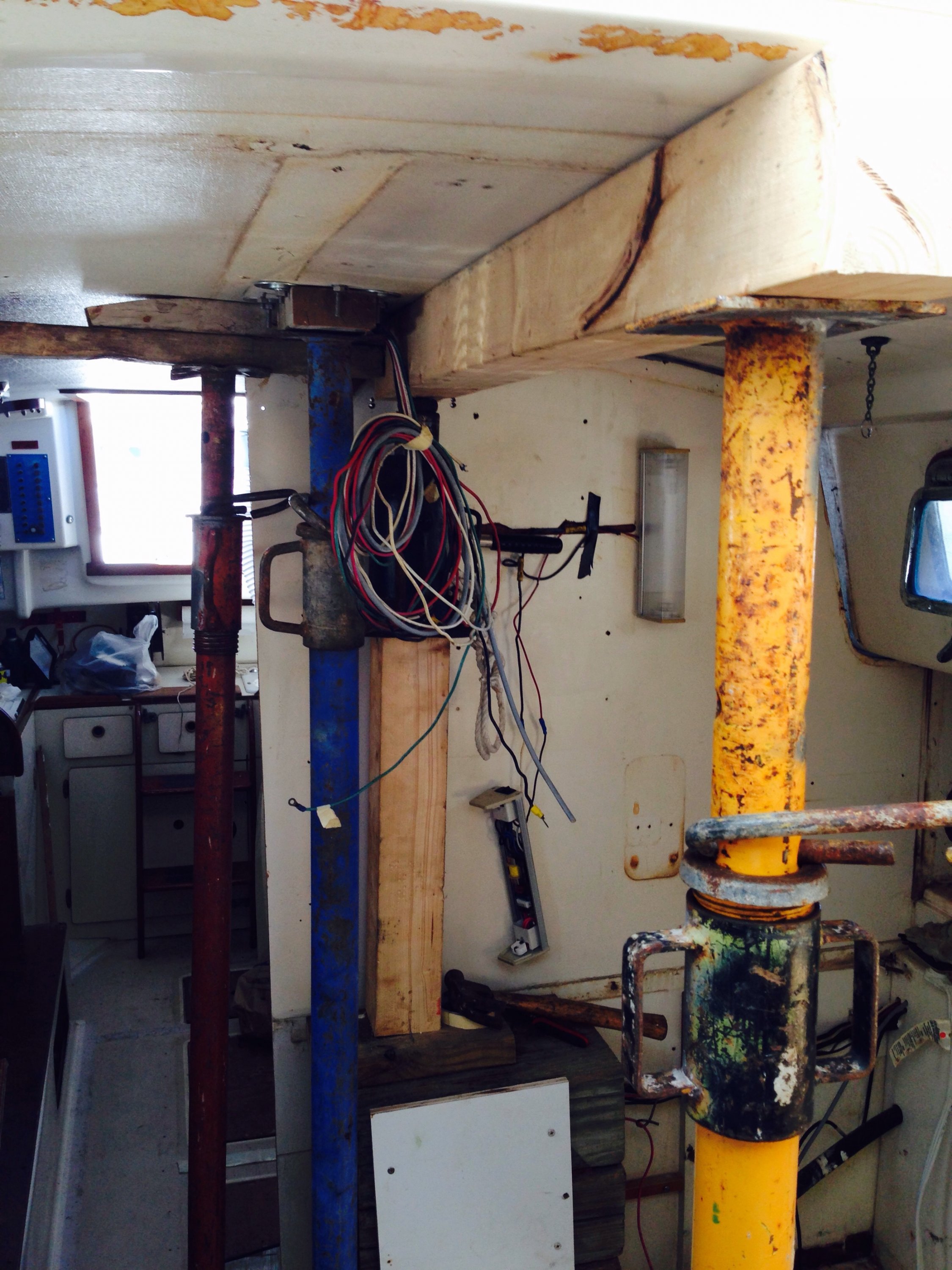

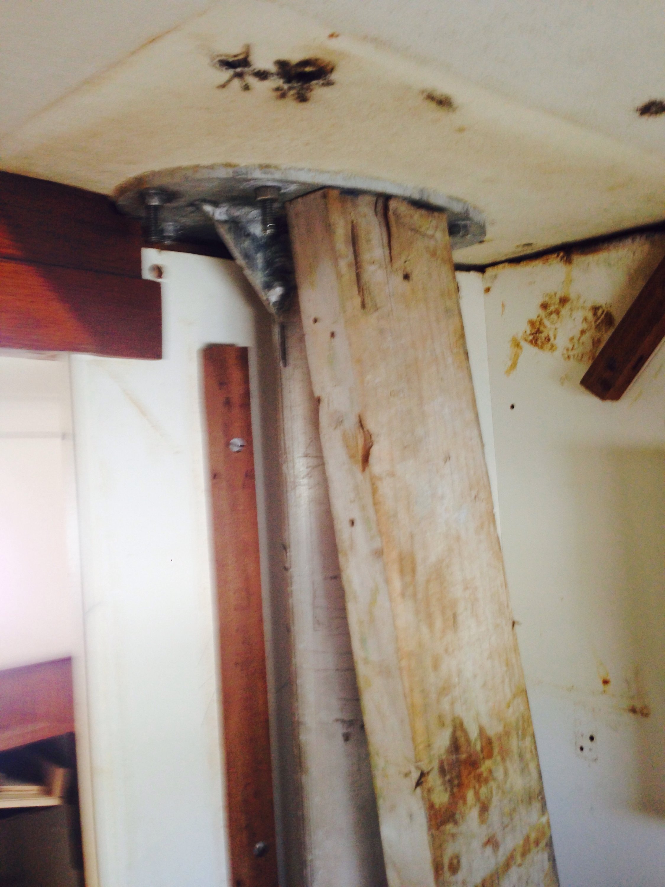

I include a picture that shows the post attached to the cabin top.

Since you have a deck stepped mast, it seems to me that the safest way to accomplish this task is to take down the mast. Isn't the mast base plate somehow attached to the top of the compression post through the cabin top anyway? If you loosen the rig then detach the compression post there would be the potential for the mast base to slip, and in the worst case kick out and drop the entire rig.
May 12, 2004
1,505
That is true, Doug. If I were to remove the compression post, I would definitely remove the mast. We did that on Fraulein II in 2001. This time we only replaced the I-beam so just loosened the rig and braced the deck. If done this way, take all sails off to lighten the rig.

I've been guessing from observation that the mast is not attached to the post. I'm quite sure the mast is attach to a separate piece inserted into the deck that receives the mast. I also have a stainless steel piece that surrounds the mast that may be providing some support , which is design to attach blocks and the downhaul. I will check on this fact to assess risks. If I dont remove the mast- which I will definitely plan for it-, I could Secure the mast using the main haliyard from the sailboat next to me and secure the mast from below tying 4 ropes in opposite directions to the stanchions base Thanks for your contribution.
Note: I'm not allowed to remove the mast in the marina and the nearest yard is 4 hours downwind. I could do it in the bay with the aid of another sail boat, but.... I'll see.

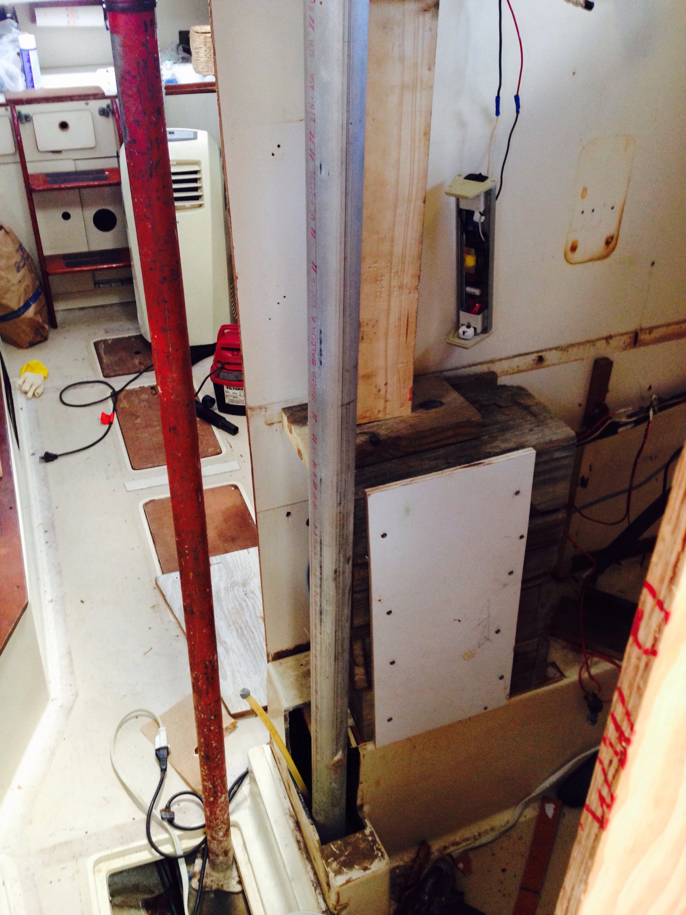

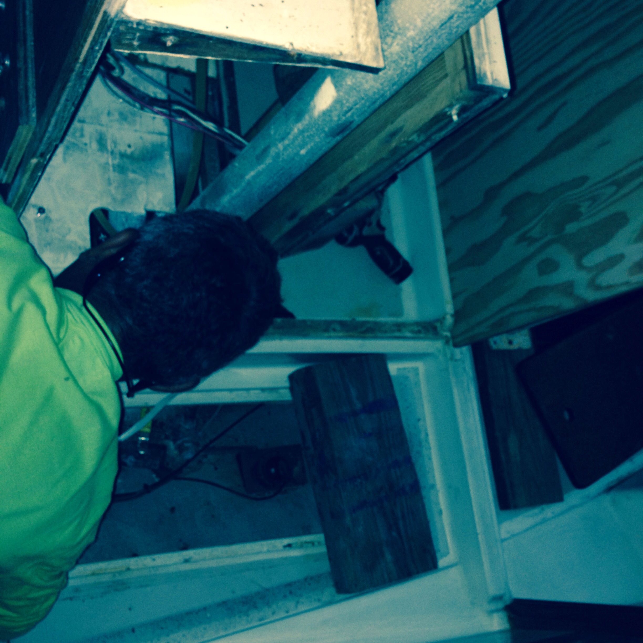

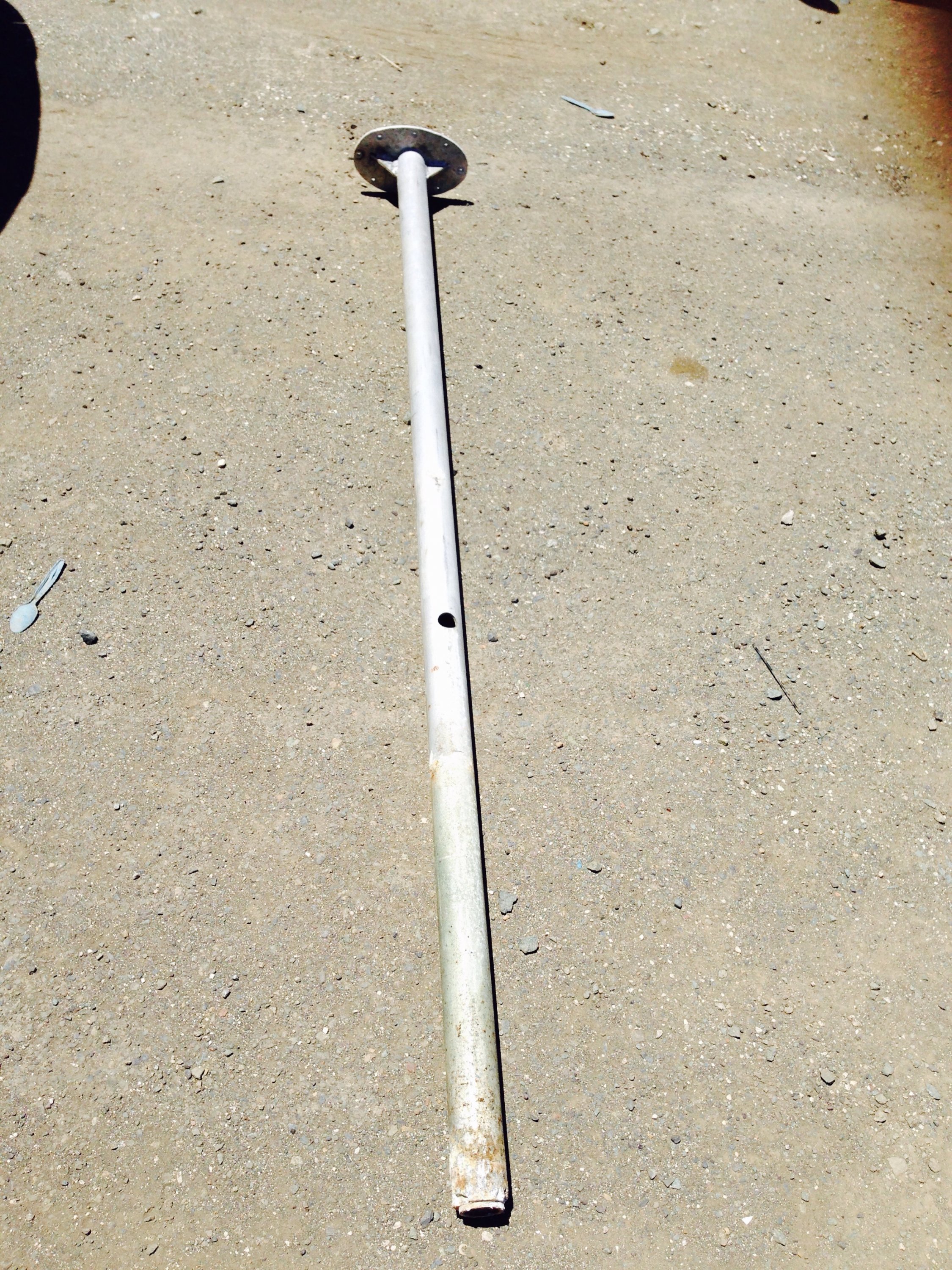

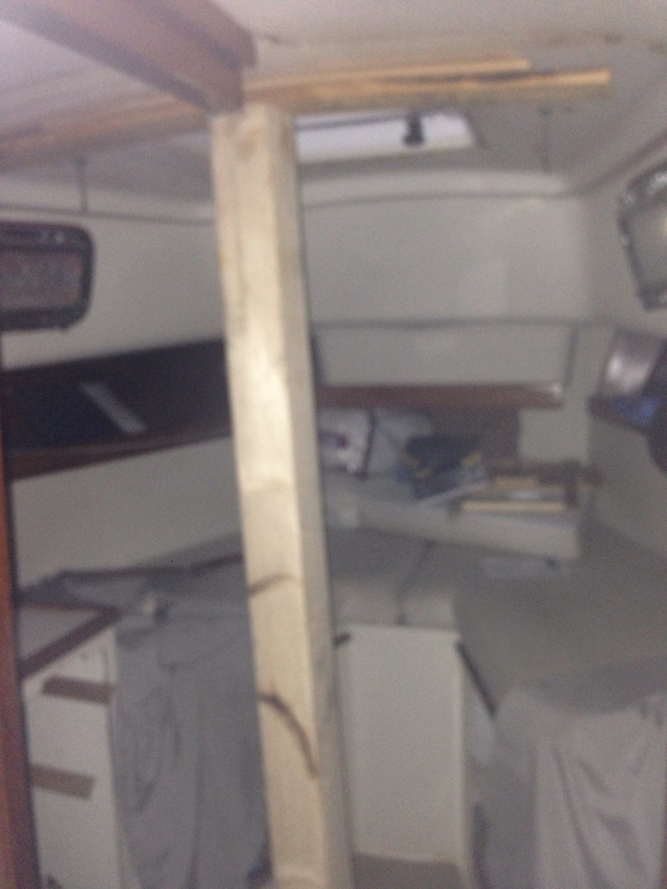

Update: Not having the facilities to remove the mast where I'm at, I took into considerations all comments and deviced an approach to manage mentioned risks. I raised the cabin and removed the post without removing the mast. I will publish the job in detail. I include some pictures preliminarily.
